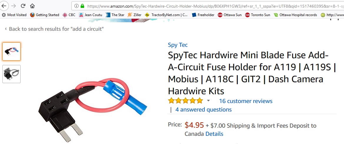

Consider the "Add a Circuit' device to add a new circuit to your existing fuse box.
You remove a fuse, plug in the adaptor, insert your original fuse in a specific place in the adapter, connect your new wiring to the adapter and add desired sized fuse in its special place in the adapter.
Not for every job and not for every one but a simple solution for many jobs.

Consider the "Add a Circuit' device to add a new circuit to your existing fuse box. View attachment 46044 View attachment 46045
Dave
Thanks Dave. Wasn't aware of this adapter. Will make power supply much easier.
