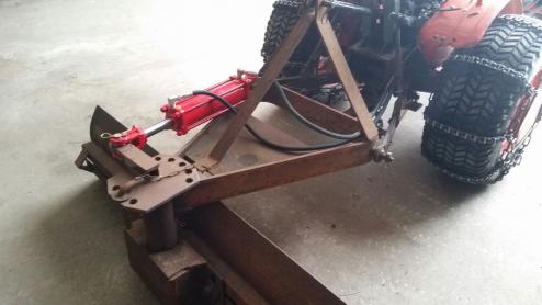

Added power angle to rear blade
Dwarner
B7610 HST, Woods 6500
Aug 3, 2012
114
Enfield, CT
With all the snow this season I got tired of getting on and off my B7100 to angle the rear blade. The blade is only used to scrape the driveway clean. The ram is a 3 x 10 from tractor supply. The 3/8 hoses and fittings are from surplus center. The ram is plumbed into my loader curl / dump valve. I cut down an extra 3 point lift arm to make the mounts. Gave it a test run today and it did work fine.
The B2650 snow blower does most of the work.

nice set up for snow removal

Very nice. Makes me want to add a rotating cylinder (I hope that is the correct term) to my rear blade.
