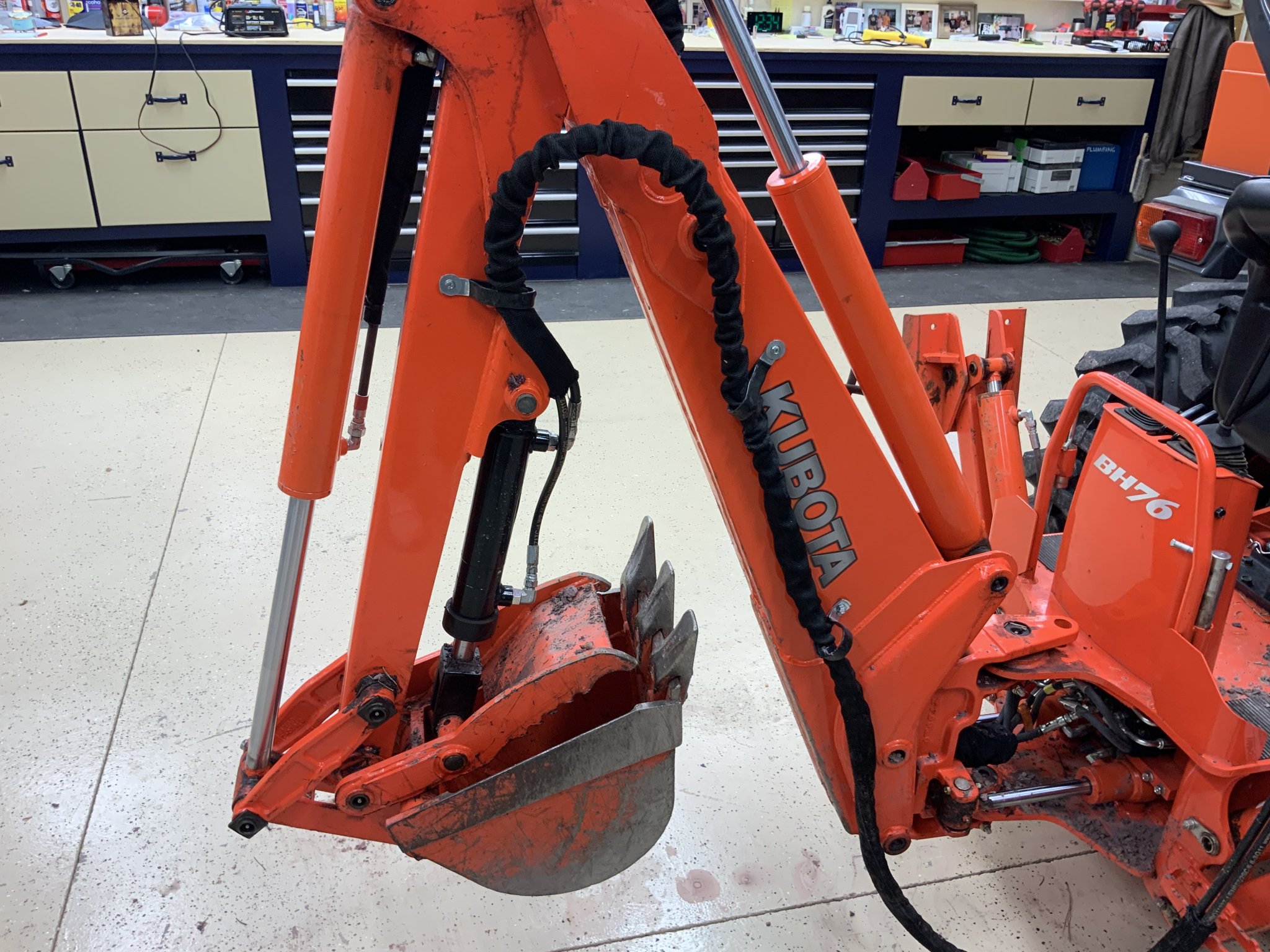

Do it OP!
The best thing I have on the tractor as I am in a rock infested part of the world. Added a valve to the plumbing and has worked great for 15 plus years. My lines are carefully routed/hung to avoid pinching and getting caught. Looks lame but works for me. IMG_1417.jpeg
