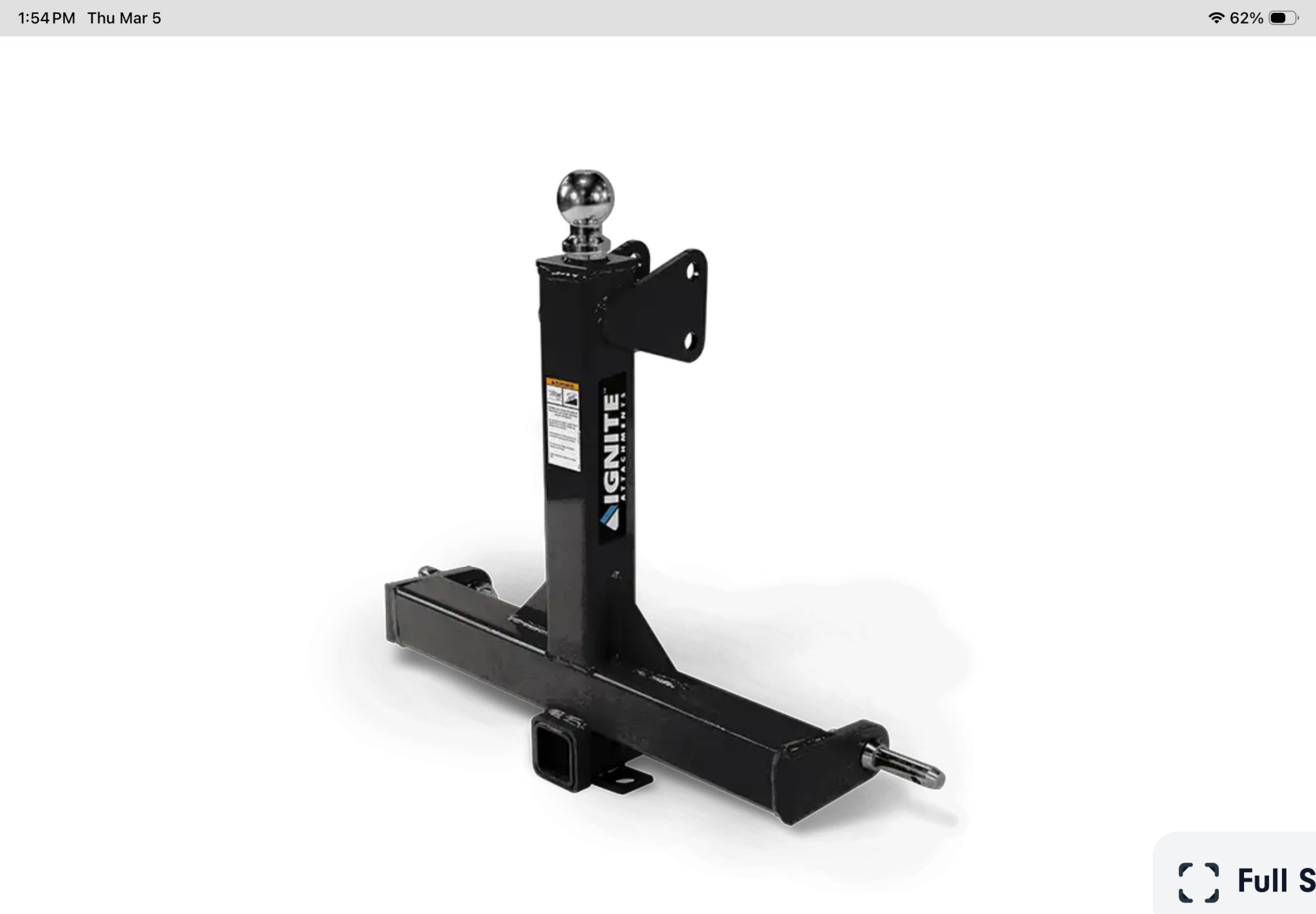

Buy something similar to this and weld it into place. Or just weld on some metal structure to lower what you have. Post pictures of the implements and you will probably get more suggestions.

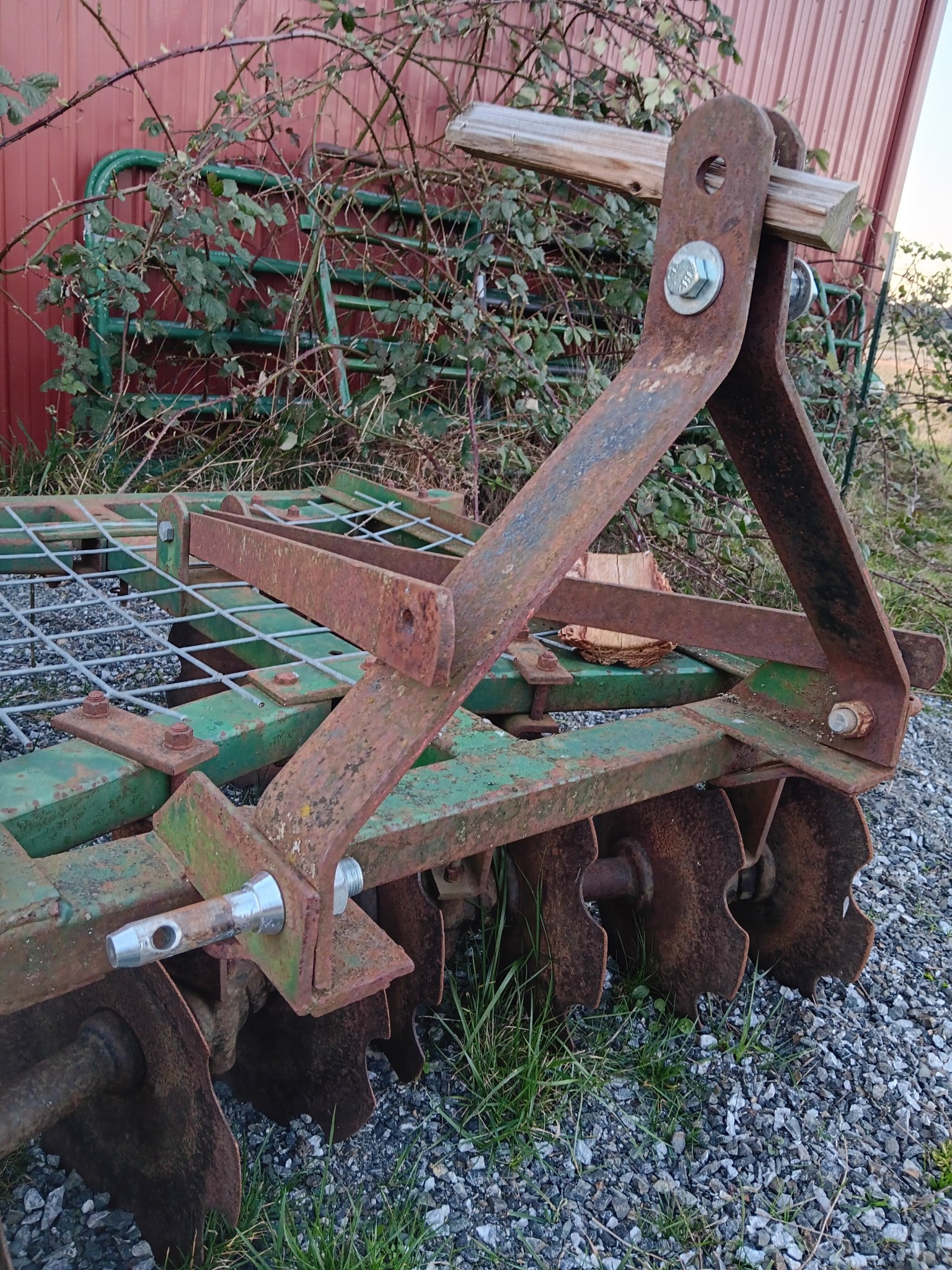

Here's a picture of my old harrow. My old tedder is similar and the old tiller i'm borrowing is also similar. Specifically, the tiller is not mine to weld...

Whats too high about that disc? I have something similar and it works fine on my L3901.
The three pins would be much better if they were all 4-6 inches closer to the ground. For example my modern box blade's lower pins are about 15 inches off the ground. The lower pins on these older implements range fro5- 12 inches higher. I can barely get these implements off the ground for transport before my lower pins are at the very top of their range. I have an intuition that whenever possible we should run stuff in the middle of their operating ranges.
12,944
7,342
Shorten the side links. I am pretty sure my L3901 would have no problem with that disc.

The OP could buy and modify a Quick Hitch to have a more desirable offset .... maybe.

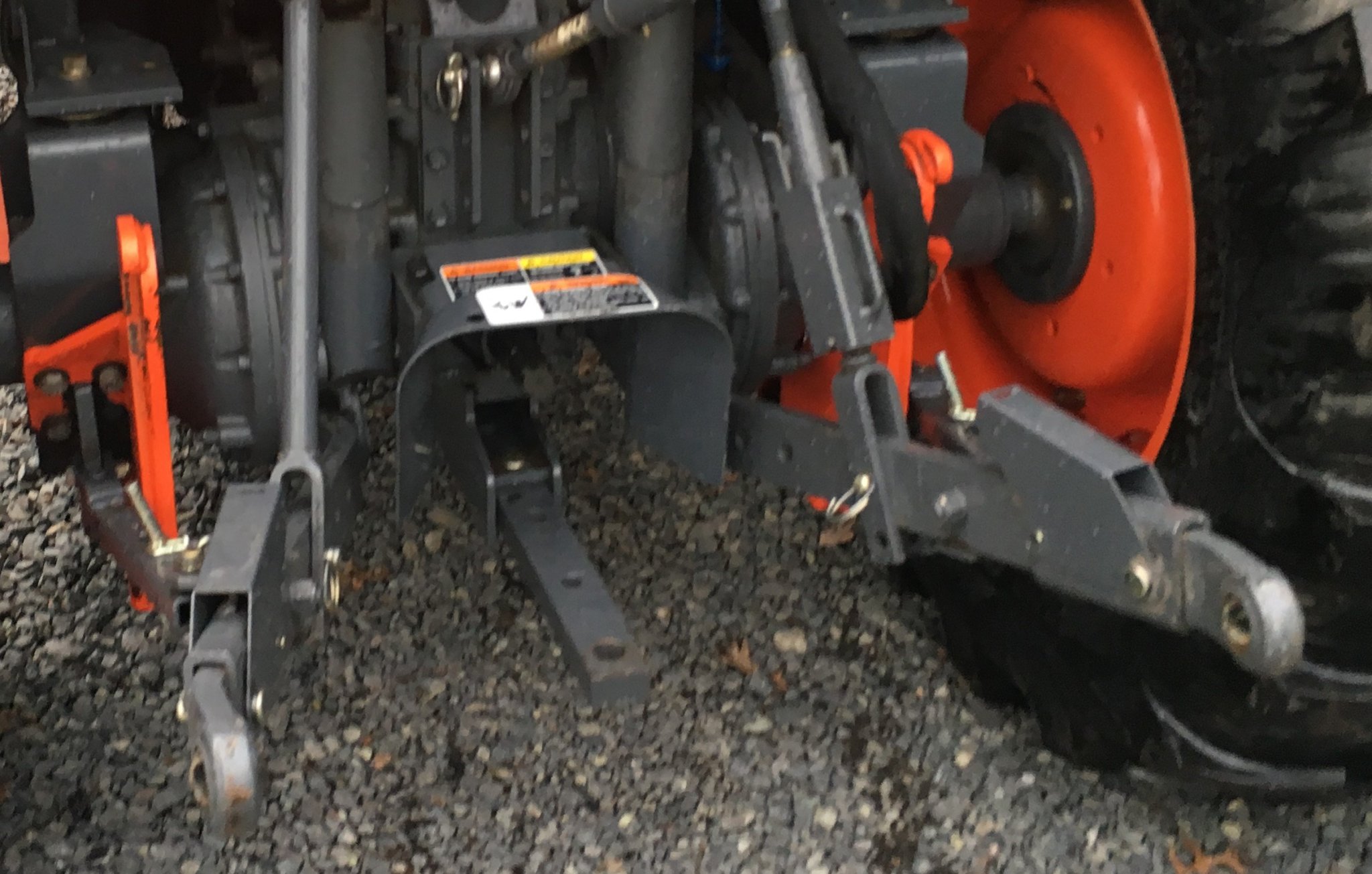

I've never had a reason to fiddle with the lift arms on the L4240, but in addition to lower holes in the lower end of the lifting rods, the lift arms have holes closer to the tractor that would seem to provide lower position(s) at the implement end.
Maybe that's not even why the holes in the arms are there? I'm assuming there would be less lifting capability if they were used because of the leverage the implement would have.
That’s exactly what I was referring to in my previous post. It’s doubtful that reduced lifting capacity would be an issue. very few implements come close in weight to the maximum 3ph capacity.
