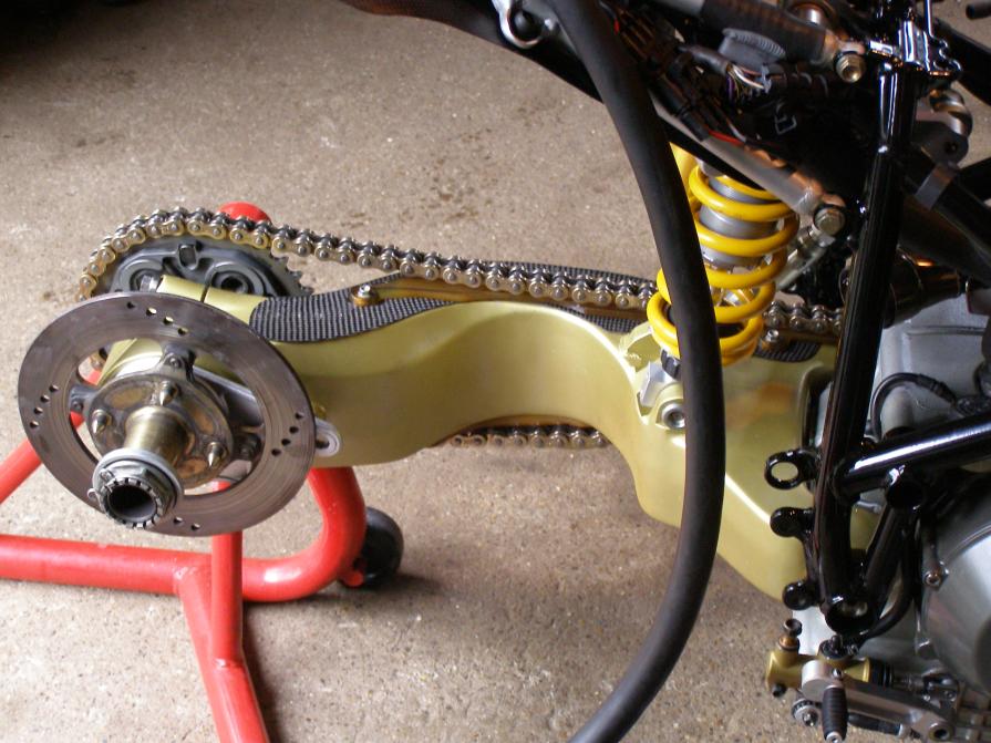

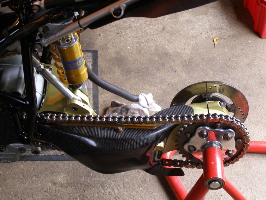

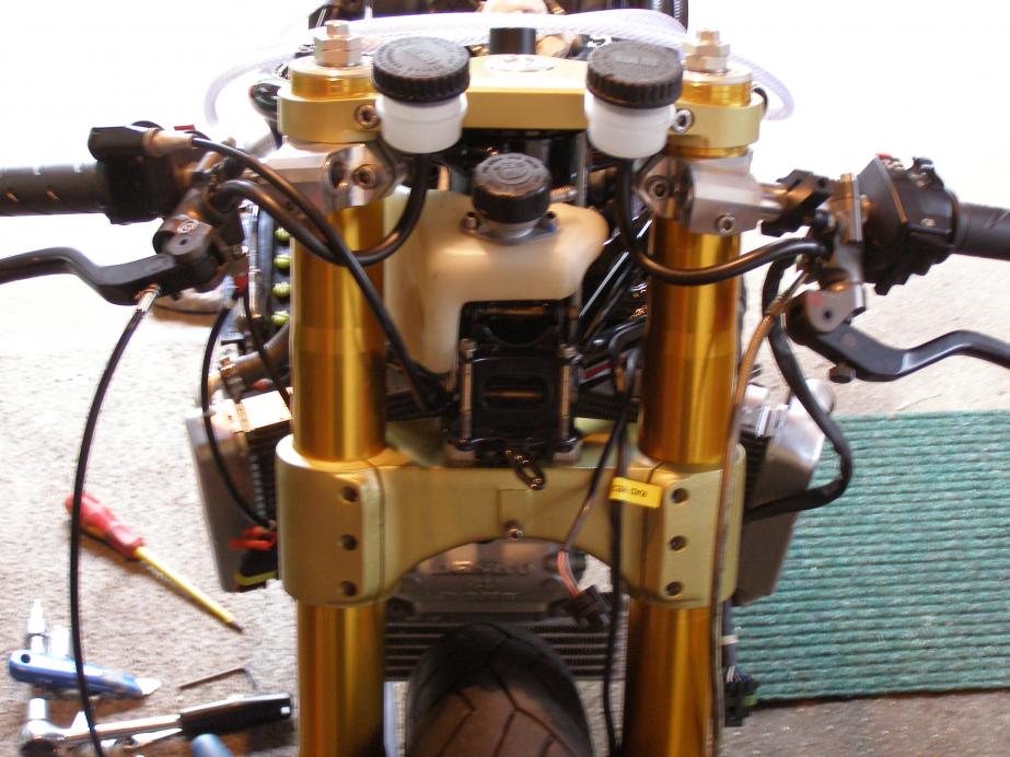

thanks for the replies guys, currently looking into the options that you have all recommeded, Except skeets suggestion of retiring her:eek:, just cant do it sir, the years maybe ticking by but this bike is just so special :cool: and i could never find a replacement to be honest:(, let alone the cost now.:eek:
I have attached several pics of 2 of the offending parts, swinging arm and fork yokes.
they look to be fine from a visual check but i need to be 100% now just in case of a high speed off.
these mag arms if you could find a good used one that is will cost in excess of $2500 alone, thats just the bare arm without the racing hub and all other parts that go with the arm....
