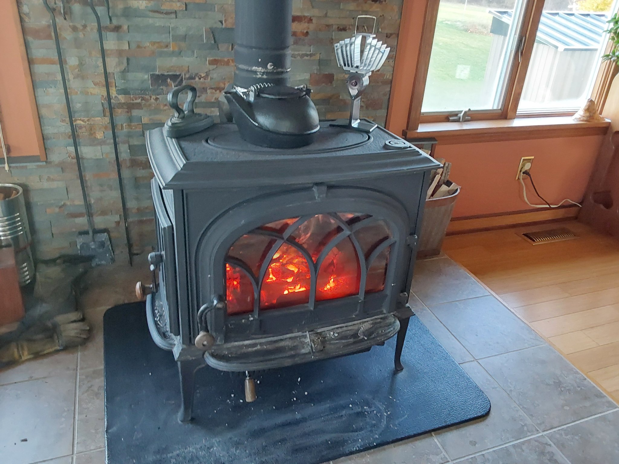

We bought a Jotul Oslo 500 about 12 years ago and love it. Has heated our house every winter since without a problem other then gasket replacement on the doors. It also has the reburner tubes that keep the chimney clean and raise efficiency. Nothing like wood heat if your house layout allows for it.
side door is a nice feature...
Mine has a top feed.... rarely use it though.
They give you a SS cooking tray to place inside to cook burgers...
I thought it was a novelty thing but it actually works pretty darn good for flame broiled burgers.
smoke goes right up the pipe.... pretty cool.

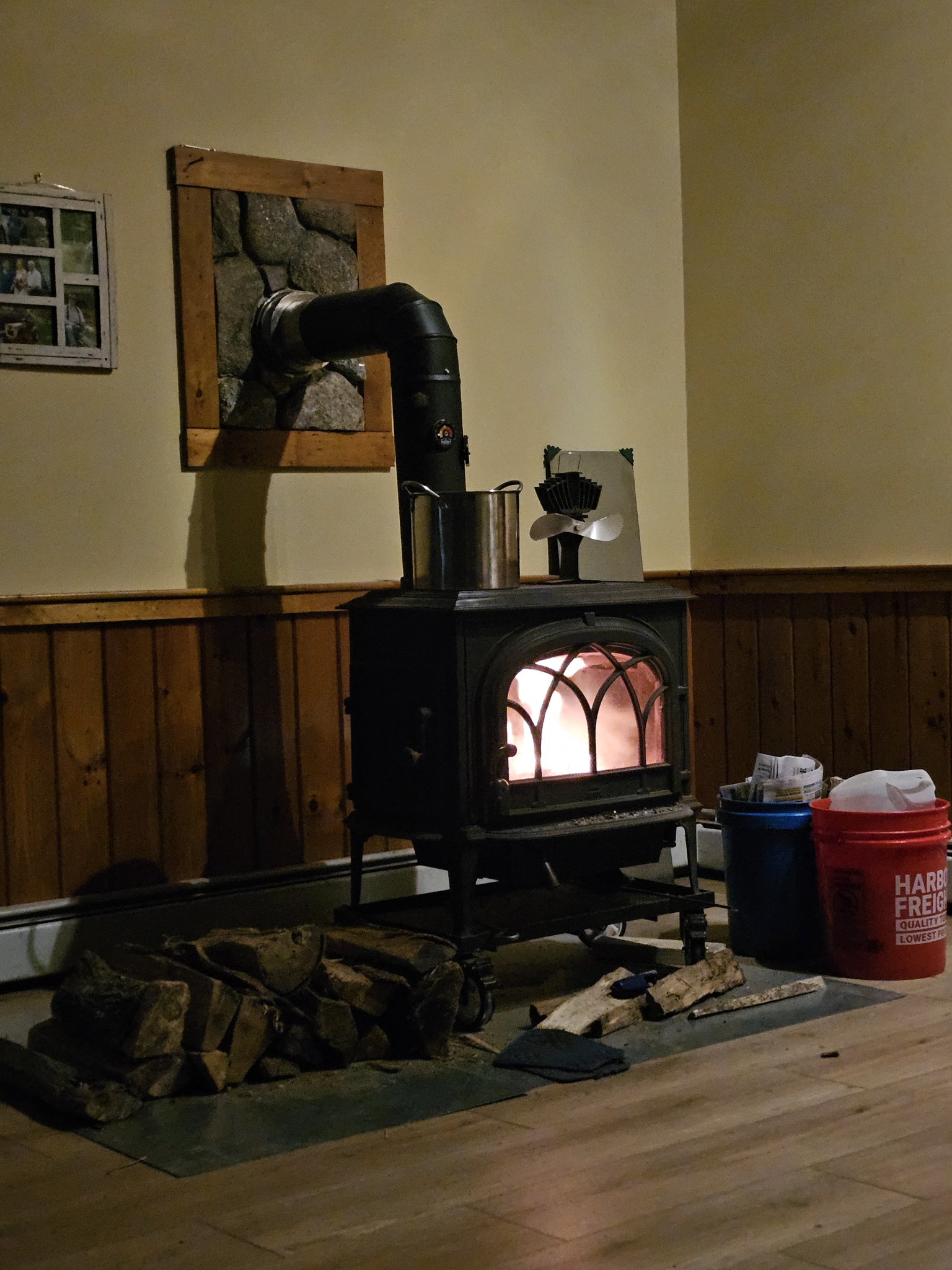

Going on vacation in Nova Scotia and traveling around up there. Any firewood was pine spruce hemlock fur. I saw no hardwood firewood in anyone's door yard.
I saw several houses where firewood had been dumped, all cut and split. All fur. I know someone also who lives in Utah. He only has soft wood to burn. Nothing else available.
As far as woodstoves go. Jotul is fantastic. I bought a Oslo in 2000 (y2k , remember that ? Everything was good to collapse)
It was recommended by a customer of mine who had the biggest jotul woodstove that had two front doors. I dont remember the model. Its been fantastic. I clean it every fall and every jan 1st. Take the pipe down. Clean the flue. It has a piece of 1/2" ceramic blanket on top of the shelf above the stainless tubes. I pull that down clean it off. Remove rear collar, stick the shop vac in and vacuum the top shelf off. Reach inside vacuum the tubes.
Ive never heard of a Rangley Jotul woodstove. And I've know people who have toured the Maine factor and only sheet metal propane inserts were made there. No USA casting is done for jotul. Thats all overseas. None the less. A good product.
