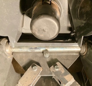

Replaced the factory toggle style "bar" with a set of sliding bars for easy quick adjustment. Decided I should finally do a test attachment and run of the 3pt snowblower now v. the first snowfall. The pto connecting shaft was cut by the dealer for use with the quick attach. The width of the stabilizer bars even with the shaft completely compressed prevented me from passing the shaft from the ground up to the pto at every possible angle. Requires attaching from the top. Even that was just possible at positioning the blower at one height position.
Was aware of the issue of the bar and plate just under the pto that can rub against the protective cover over the shaft "knuckle" if using these slide bar stabilizers. That I flipped over giving an additional inch.
Quick connecting shaft "hammock" to hold the shaft fully compressed and horizontal when attaching to tractor is my fix for now. Just ~1/2" too long. Cutting would be the proper fix. So... I'm assuming i cut just 1/2" of both the steel shaft and plastic cover?

Attached an image. The plastic shield bell might rub on the plate under the steel cross rod that you attach the stab arms to if left in place as normal. Flipped upside down gives clearance. Other option would be just to remove the shield. The pto connecting shaft. Not even 1/2" too tight clearance. The knuckle just touches the stab bars preventing it from connecting if below it. For now it is just attach from above the pto.

Oh I see you’re problem now! Sorry for misunderstanding and creating confusion.
On my PTO shaft it is easier to disconnect the plastic shield and slide it back out of the way, Connect the PTO shaft to tractor then attach the plastic shield back to PTO shaft.
I guess you could remove the front bell if there is a way to keep the plastic shield supported at the front without the shield. But I am sure that is NOT a good option for keeping you safe so don’t recommend modifying the plastic shield.
