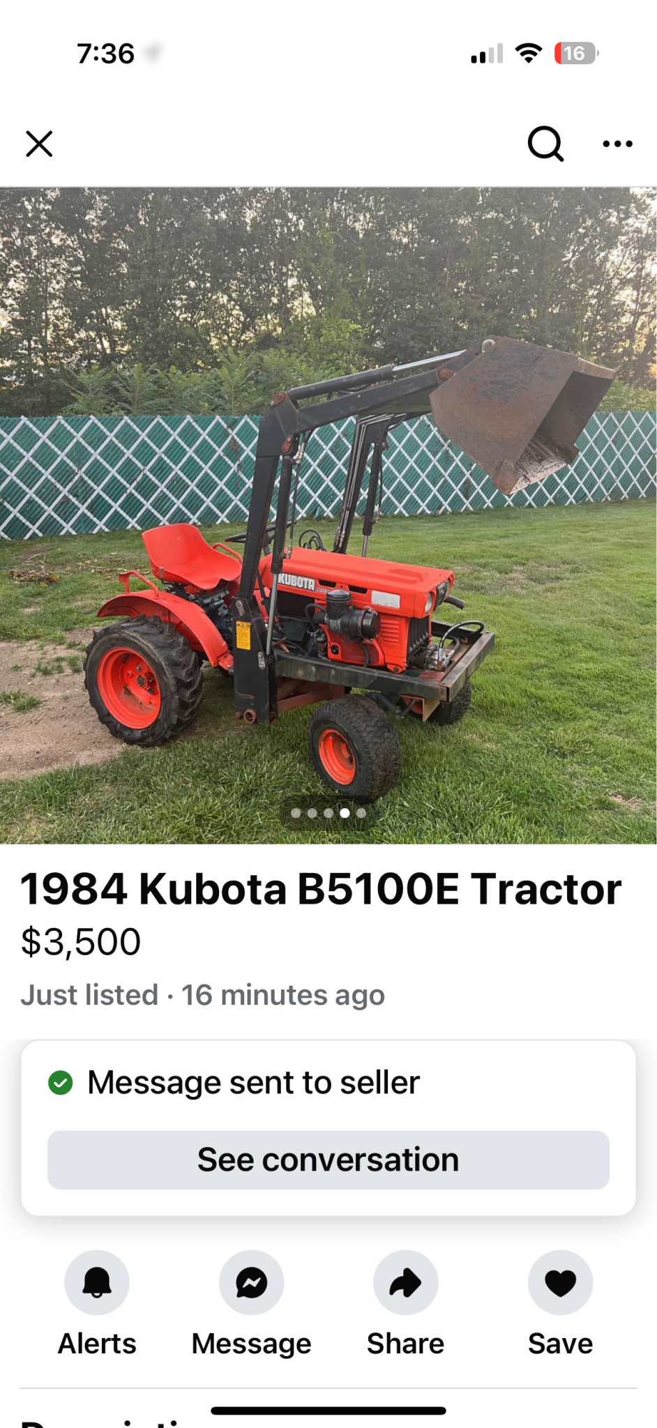

First post. I’m looking at a dedicated FEL for my small estate.

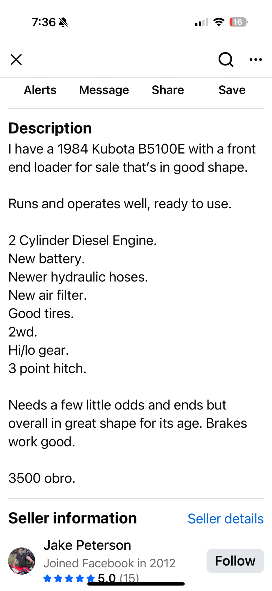

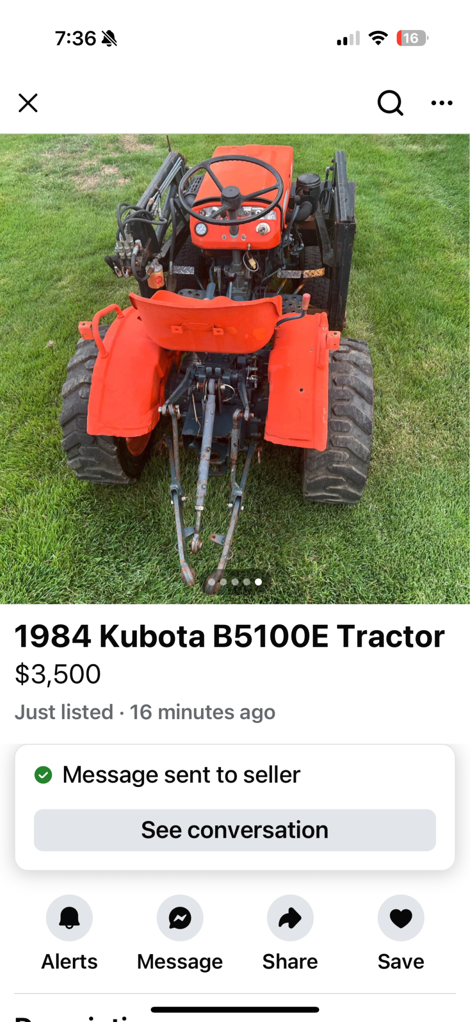

On my way to look at a clean 5100 with loader and 3 point. No hours but she doesn’t look rough at all. Everything works as it should. Could use glow plug switch replaced and shifter boot. $3500 asking.

B5100 iss the second smallest B ever made, so very low on the HP side of things.
The engine in that model is a rare engine, so if you have any engine issues you could be stuck with a anchor in nothing flat.
Everything else is pretty much shared with the larger versions.
Being 2wd and having no PS is going to make a loaded bucket pretty unruly.
Also if your not used to a standard transmission and loading dirt, you could have clutch issues very quickly.

Awd79
Sep 9, 2025
11
CT
I’ve decided to pass. The lack of PS is a real issue as is lack of safety features and user cockpit is not easy. I would never let my kids use it. Whereas when I had an L2900 years ago I was comfortable with them using as it single lever and hydro., and we had the backhoe. Miss that machine.
