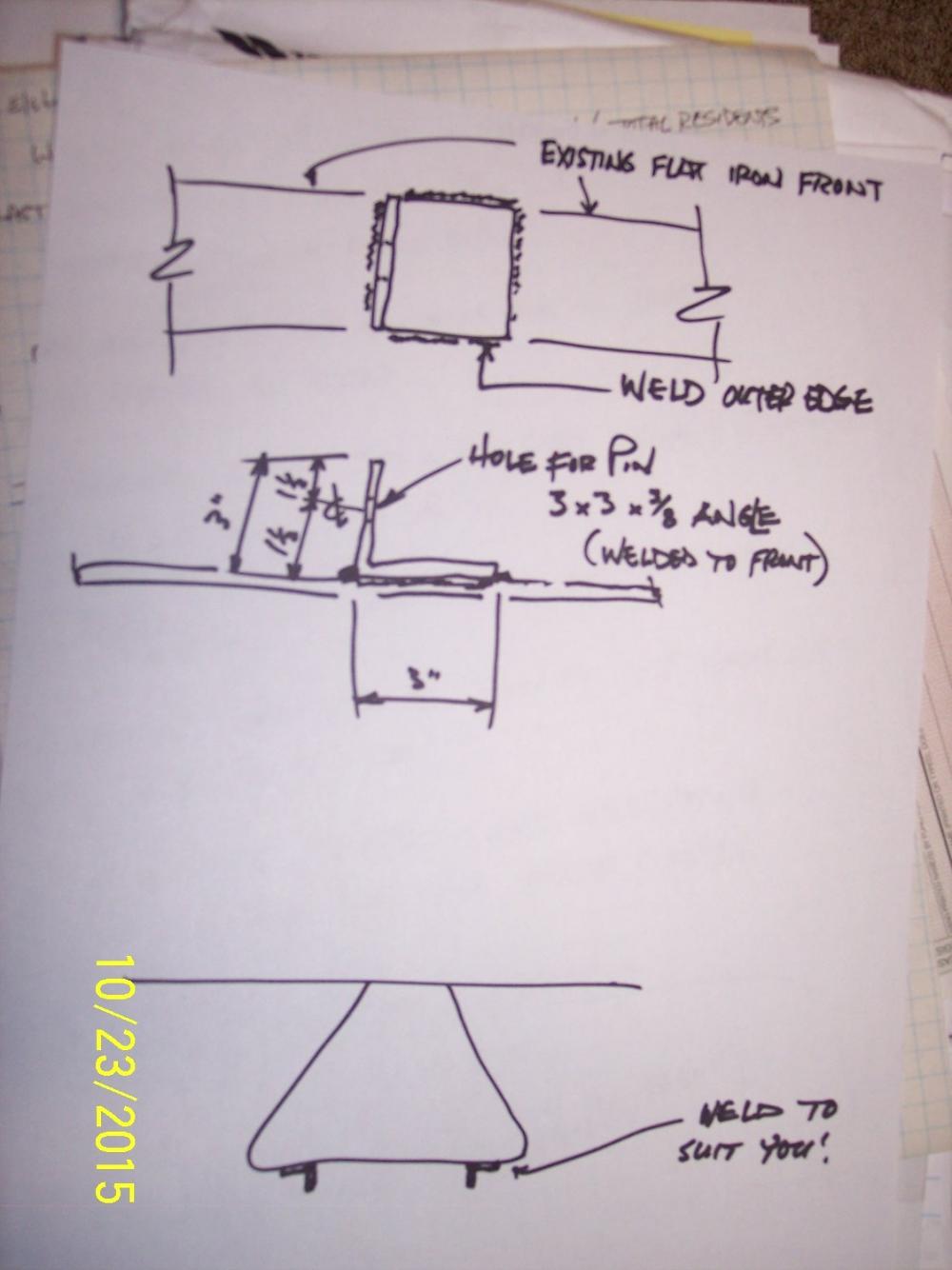

If not, as suggested, take a 3"x 3/8" angle and cut it the length of the width of the iron the exiting pin in mounted in. You'll need 2 each of the brackets. Weld them to the existing cross piece in the position you need. Oh, drill the hole for the pin before welding!!
Nice bargain. Don't sell it, make it work!

Jeff, if you or helper can drill a couple of holes and weld, here's a simple solution to your rake. It will also move the rake back a couple of inches away from your tires.
