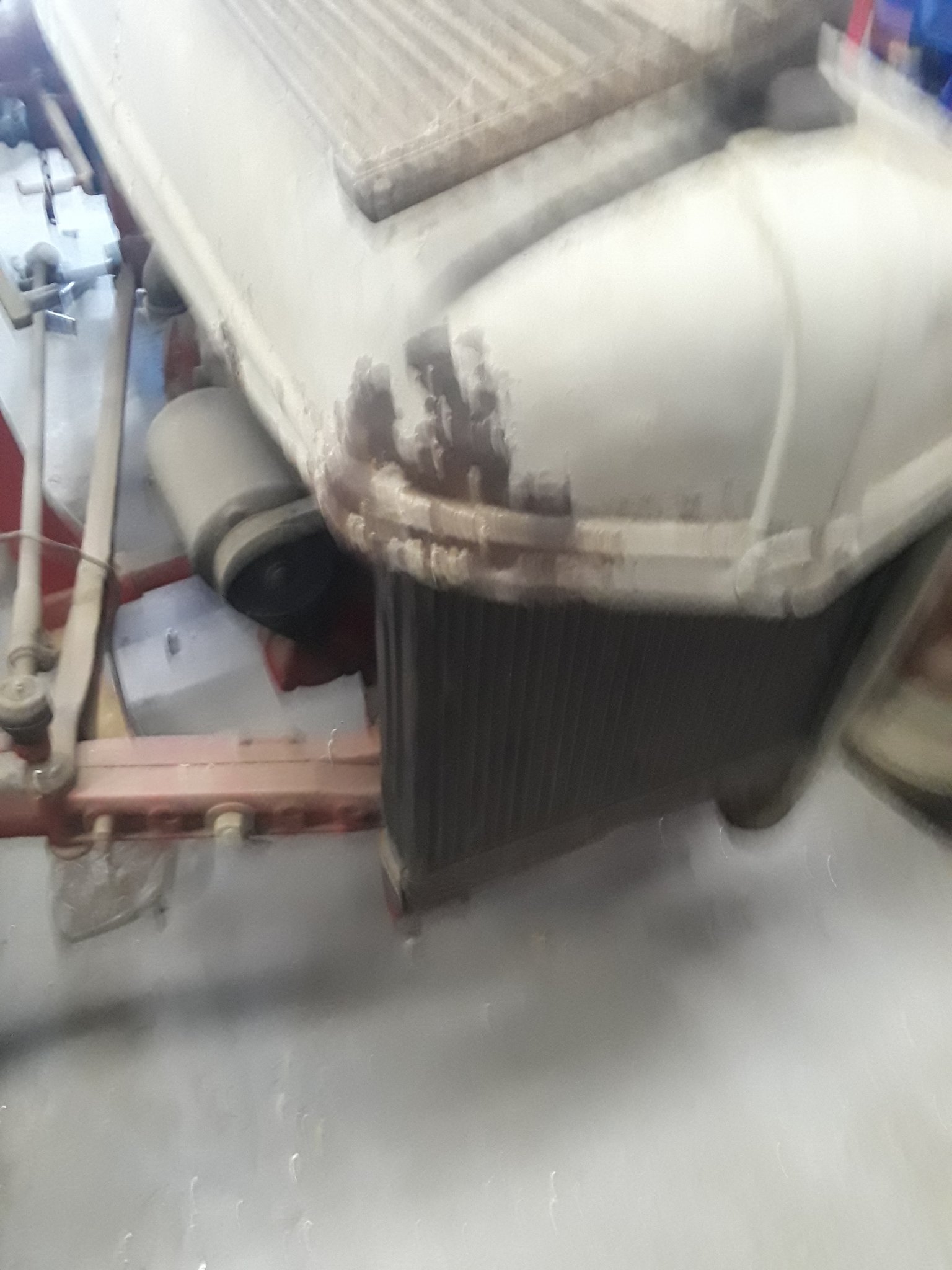

How do you stop a runaway Ford 9N? See picture. The dent in the hood was not too big and I could pound it out with a big hammer. The radiator is a replacement and the grille and right side panel are a mangled mess in the scrap bin. Basically I had a choice between a tree or a cliff. I chose the tree.
That was not the first or last grassy sled ride that tractor has given me and ultimately I decided if I was going to continue to live on this hillside it was in my best interest to buy a tractor with better gearing, a reliable parking brake, 4wd traction for down hill braking, and a 3pt lift that I could safely operate. If anybody wants to come by I will let them take the 8N with a 72" finish mower on the back for a little test drive over the circuit I mow. Then youcan tale the bush hog up on the hill and try your hand at thicket clearing and let me know what they think. If you are accustomed to the control and comfort level you get with a "high CG" 4WD Kubota you better wear brown pants.
I grew up with an 8N tractor and the fond memories the evoke have given them a permanent place in my heart. I was probably first in the seat around two - with grandparental assistance of course. But the simple reality is that of all of the different tractors both 2WD and 4wd I have operated over the last 70+ years they are the least safe on hills. Two deaths and a bunch of broken ribs in my family alone.

Ford N-series tractors do have a very low CG which is a major plus on side hill stability. But they are also two wheel drive tractors with horribly high gearing, no live hydraulics requiring you to constantly operate the clutch, a parking brake that is a joke, and abysmal down hill stopping power. All of that combined makes them difficult to operate at a safe speed and a major runaway threat on slopes. When your tractor loses traction and starts to slide down a hill out of control the low center of gravity offers scant protection for a collision, unpleasant trip over a precipice, and/or rollover caused by getting sideways at high speed.
