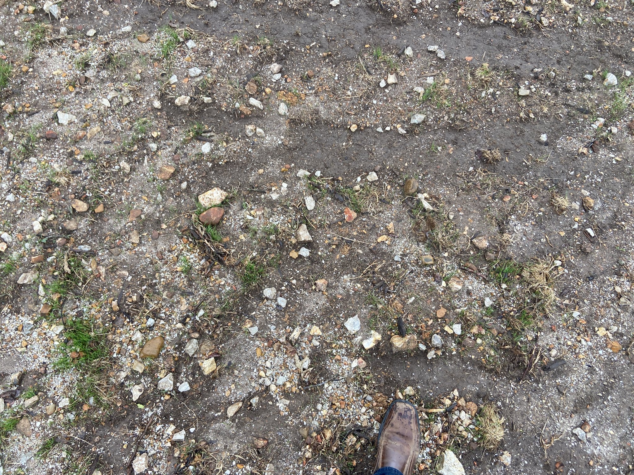

I got our sloped yard all fixed up & grass planted before vacationing in Italy. While vacationing in Italy, a massive wind+rain+hail storm came through, damaged house/cars/etc, and more grievously - washed away the loose dirt & seed, leaving a bunch of rocks on the surface.
I can rent a 5' rock rake for $100/day.
I can buy a 6' rock rake from TSC for $1000.
Have B2601.
I might actually pay $100 just to not have an implement sitting around the yard.
But...having this implement sitting around the yard could be quite useful from time to time.
Would a 6' rock rake help here?

Those rocks look a little small for a 3ph rock rake. It it were my yard I would do one of the following:
1. For a small area, hand rake with a leaf rake
2. For a large area, spread a thin layer of fine topsoil over the rocks

Good points.
I was hoping that it would collect the large rocks, while mixing/burying the small ones into the soil a bit. Any chances of that happening?

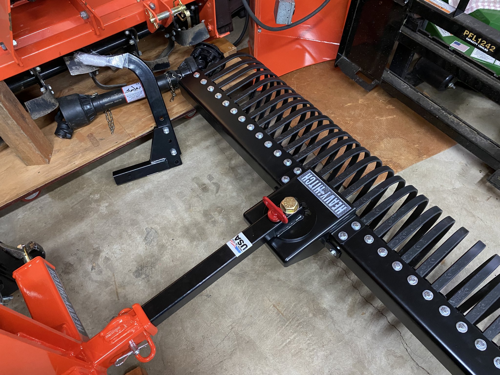

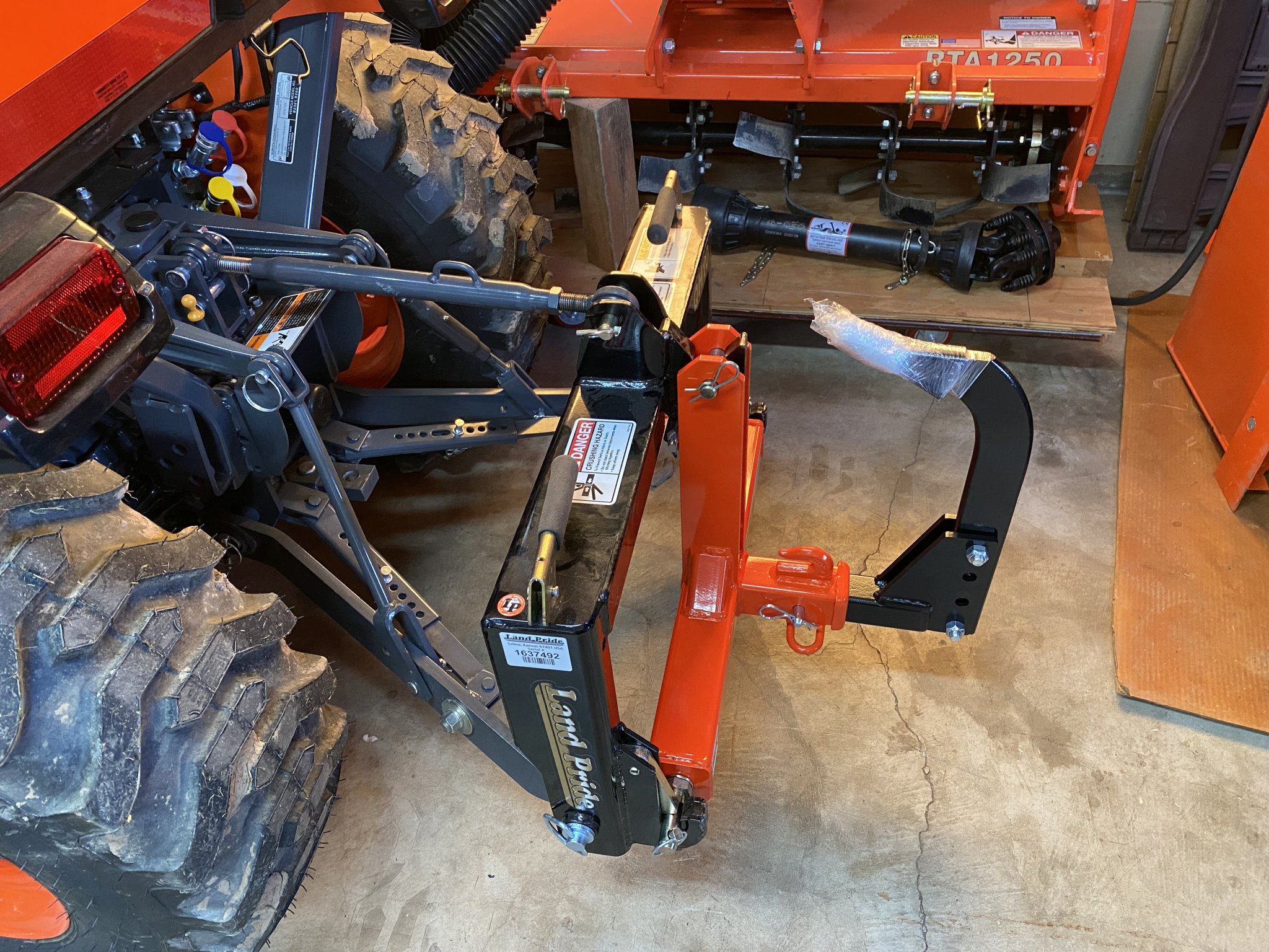

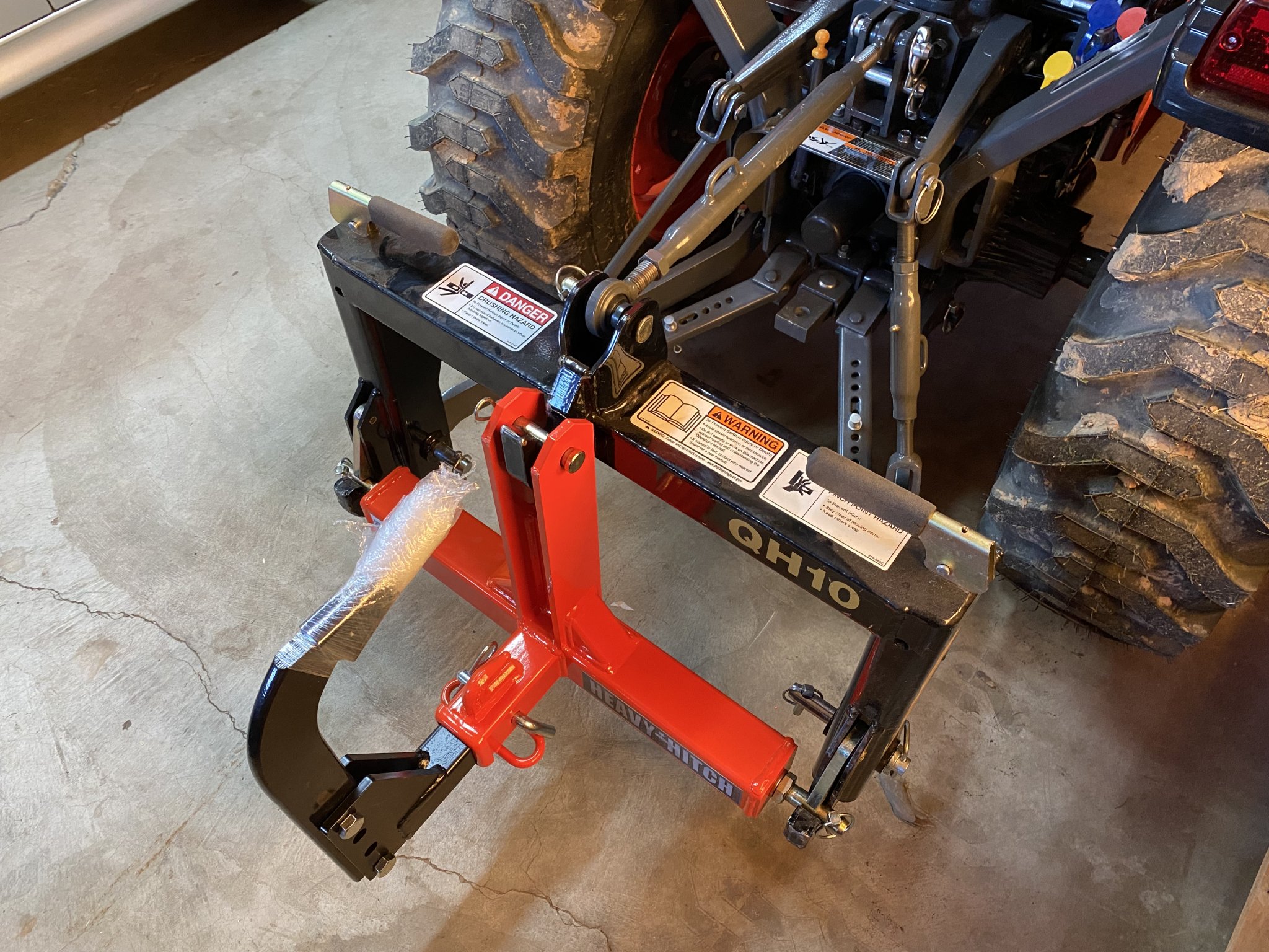

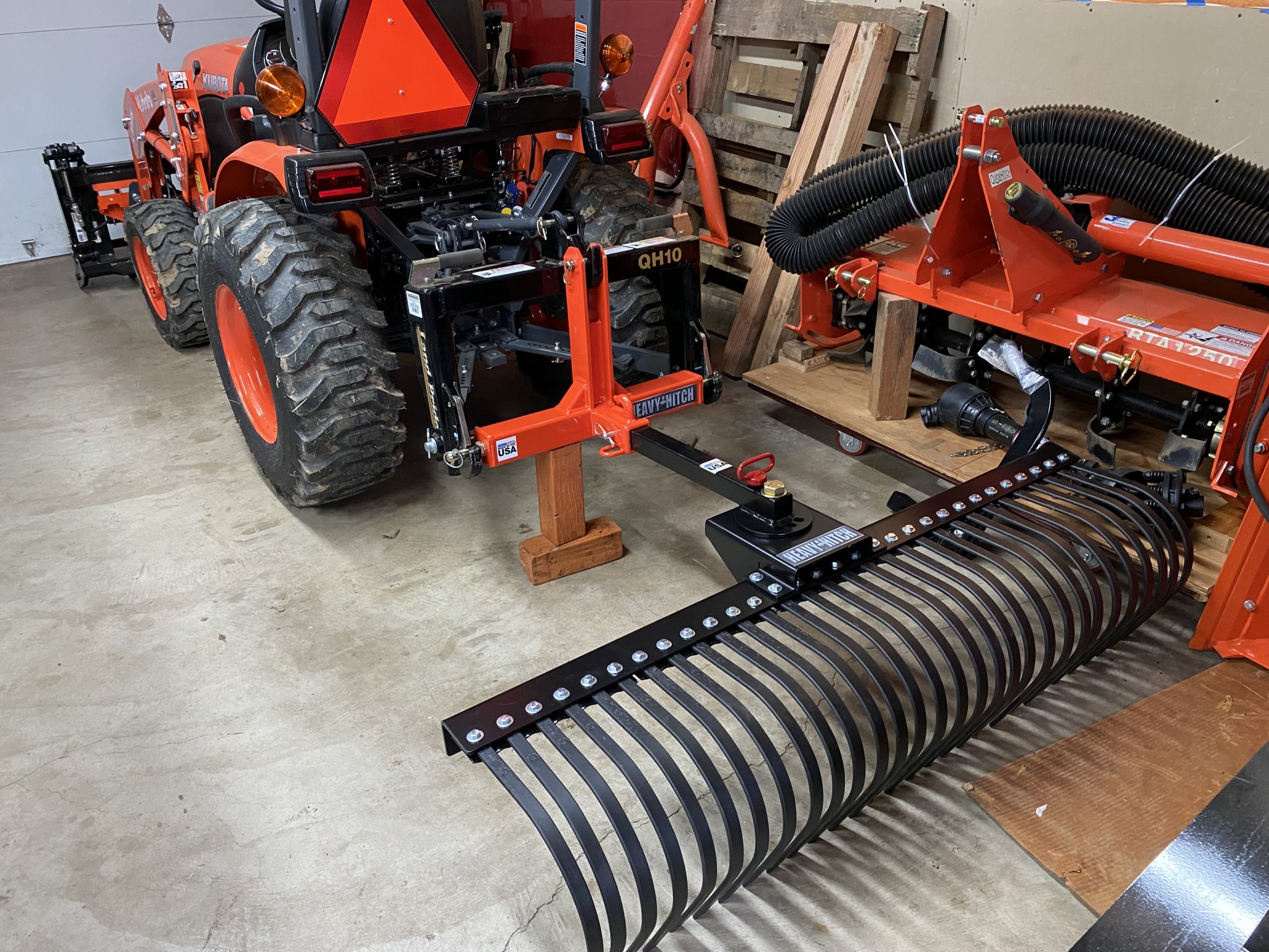

Hello Keith,
I just received my Heavy Hitch and Landscape rake for my B2601 and I really like it so far.
I have a spare lot next to me that I really have a hard time mowing with my JD riding mower because the moles have left the yard looking like a bombed out area.
I’m talking maybe a hundred or more Huge mounds Every time I go to mow.
Well I finally decided to look into the Heavy Hitch brand rake.
The rake itself was $692.00 shipped To Oregon.
I just set the 3pt to just kiss the ground and level out those pesky mounds.
Nice quality and good people at Heavy Hitch, nice family business.
I can see where this 60” rake is a good fit for my Bota.
I have a ripper tooth as well.
You can see the two remotes on rear of the tractor that are waiting for the Fit-Rite Hydraulics Top N Tilt kit.
I’m at week #31 of a 30 week minimum stated waiting time.
Real close now ( I hope ).
Hope you find what you are looking for.

IDK. I’ve never had a rake. I’ve looked at them and can see it wouldn’t be effective for those small rocks. How about a roller to press them into the ground.
9,921
4,067
The 'trick' with the landscape rake is in setting it up 'just right', snag the rocks and not the soil. Usually you'll see them with 'gauge wheels' on them for tractors that don't have active 3pt position control.
As long as the grounds pretty level, wheels are 'optional'. I built one in '77, did 5-6 acres one summer.
Once setup proper, you'll snag every rock or stone bigger than the 1" spacing of the tines

A rake without gauge wheels is nearly useless. As the tractor moves up/down in the slightest, the rake is going to go with it. However, a rake with hydraulic toplink, and (most importantly) gauge wheels is entirely different. It is my most used attachment. Fine grading, spreading dirt, rocks, ect, there isnt much that can beat it besides a harley rake.
If cleaning ¾" stone / contaminates from lawn, I would still pick the power broom.
