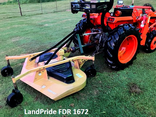

6 foot finish mower:

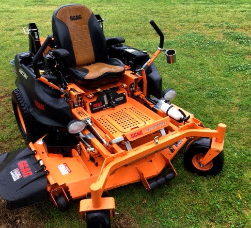

5 Foot Z/T:

I added a ZT to my mix and wow am I happy with that choice.
Faster then a tractor by far.

I found a used Land Pride FDR2572 in perfect condition, I use it behind my B2650, I did ad a full set of front end weights, it works great.

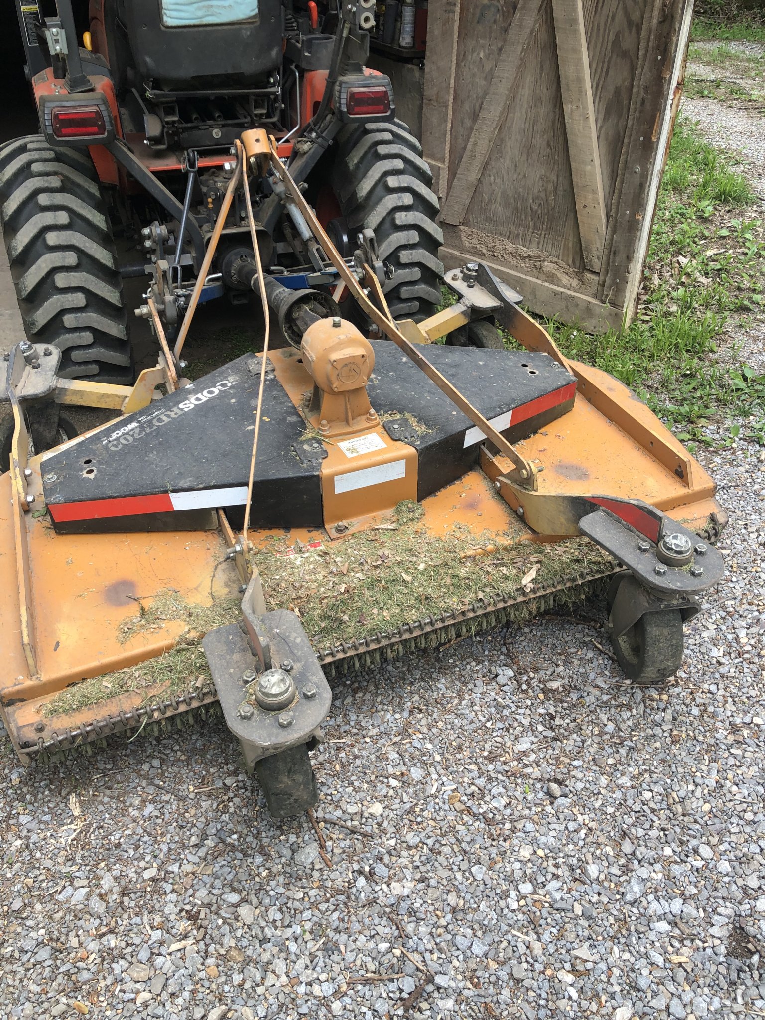

Wife does most the mowing on our hillside farm. 6’ finish mower on B26. It also mulches and blows off leaves on our 1/2mile green tunnel driveway. Being able to back under landscaping and down creek banks a zombie can’t. Plus go in sum real ruff areas. Up graded spindles to trailer axles to meet the need.

To be clear I modified the caster wheel stems to trailer axles. Was having excess wear and bending of the OEM 1” diameter stems.
Woods uses taper roller bearings on the blade spindles. Just rebuilt the first spindle this spring after 25years and about 2,000+ hours. Good design.

I ran a land pride 72" RFM behind my B2650 for about a year and half when we bought our 5 acres. I got it super cheap because the PO was missing a link of chain for the tensioner and couldn't get the belt routed right so it would cut right. Our land is mostly grass, rolling hills, old pasture. The tractor did it just fine for weekly cuttings. Picked up a 61" Turf Tiger and it's been the ticket. Much, much faster, and more maneuverable. A 72" ZT is sweet, but they aren't as common as a 60/61" deck and depending on the terrain they have more of tendency to scalp. My Scag is an early 2000's with a 25HP Kohler, the newer ones are up into the 30 and evern 40hp, those suckers will cut as fast as your back can handle it, in thick wet grass. My ZT does much better than my neighbors John Deere ZT of similar vintage.
