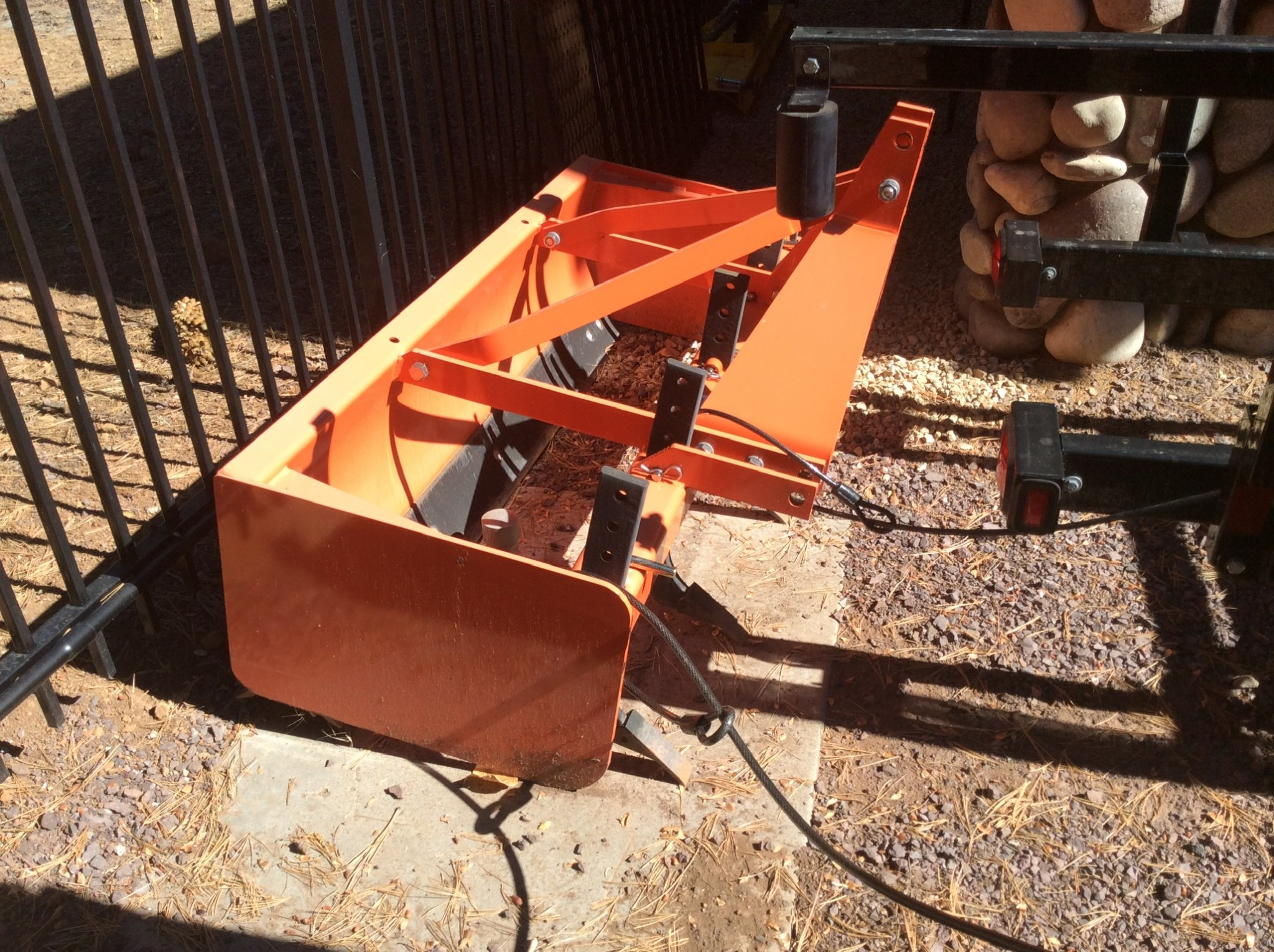

I have a 6’ Land Pride BB for sale…I used it once…here in CA if interested OP. The listing and pics are in the for sale forum.
