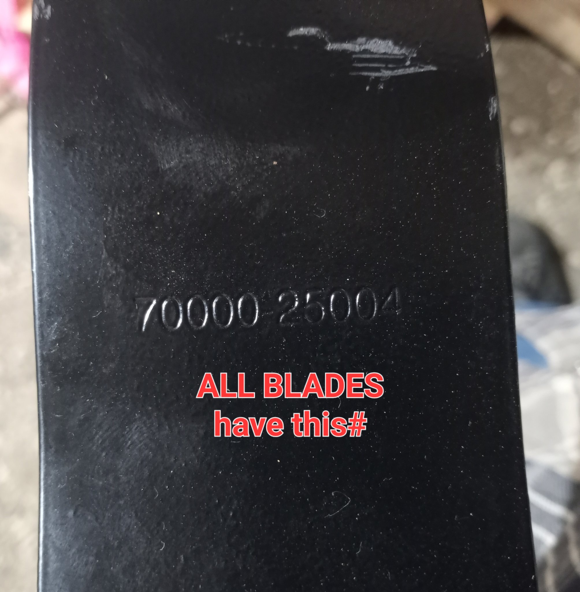

I bought a GF1800 last summer to help me complete a huge mowing contract.
I wanted to change the blades today, but I'm now a lil confused.

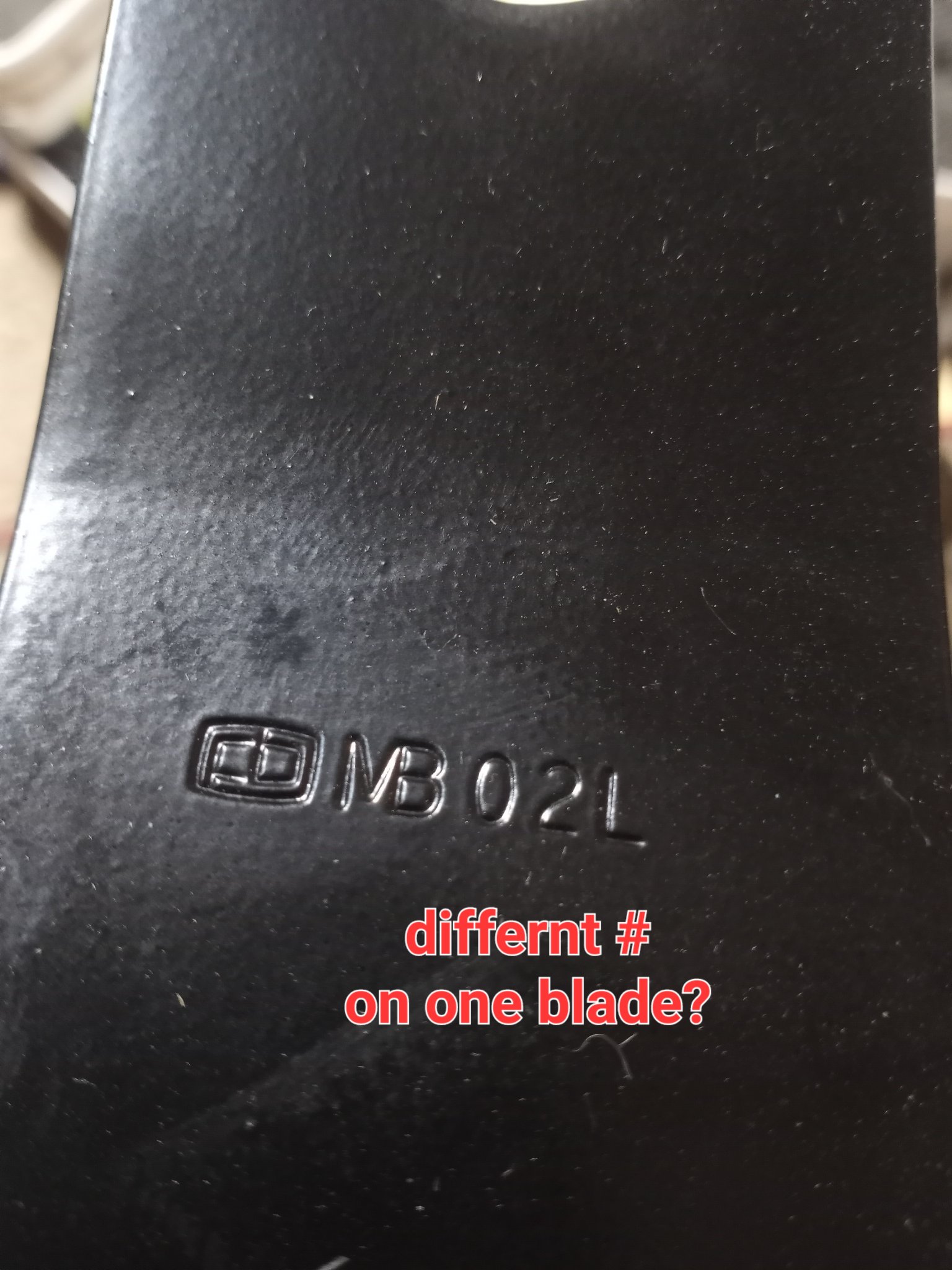

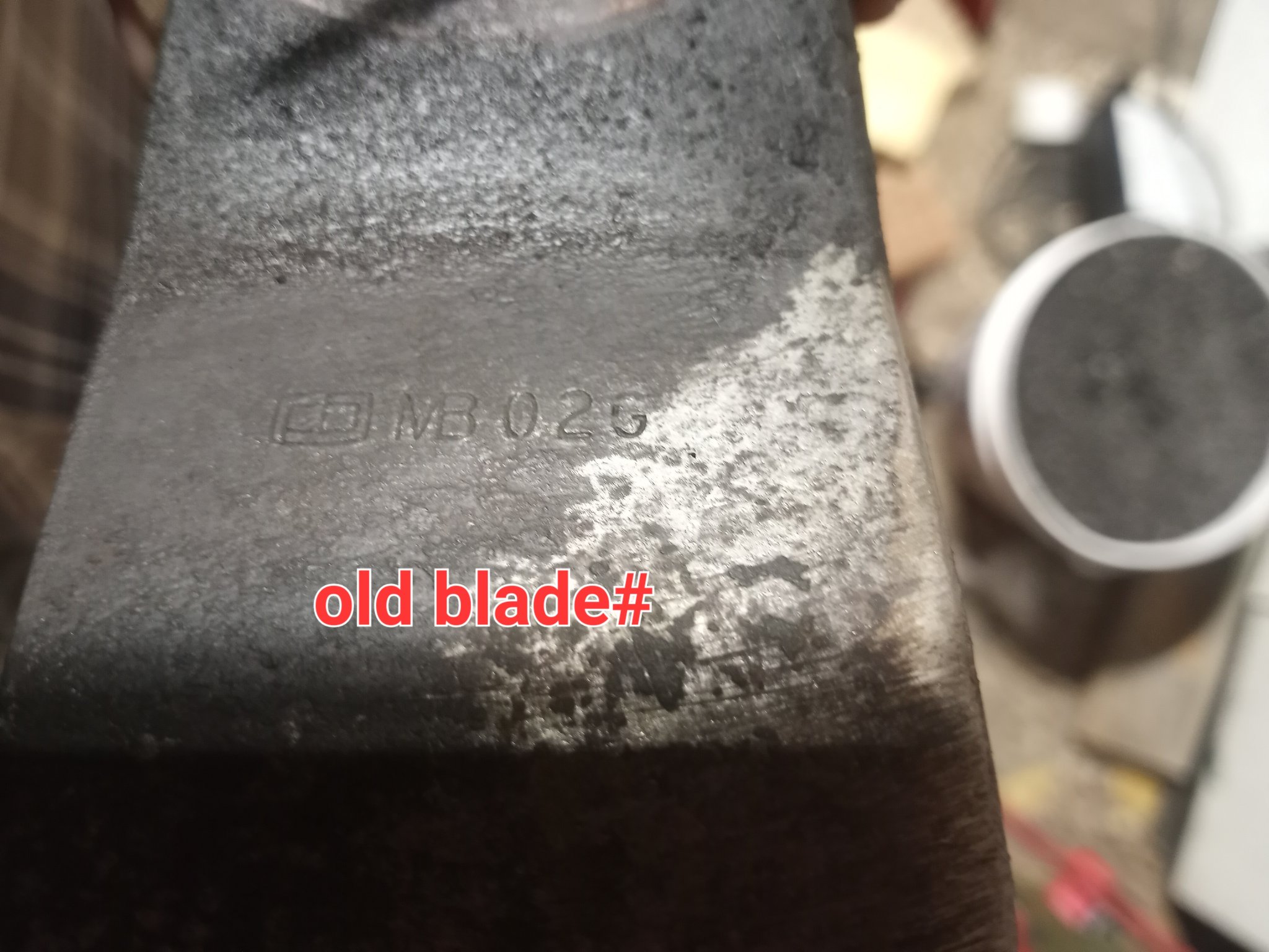

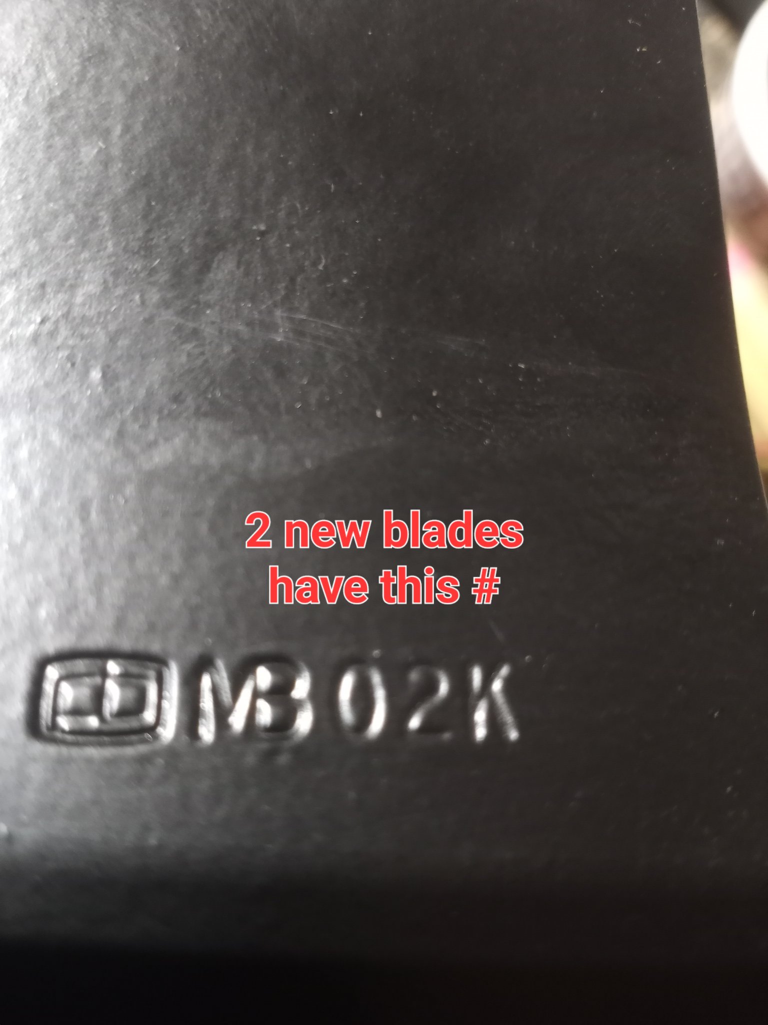

The 3 old blades all have the same part #, the new 3 blades have one blade with an odd ball part , or one has a differnt part #.
I'm wondering if the blade with the odd ball part # belongs in a certain place?
Did i get the correct blades??
Did the previous owner put one blade on that was incorrect?
I will post all the #s later, when i go outside again.
Any help would greatly be apprieciatted.
Can't wait to learn some things about my Kubota here😁

All three blades are the same size and Part# regardless if they are standard, medium lift, high lift or mulching.
7,169
2,597
You can look up the part numbers on the Kubota site for Canada.
You may also be able to see the same information on Messicks or Colmans web site.

Yea MB02L and MB02K is a production mark not a part number.
They mean nothing to you.
