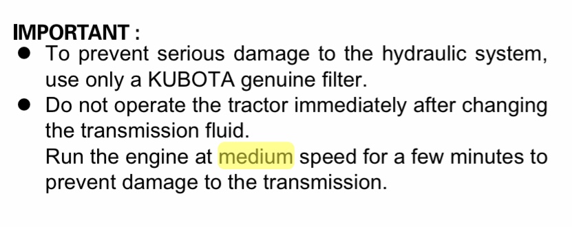

Yeah....I am not sure, so that's why I asked the question (see the 2 screenshots I posted). Who knows.

My WSM ([ssued 4, 2017a) shows transmission oil to be changed at 50 hours, with the filter changed and the screen cleaned. (Section 2, page 15)
The WSM also says (Section 2, page 25) "Do not operate the tractor immediately after changing the transmission fluid. Run the engine at medium speed for a few minutes to prevent damage to the transmission."
