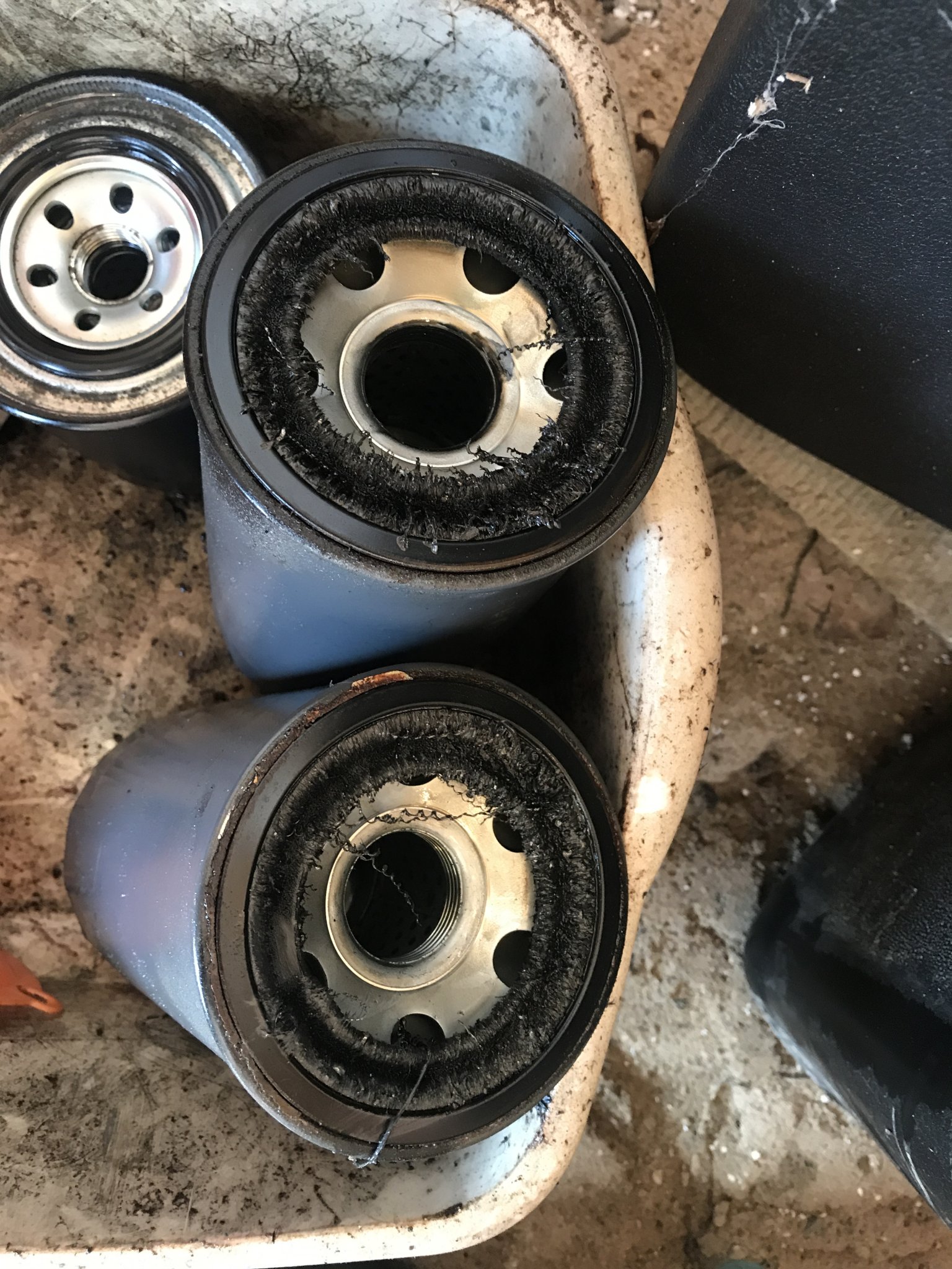

The M7060 (geared tranny) calls for hyd oils changed at 1000h. filters at 500. So at 500 now, i changed the filters. Here's the pic of the magnets. I cut the filters open and didn't see anything alarming.
A bit of dirt but i suspect i'm harder on the brakes of this machine than normal as i road travel a lot with a heavy trailer.
Should i change the hyd oil? front end oils? It's only premium udt (sudt) here in Canada. I probably should, it's peace of mind and only $500-$600.
nearest servicing dealership is 5 hours away for me if needed. They recommended to change the oil and filters again in 20-50hours to see what it looks like.

I just did my 50 Hour maintenance last week, and I did save the filters. It noticed the metal shavings as well.
My tractor is 3 hours away from home, so please bear with me, as I need a couple/few weeks to get back there. Will post up some pictures for you, for comparison to your filter change.
Here's a picture of my filter and the shavings on it, for the 50 Hour filters change, etc.
Hope this is helpful!
