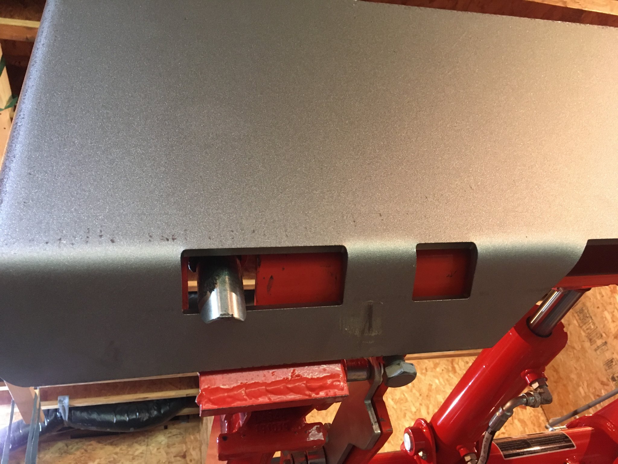

It came in today.. I may have over thunk the thickness needed.. just thought if it was to be used as a stump bucket it would take some tuff abuse! Now, looking at it I think I could have gone with 3/16 or 1/4" easily! Oh well better safe than sorry! 6EF64422-A064-448E-86A0-57C67937A5C4.jpeg A8E02AFD-9D01-43B2-987C-B223F9B2868B.jpeg 94BEA8D7-74E4-4BEE-B6F3-575E16B3302E.jpeg 24156BC9-692F-426B-8D5F-1FB1FC0E4C4F.jpeg 80D01BE8-D47C-4631-8C32-CB6AE20CA584.jpeg The fit is great!

Put a 2" receiver on it and have the most overbuilt trailer mover ever!
Looks nice otherwise, following along to see what you build.
