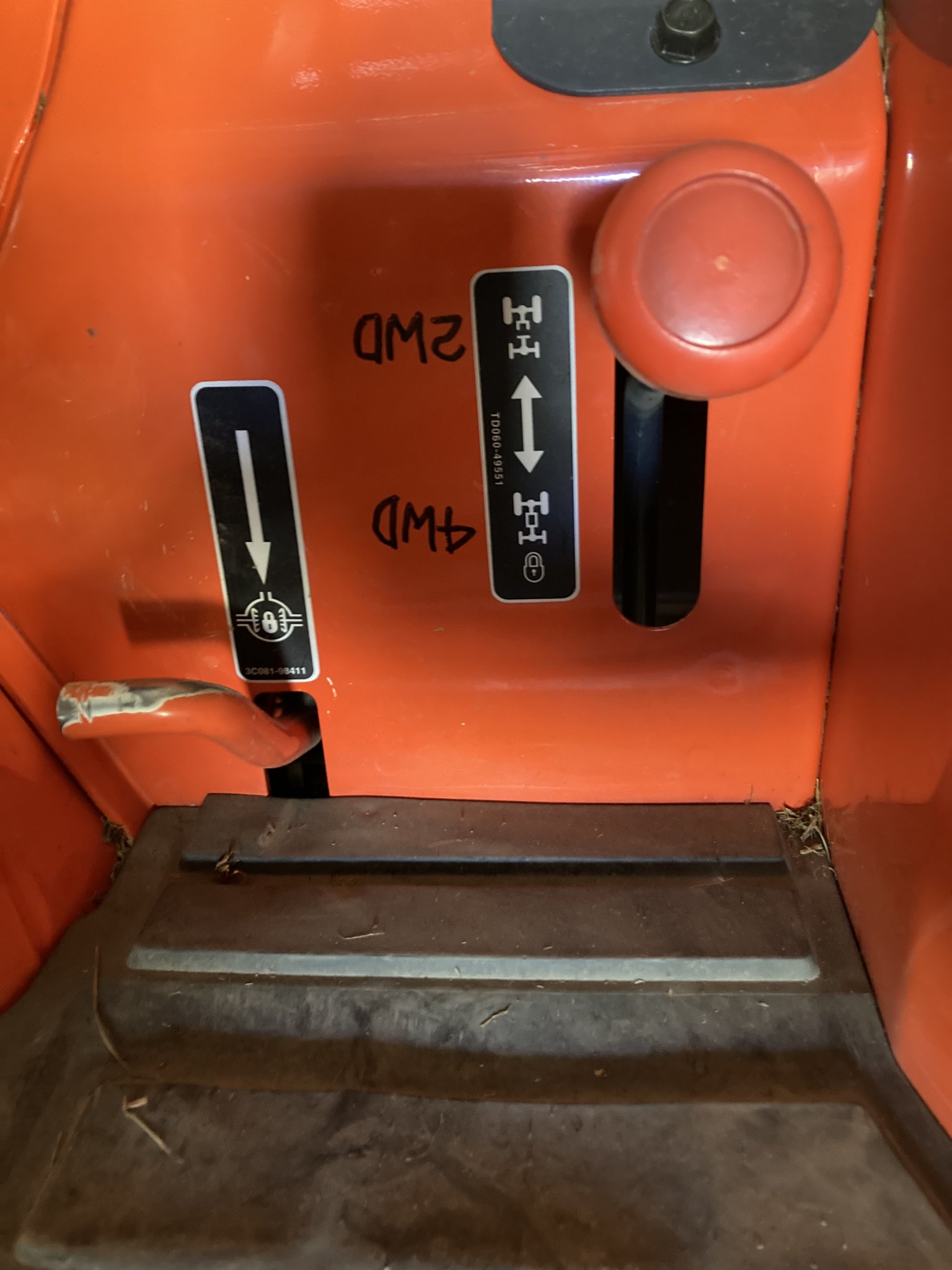

This is the 4X4 lever hopefully you can see that it is a very short throw, up and down so not easy to tell if engaged or not. Also the orange knob has no medallion to provide information for engaged or not. I know it's on the sticker behind the lever but noway can it be seen from the seat. I have used it enough that I'm familuar with when down engaged up disengaged but it would be nice to have an insert for on the knob for infrequent users.
Wow- yes, I see exactly what you're talking about. I'd have to stop the machine and try to bend over to get a real good look at that (probably putting on my bifocals in the process-LOL) It's way easier on my minimachine (BX2380) to merely glance down to the right and see in an instant whether I am in 2wheel or 4 wheel.
Lots of good ideas so far.
Seems like something Kubota could've easily installed on all our machines for $5-$10(or whatever) (their costs)

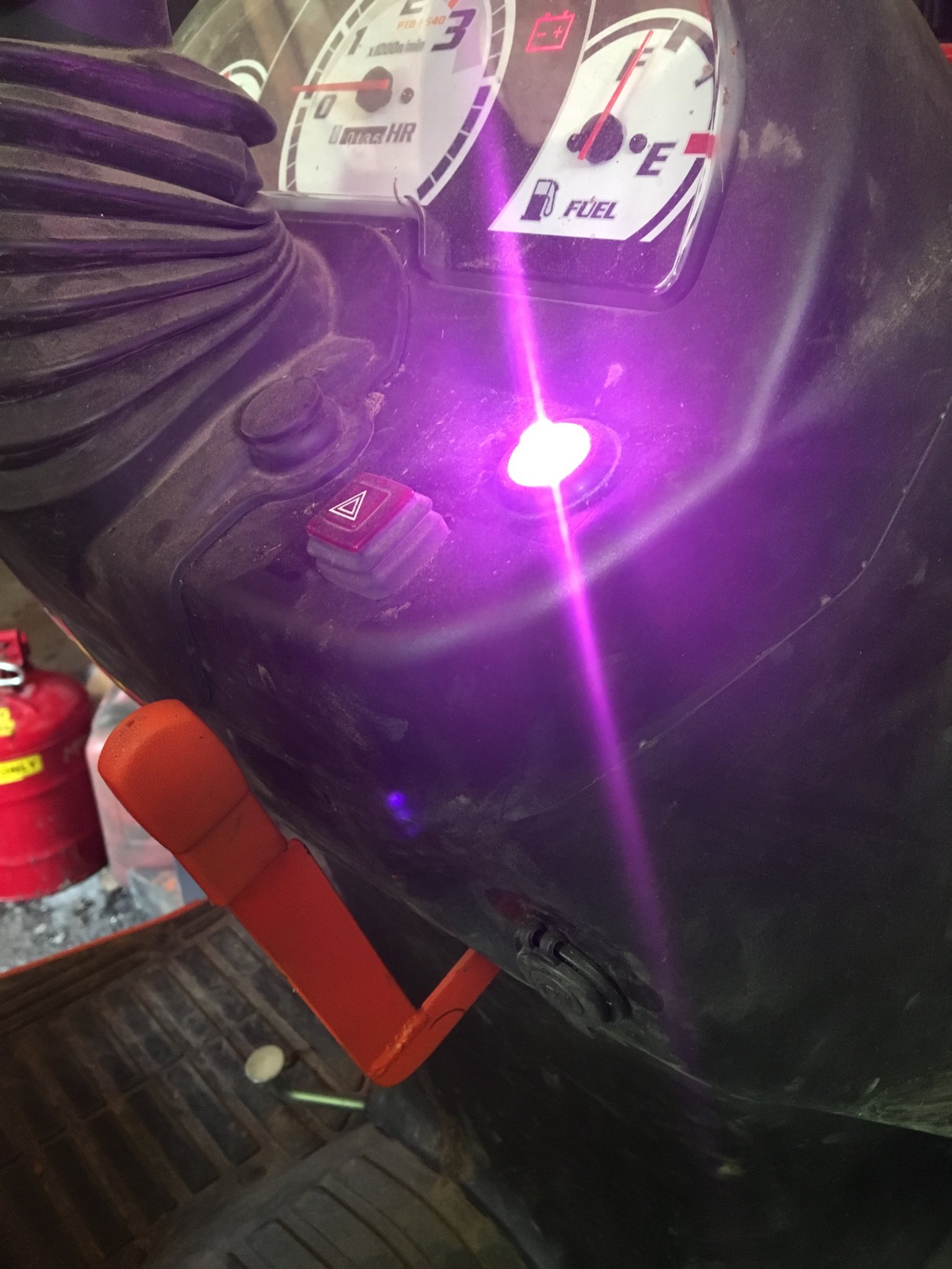

No sarcasm perceived, spot on optic.
With my tractor the manual lever is down on the left side, about lower calf height and not easily seen from the seat. The lever travel is short also and it doesn't easily show that it's engaged. The problem I have is I engage the 4X4 while using in soft conditions and then forget (memory loss as I get older...lol) to disengage when I head home on the roadway. I find it frustrating that I subject my tractor to having the front axle engaged on the highway, it has to be hard on the drive train, or maybe harder than I'd like for it to be.
I have already put thought to a microswitch I was just checking to see if anyone had already figured out the details or maybe even a better way.
Thanks for your response, always good to get feedback and a different opinion. Sometimes the obvious needs to be said, that doesn't make it sarcastic.
This has come up before. The knob on my L35 is down by my left ankle, not exactly in a normal control scan area. I bought an LED indicator from Amazon, but haven't installed it. I'd also like a voltmeter and need to make my neutral interlocks functional.
That’s the same place my old GrandL has the front axle engagement lever too. The symbols are too small for me to see well. I’m sort of simple, so on my L, the surrounding sheet metal is orange, so I wrote 2WD and 4WD with a black sharpie on either side (above/below) of the lever for an easy confirmation when I look down at my left ankle. On yours either a white paint pen or an adhesive backed pair of labels could do the same thing.
With all the dash lights, it is indeed odd Kubota hasn’t included an “extra” dash light for this function in over 20 years. It’s not like they are trying to economize less than probably $5 or 10 to hit a price point with the GrandL series.
