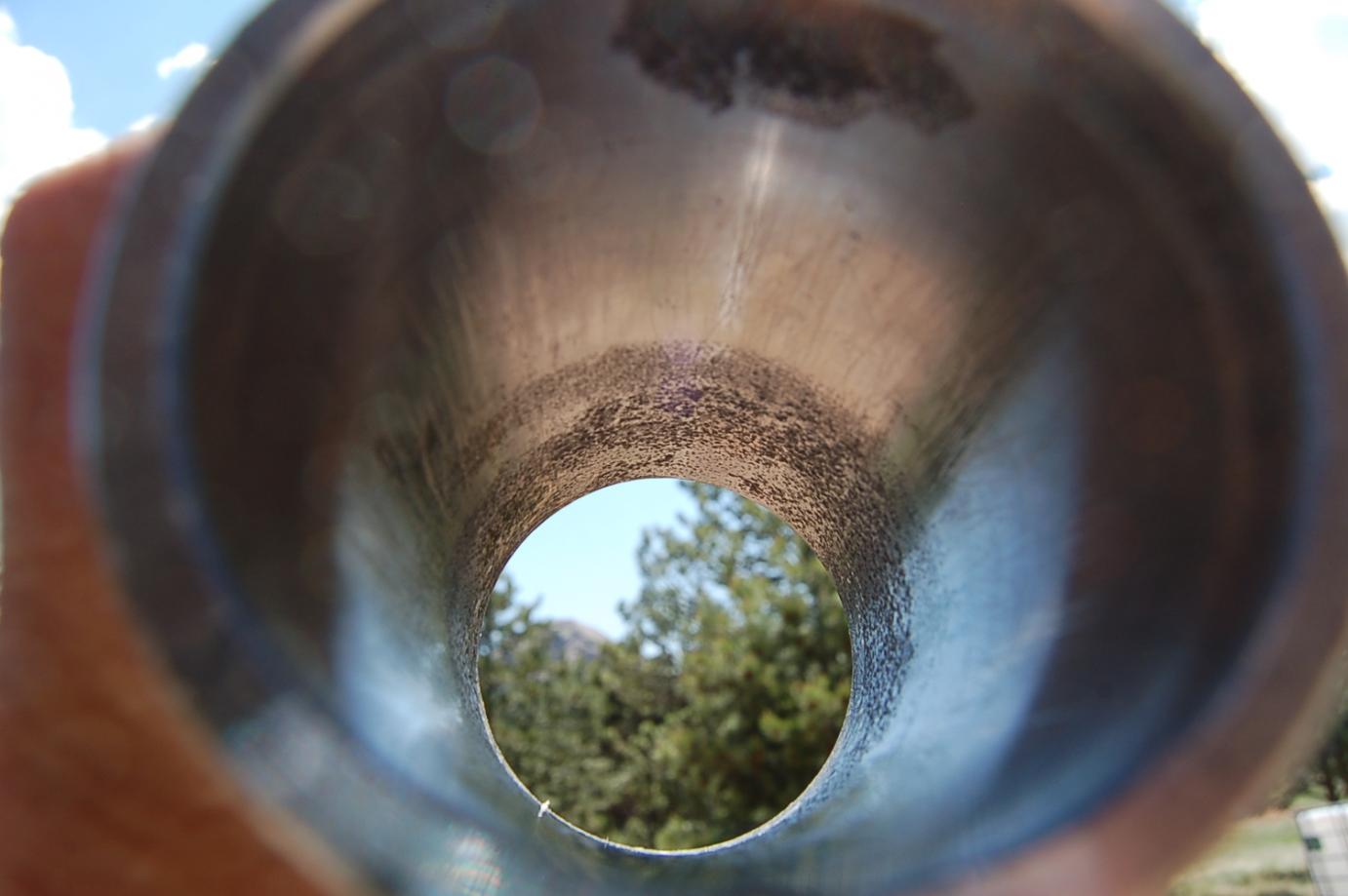

Well everything came out as a unit, but when I tore it down I had a sinking feeling
Extremely bad pitting on the cylinder liner :eek:
It got worse when I checked the price, I was thinking $50-60,
worst case a hundred, it's just a steel cylinder with a step machined on the end.
$429.86 :confused:
I figured it is at the lower end of travel,
I am running with it.
Back together and it holds :)
Now that is dodging a bullet, if I ever did.
I won't mention that it went up and down 5 times before I
remembered that I had a chain holding it up,
thought I did not have full travel. IDIOT!
Now full travel and it holds, wheww.

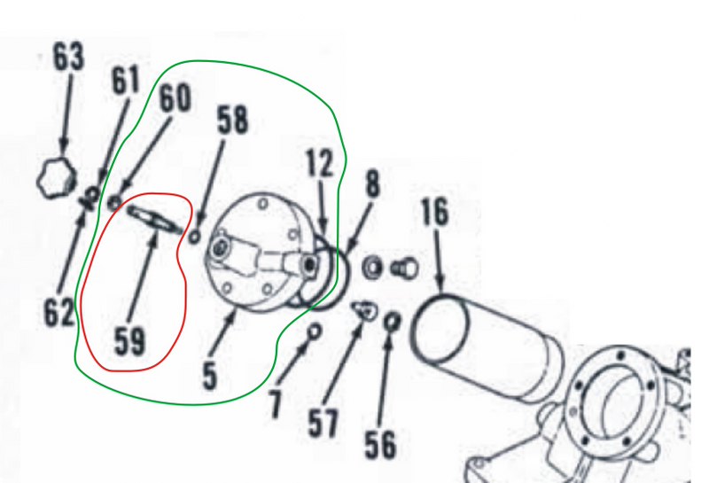

Well not such an easy fix, part #59 (Flow Control Valve Adjuster)
is now in two pieces an one piece is permanently part of #5 (Cover)
May try drilling it out, and re-tapping it, That may work?
Will check with West Kentucky Tractor tomorrow and get pricing for the assembly (in green).
May even check with Kubota, I could use some more sticker shock. :D
