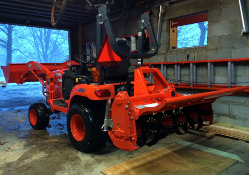

I ended up going with the Phoenix (Sicma) from everythingattachments - it has sliding lower arm connections so it can be offset or centered.
I'll be happy to post about how it tills when central OH thaws and dries out, but my question for now is about storage. When I set the tiller on the floor on its tines it want to lean in the opposite direction of the stand. So I set a short piece of 4x4 under each end flange, which keeps it upright, but then all of the weight through the center of the tiller is not supported. Anyway, and tips for setting it on the tines and keeping it upright are appreciated.

My self I would put it back on the pallet it came on and maybe some caster wheels to move it around, other wise back it in set it down and forget about it until you need to till again,,, that is of course after you hose it off first:D
