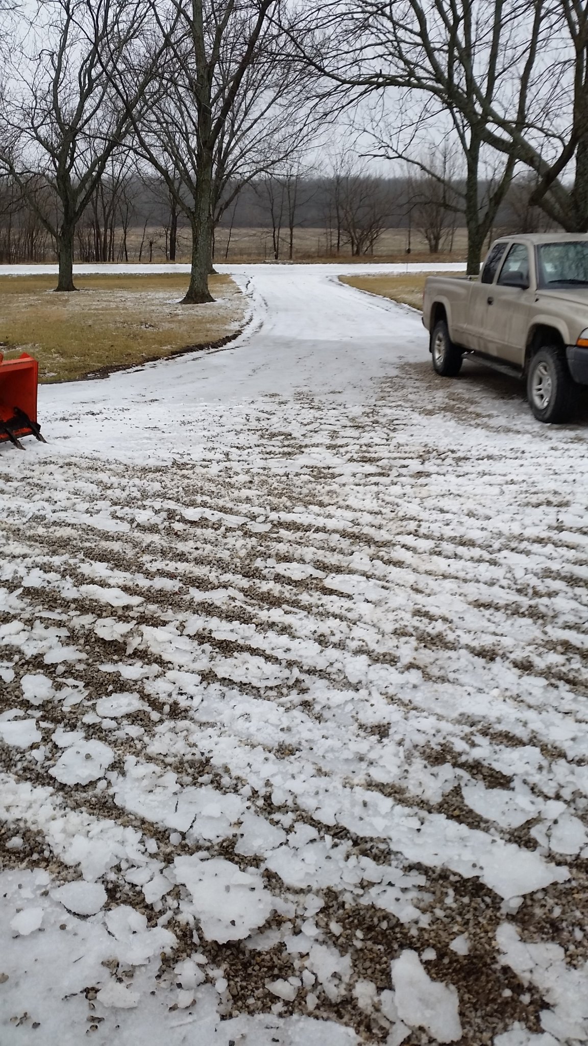

Here's a picture of breaking up ice with a toothbar on a loader bucket. It would work with fewer teeth, just more time required, but less HP and probably less traction. Gravel, rock, dirt would be the same process.

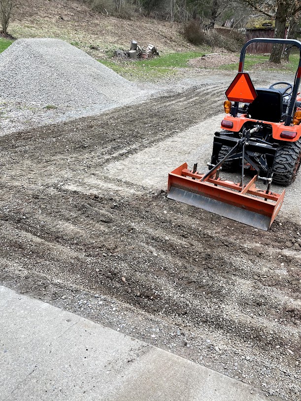

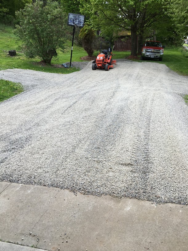

Thanks! These pictures are very helpful ... they give me a sense of optimism. I've been chewing on this and I just don't see getting a box blade with 3 scarifiers. The Braeber is looking better all the time ... will need to go see it in person. It weighs in at 368 pounds. That's on the high end of the range, but it seems that heavier is better up to a point.

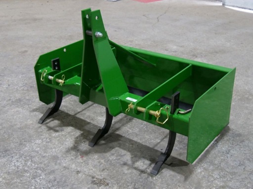

you are welcome :). i bought a titan 4ft box blade local, it came with 3 shanks, have not used it yet ?, but i could not pass on the price, and it being in stock locally.
Ah. There are titans available locally, but not at a "could not pass on the price" price.

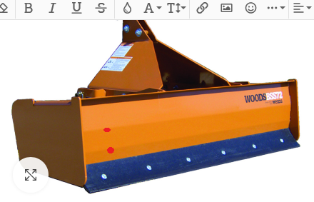

Hey, on the Titan ... this is Titan Implements (not Titan Attachements) correct? What's the shape of the moldboard? The Everything Attachments seems to have a fully curved moldboard. I've seen other boxes that have two bends (e.g. the Woods). I believe some are simply flat, and then some appear to have a one bend in them, like I think the Titan Implements does. Could you post some pictures?

i have just one pic of my 4ft titan box blade. yes, you are correct, its not titan attachments, its titan implements.

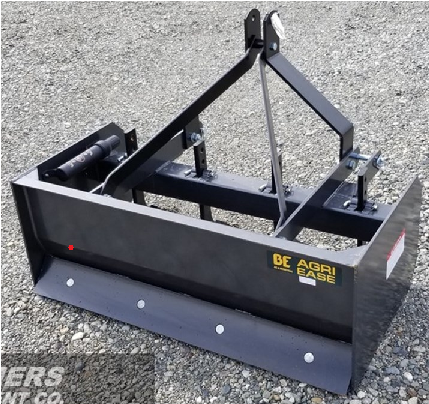

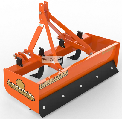

Thanks for the pic! I see one crease at the bottom of the moldboard, then straight up from there. I'm ok with that. Difference manufacturers form their moldboards differently. Some appear to be completely flat. Others put one or two bends, or even a fully rounded curve. I don't know how much of a difference it makes, but LandPride explicitly calls out the shape of their moldboards. Kind of an interesting detail.
One of the thing that's common amongst all of these boxes is that they have a clevis instead a pin for the 3PH attachment.
  • The Woods, at least the bigger ones, have two bends.
  • The Land Shark appears to have a single bend, halfway up.
  • The Braber/AgriEase has a single bend down low.
  • The Land Pride is a fully curved moldboard, and they explicitly state that this is especially helpful for sub-compact tractors by reducing friction.
