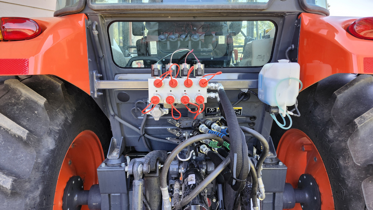

Im looking at the summit 4 spool kit with front 3rd function and 3 spools for the rear. I would like to run from 2 of those spools top and tilt cylinders. So im also looking at the summit top and tilt kit. And I would still have an extra spool on the rear or that I could route to the front for an extra function on the front if needed.

I believe that you are considering electric valves, yes? Electric valves are far from optimum for controlling top & tilt cylinders. I'm not saying that they don't work, but in no way can you feather the controls as you can with manually controlled valves. And the need to feather the T&T controls is very common.

Yes I was looking into electric spools. I did consider a multiplier for the 3rd function using my loader controls. But that wouldn't help feather the rear controls.
Suggestions on options for the rear?
If I do end up with electric are the summit or wr long better?

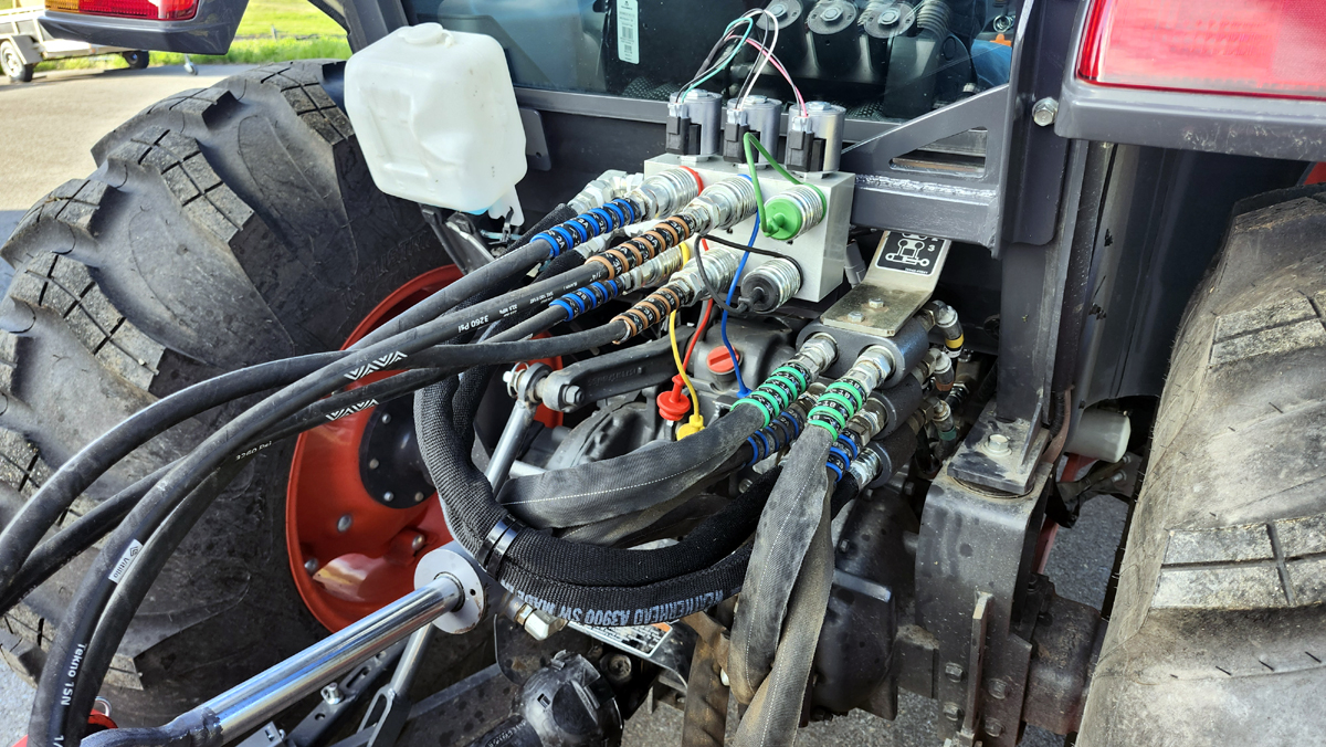

I think everyone is saying that you can easily add a 3rd function valve to the existing FEL valve and then add a line to the rear of tractor for the manual valve rear remote. Then two more hoses on the rear valve (power beyond and tank return.
Pump will provide flow to the FEL valve, then the 3rd function connects to the FEL valve and feeds power to the rear remote (as I understand it). The rear remote valve must be ordered with a PB sleeve installed which is then routed back to the tractor to supply power to the three point hitch. Then a tank return from rear remote to tie into the tank return line from the FEL.
Rear remote valves like these

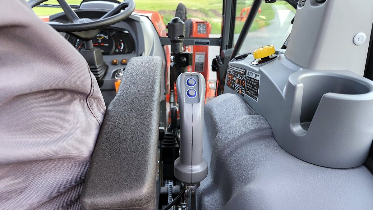

I have three factory rear remotes on both tractors and Summit Hydraulics multipliers on both too. I think that the Summit systems are very well made and wonder why people don't install just one rear remote with one lever and control grip, then add a 4X muliplier. I've never had to operate two remotes at the same time so having a control grip with momentary buttons on a single lever seems to be a very nice way to operate stuff out back.
I should probably do the math and figure out the cost of one factory rear remote with lever, a 3X multiplier and a 3-button control grip.

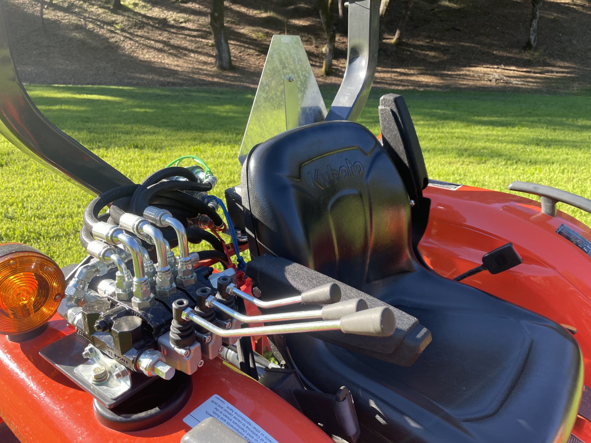

The valve set pictured has the control levers very close to where they would be located in a cab tractor in relation to the seat.
Yes the levers as pictured move in a different direction (up-down) vs towards you or away from you as they are in a cab tractor, but that is an option also.
Just another option that is available. :)

Ideally I would want a 3rd function that is an electric push button on joystick controlling a diverter from the loaders lift circuit. That way I could push the button then use the joystick to open/close the grapple and curl. Then release the button and lift.

Nobody sells a rear remote kit that goes in the OEM position. I had one in the works 3 years ago but got clobbered by lung problems that put it on hold. I am exactly one year post double lung transplant anx hope to get it restarted in the very near future. My target price is $600 for base kit with one valve and $1000 or less for three spools and outlets. Availability is at least 4-6 months out and dependent on continuing improvement of my health.

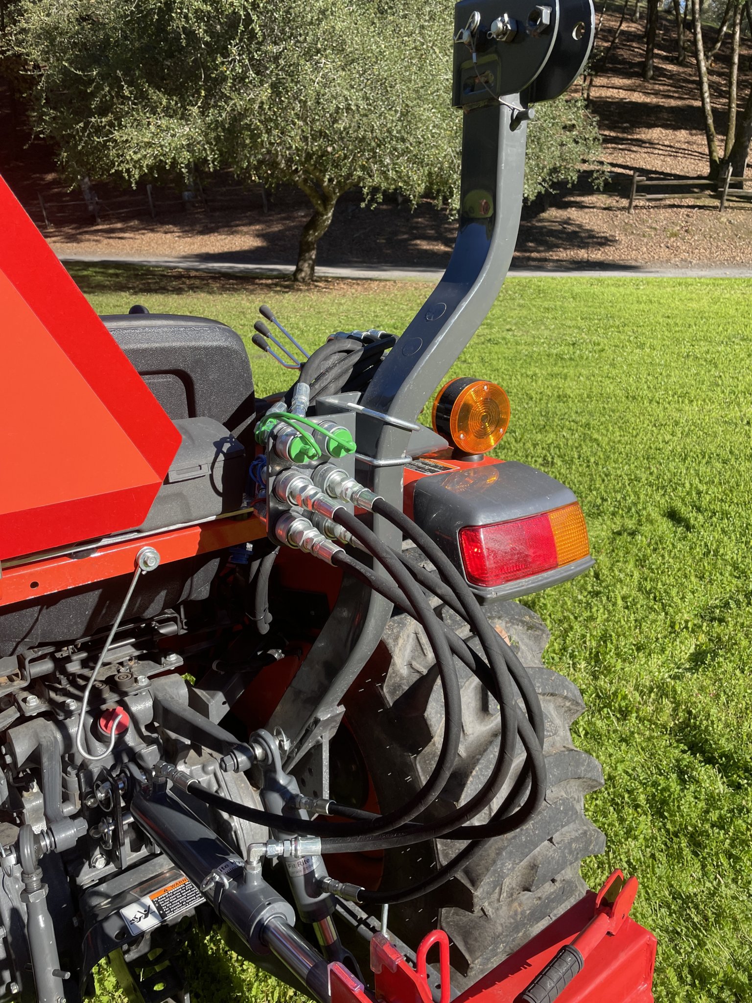

You can hang a three spool valve on the ROPS for $600-$700. I dont have a kit for that but they are easy and I can whip one up in about a month.
