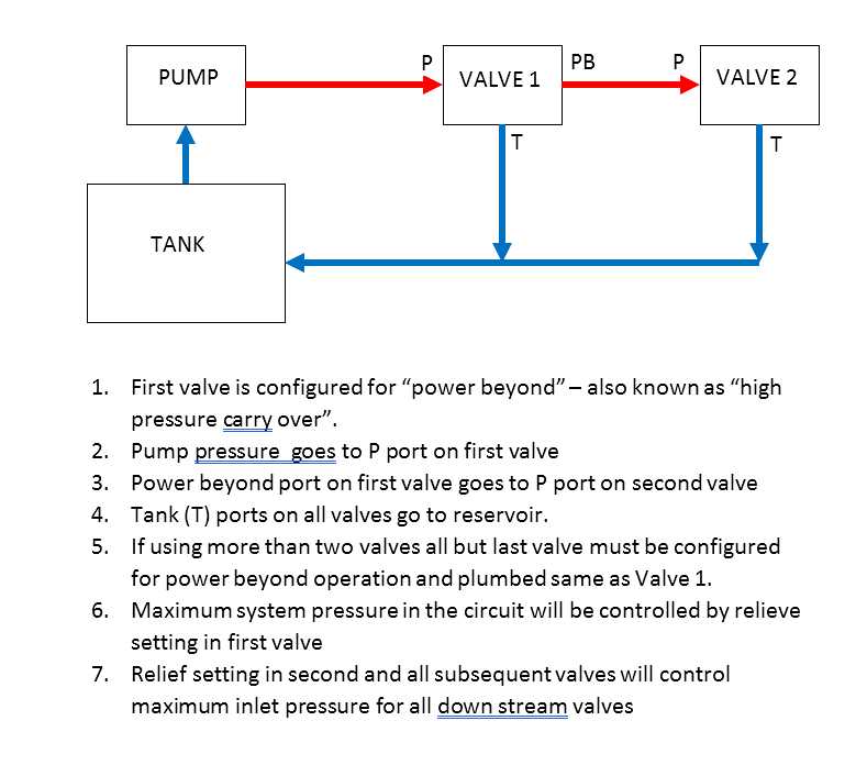

The third function kit you were considering is just a single spool electric valve that is operated by a button on the loader joystick rather than a separate lever. It is the standard configuration for a loader third function like a grapple or snow plow angling cylinders.
If and when you have a need for additional functions you can easily add more valves.
The circuit is just a simple daisy chain as shown below. In your case the loader valve is valve 1 and valve 2 is your 3PT. The electric third function would go between valve 1 (loader) and valve 2 (3PT) and it WILL NOT have the T line. If you add additional remotes that valve would go between the third function and the 3PT and it WILL have the T line. For most people a loader third function and 3 additional remotes is more than adequate.
Awesome, thank you very much

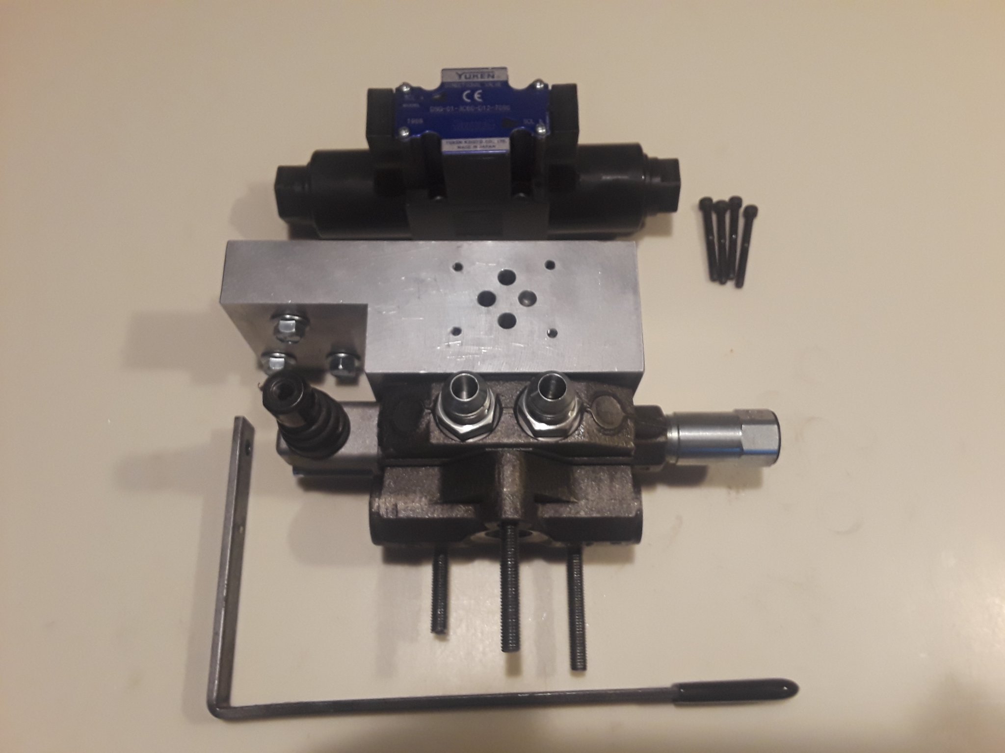

Additional remotes are easy to add and relatively inexpensive. I have done many. Take your pick of an off the shelf directional control valve and add some hose and connectors. Ballpark number of $200 per spool including hose and a set of outlets depending on how fancy you want to get with the couplers.
I just had a nap and I am fresh. Here are some of my pictures.

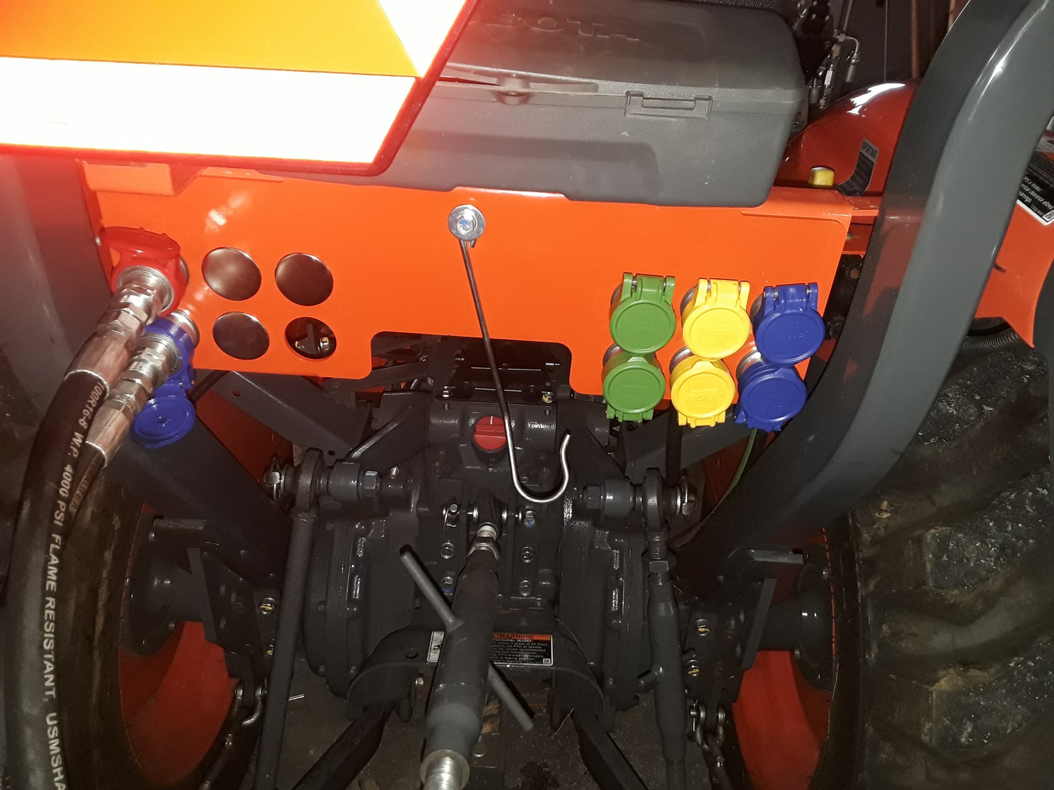

I got kinda fancy with this panel. One hand push/pull couplers with breakaway protection and automatic dust doors but still very affordable and IMO a significant improvement over the OEM offering. The left most set of couplers are constant flow for a log splitter and have their own selector valve for switching the on/off as needed.
Custom hose assemblies add greatly to the fit and finish but get expensive fast if you cant make your own.

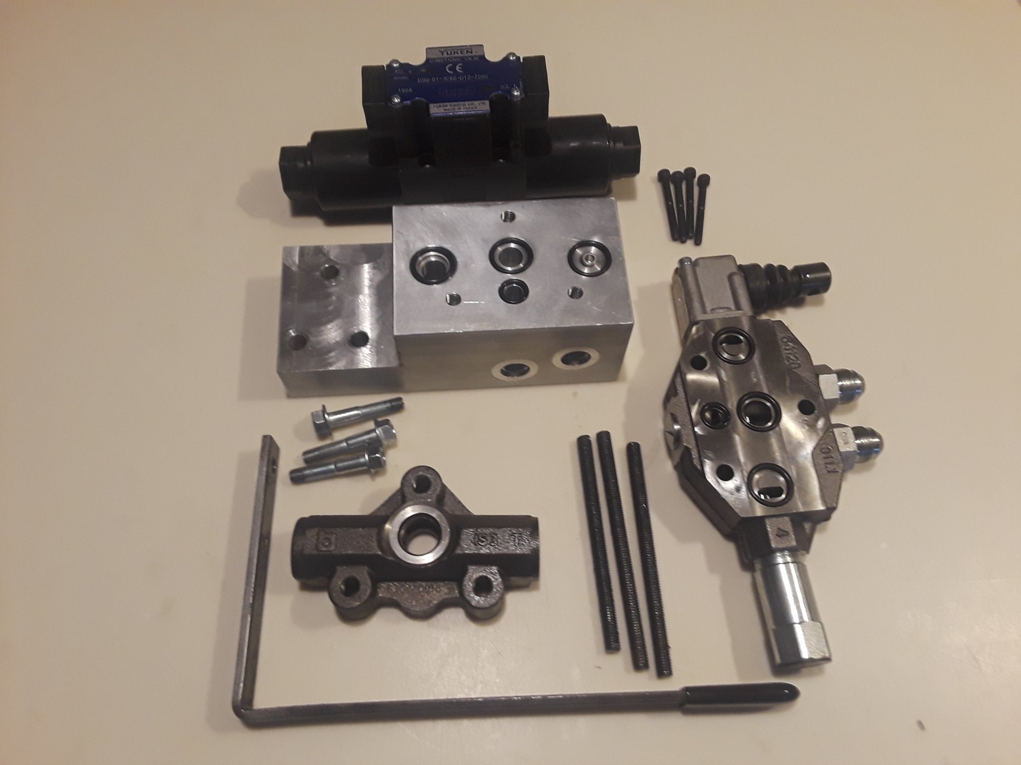

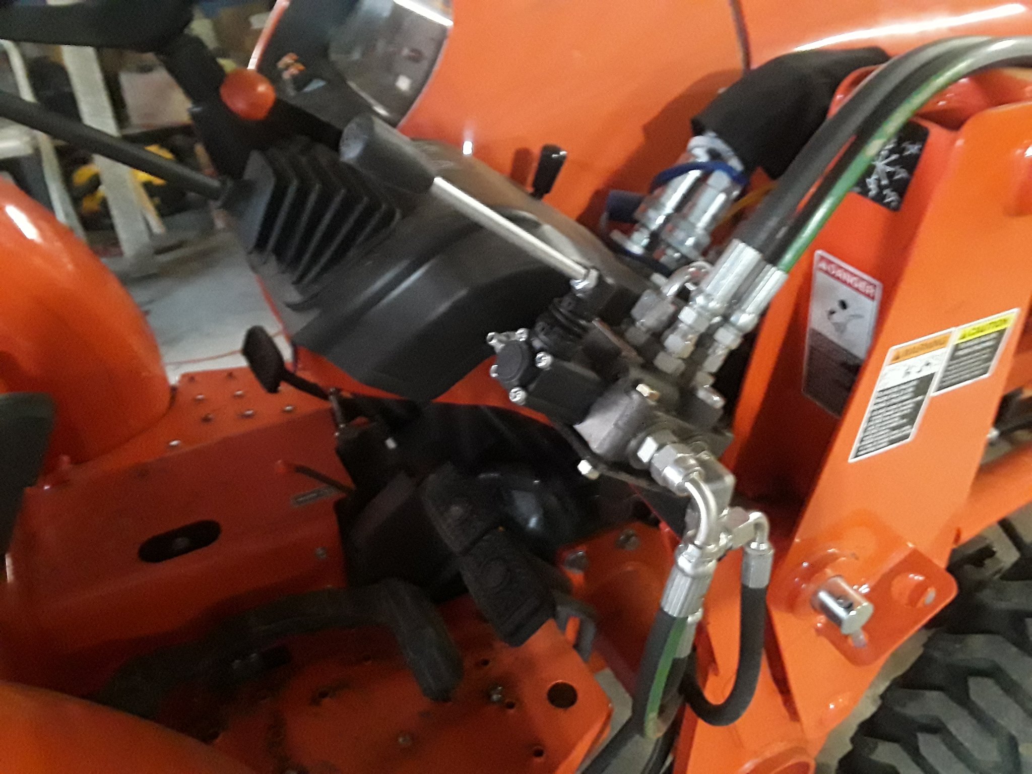

Monoblock valves are a dime a dozen. The little Prince valve mounted on the loader post is my quick and dirty third function.
It will go away when I finish the OEM style sectionals shown in the last two pictures. I have added a mounting pad for an electric third function solenoid valve to my manifold design. That keeps its tucked away under the seat rather than an ugly wart on the side of the loader. Believe it or not the hardest part of that project has been replicating the crazy handle arrangement used on the OEM remotes.

hey Dan, that's just beautiful. Seeing the install on your tractor makes a world of difference. Thank you very much. I'll let you know how it turns out

Thats a lot more than third function!!
Looks fine but if the 3 spool valve is a good one and matched to the tractor hydraulic system it should provide all the metering control you need and the needle valves should not be needed.
I don't see any plumbing or outlets in that kit. Is that all customer supplied? If so if gets pricey quick.
