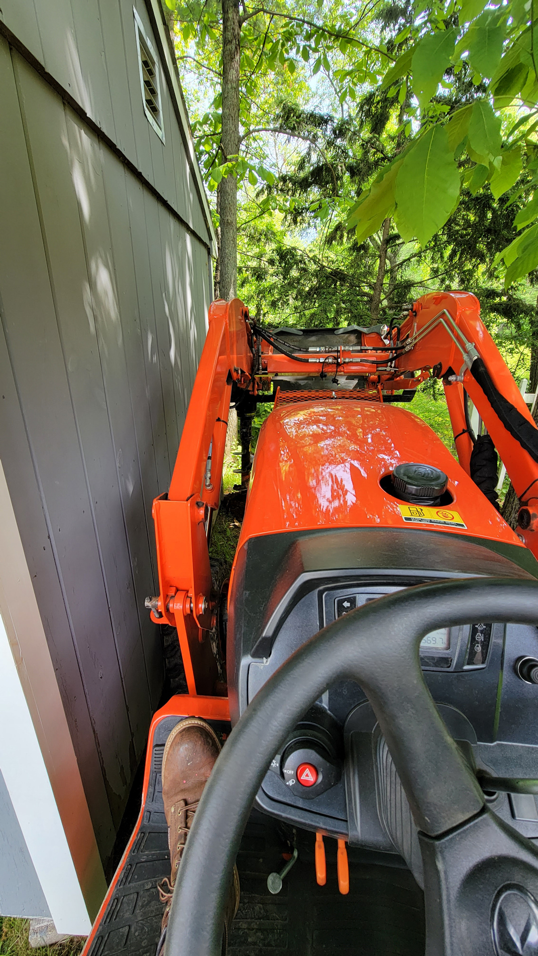

I ended up making my mount because the "centered" design that is great on the skid steer left me without being able to see the drill tip from the seat. I have a friend that owns a fence company and I literally drill hundreds of holes for him so being able to see the tip from the seat was important and being able to get close to an edge was important. I have 2 mounts in each top corner for the drill right or left, and a mount on the bottom center for the mixer setup.

I have never broken a tooth but I have worn out at least a dozen of them (As soon as the outside edge wears to the flange, flip them over and run them again until both sides are round ;) ).
It is funny that you mention the skid steer. My friend that owns the fence company has one. Most skid steers weigh 3 times what the tractor does and really tear a yard up making all those small turns so he doesn't use it very often. Some jobs wouldn't matter (like the paddocs) but most of them would.
At WOT I get 48-49 auger RPM at 1500RPM I get 33 RPM on the mixer (perfect for mud).
For me it is all about seeing the bit/hole. Technique will vary greatly up here. We have from sandy (I have done 50 12in holes in an hour) to granite - we are the Granite State (zero holes per hour) and everything in-between. Also each job is a little different. Some you don't want any shake away from the hole so you let it stack around it, some they don't want the shake too close etc. Undoubtedly though, I have gotten better at it so there is obviously a learning curve there somewhere that I wasn't paying attention to.

I had a PTO unit on my first tractor. I spent more time dealing with a stuck bit than drilling holes and ended up selling the unit. My old tractor also had 9 more PTO HP than my Kubota. Up here they are just more trouble than they are worth if you need to do a bunch of holes.
I also had very little control of the drill angle in the hole with the PTO. After a bunch of holes it also left me with a sore neck and back. With the bucket mount where I can see it, you can actually directional drill easily the length of the bit. I can get perpendicular to a house corner and "feed" the bit (angling in as I go) right down into the hole basically touching the corner without touching the structure if that makes sense?
Just a ton more control, speed, power, comfort, options etc. with the hydraulic unit.
