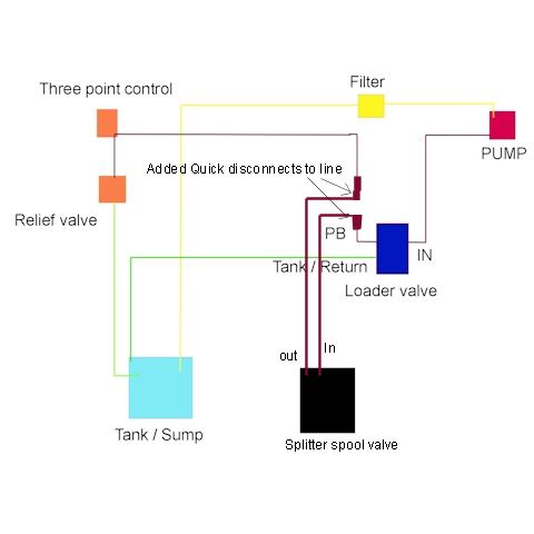

Sorry for the delay in getting the photos posted. Got it all installed and it's working well. Ended up putting a T, with a shut off valve just off of the power out line. The power is great, with more speed than expected. Unfortunately, with the shut off valve, have to disconnect the hose to keep it on the loader, for transporting splitter. This will be rectified, when not in the middle of the cutting; with another valve setup. For now I am very pleased with how it turned out. Thanks for the help!

32,912
8,377
Take the valve's out of the system before you have a tragedy and dead head the setup and blow a pump!
All you need to do it have is a Quick disconnect on the power beyond line and run the log splitter in line on that.
So from the Loader spool valves power beyond port add a Quick disconnect, then on the line the came off of that put the other side of the quick disconnect.
split those 2 lines and connect them to the splitter.
Here is the bonus to this kind of a setup, if you forget to do anything like reconnect the Quick disconnects on the loader, the loaders Pressure relief valve will kick in and saves the pump.
