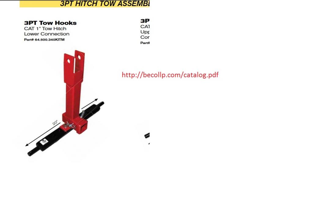

Forum members towing trailers using the 3 pt hitch have experienced sudden problems when the weight on the trailer moved rearward and the 3 pt arms just rose up providing no resistance.
This product, which ties the 3 pt arms rigidly to the upper 3 pt mount, is intended to solve that problem.
Dave
Dave
I have something similar to this on the tractor, I don't know any other way possible to tow with the 3PH without one, but what you describe is not my problem. Mine is when I lower the mower deck, the 3PH lowers as well, and my hitch ball drags on the ground.

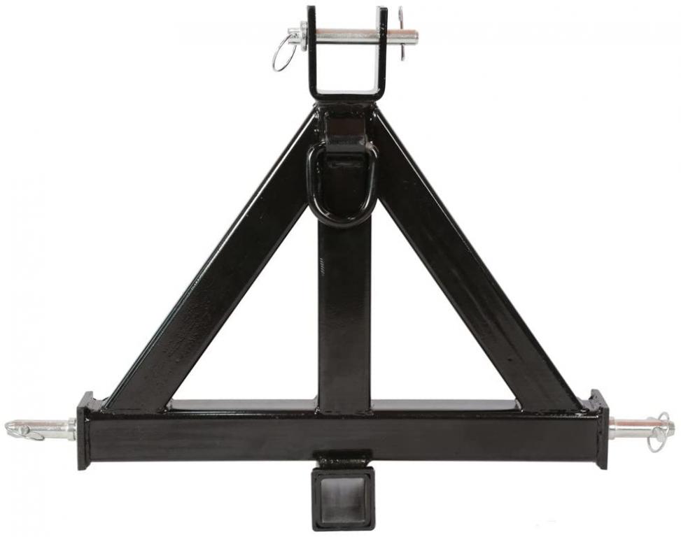

I use this one.
10,193
7,089
Following Dave and SDT’s recommendations, one should not tow certain trailers with a 3PH-mounted drawbar for the reasons they mention.
One can limit the lower level of fall just by using check-chains, but that will also likely limit the fall of your MMM.
I have a BX also. 2 suggestions:
1. Use a fixed drawbar for towing. I bought this adapter plate for a 2” receiver just for your purpose. You can likely extend it if necessary.
2. Get a Quick Hitch. A QH will allow you to remove your attachment quickly.
I have the fixed drawbar for towing, but also like to keep a 3PH drawbar for skidding trees, etc.
Your trailer mover would likely slide right into a QH. Might need a couple $2 bushings.
I attached a couple pictures. Hopefully make sense.

The hitch that mounts on there, and there are a few options, keep the trailer way to close to the tractor for my liking. Just my personal preference, I won't use one to tow a big trailer or my boat.
The problem with quick hitches is there is no "standard" size, even if you get a land pride QH, some Land Pride implements won't work on it, even if it has the label that says it will. I am no farmer, so I will not be changing implements very often, another reason not to invest (though they are cheap) in a QH.

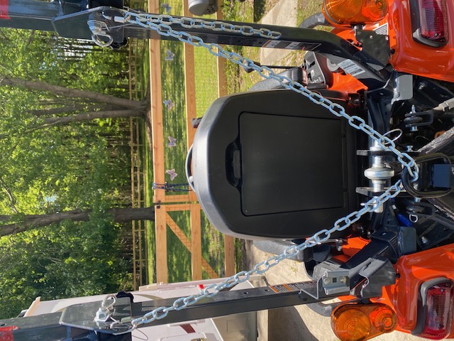

I'll be making a couple of chains with trailer safety hooks I can throw on while mowing. I only move my empty utility trailer and my pontoon trailer, to mow with. Other than that, I don't tow with the tractor, and if I did, it'd be a much smaller trailer like an ATV trailer to pick up manure out of the pasture or bring feed out to the horse stalls. Appreciate everyone trying to keep my from being decapitated.

https://www.tractorsupply.com/tsc/product/countyline-stabilizer-stay-strap-lower
This is 1/2 of a 2 part solution for ford tractors. They go from the tractor top link point to the implement end of the lift arms. The idea was to prevent drawbar from rising and giving a fixed drawbar height (position lever not used when setup this way).
Since you need to use 3pt to raise mower, drill holes in flat stock and use chain between these points.
This will give you a fixed lower limit and still allow trailer movement.

Papa - what I would try is running a chain from one of the eyelets that you would pin the 3PH to, to you draw bar. Maybe a little shorter?
Just throwing out an idea.
PapaJ
L2501 HST
Apr 28, 2020
284
107
TX
This would hold the 3PH down. I am trying to keep it up.
