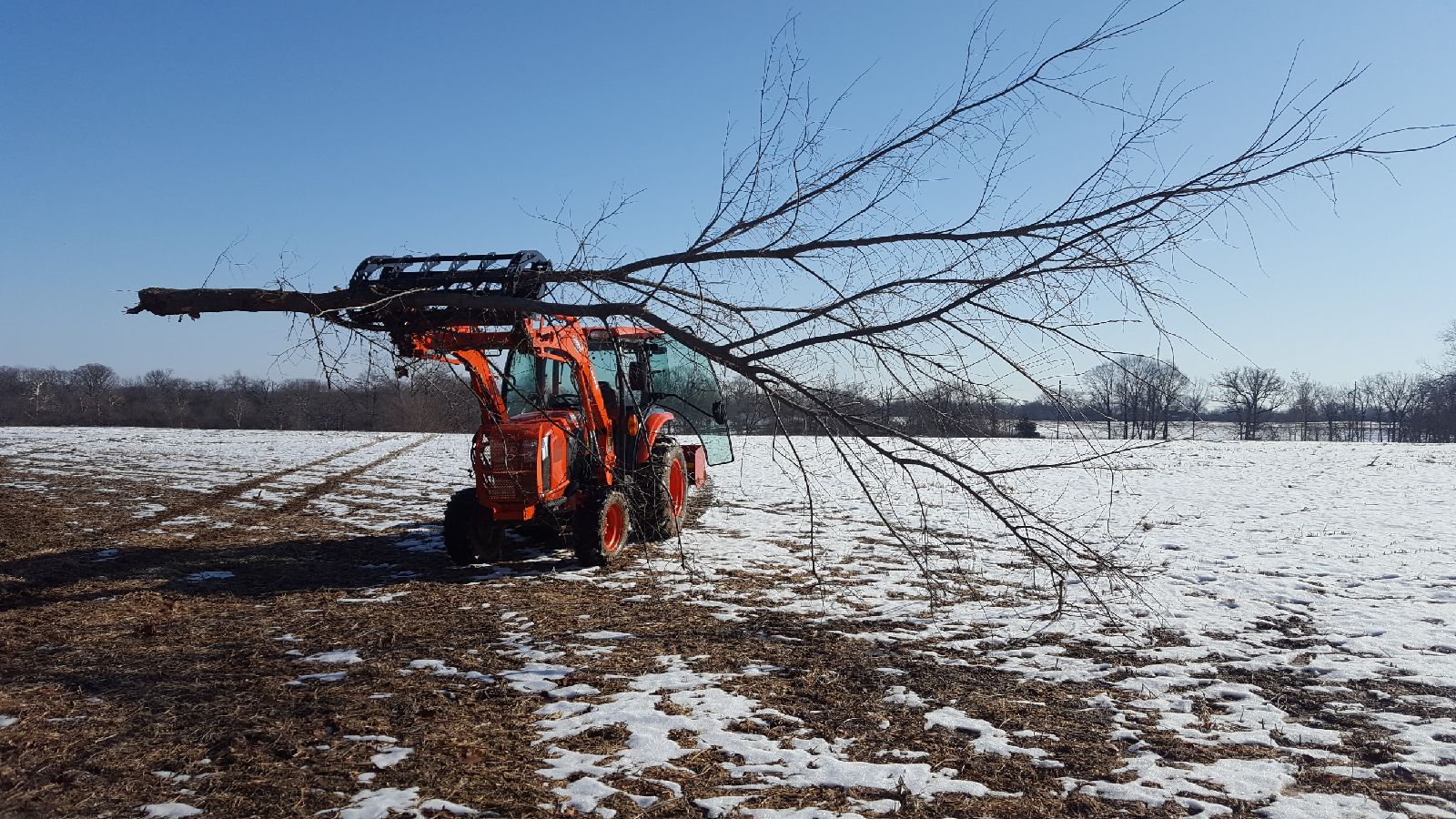

That is actually somewhat hard to believe but an excellent reference. I clear about 1/2 an acre every winter to cleanup during the spring and I get some logs my 525 won't lift. I can sure scoot them anywhere I need to go though!
Some pictures of the L3560 and loader work

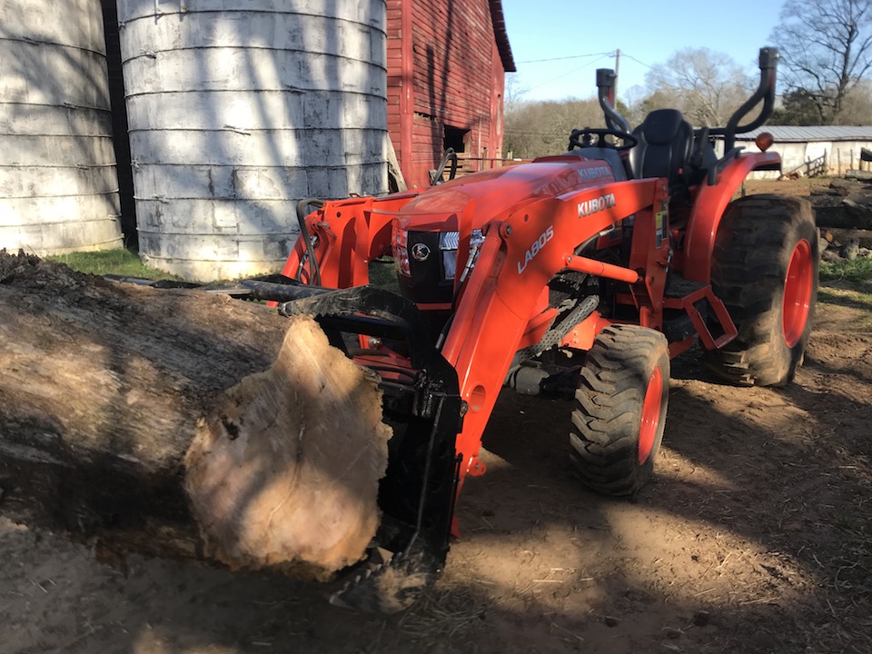

If you ever spend a little time on Grand L it'll ruin you. Our son has two. He looked at lots other stuff before buying the L4060 as a backup for a loader tractor, he just didn't want to downgrade from all the features and creature comforts of the Grand L. His L3940 now has well over 2500 hours. These Grand L's have a little butt to them than the MX, son owned an MX5100 once, great tractor they just need little more weight in the rear., ballast is easy to add though., not the reason he got rid of it.
These were moved with no extra ballast but loaded rears. 5' long Oak been down for quire a while.
