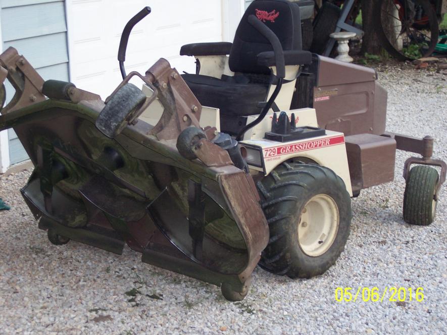

14,171
6,297
We've had a 0-turn for about 10 years, and usually mow about 3 acres, but sometimes more.
My wife does all the mowing, seeding, fertilizing, leaf mulching. It's relaxing to her. I've probably operated the mower less then 5 minutes in all that time. I do the maintenance, and stay away from the yard!
I have mowed segments of the same yard with various tractors just seeing how a mower or tractor runs. I've mowed with a B6100 and belly mower, and also 3-pt., TG 1860 with 54" belly mower, L2050 with 5' Landpride FD2560, B7100 with 60" deck, and probably a few others.
The mowers all mowed nicely. The Landpride FD2560 really is a nice mower for a large open area, as is the B7100. Turning is the time consumer! The TG 1860 is very close to a 0-turn because it has power steering and can go around a 12" tree in one pass.
The 0-turn is in a class of it's own. No mower I've used comes close to it's cutting speed, and it's quality of cut is as good or better then any of them.
I have a dealer 30 minutes away. They have all the serial numbers necessary, so if I need a part I can call and they know quickly if they have it, and can even tell me the last time I may have replaced it. (like a belt).
One of the biggest benefits is ease of maintenance. I can remove and sharpen (or replace) blades, or clean the underside in a few minutes.
29 HP with a 62" cut is entertaining to watch work!
Buy a good one if you go that route because your mowing time will be reduced greatly, so engine hours don't accumulate very fast. It will last a lifetime, if you want.
The Grasshopper with the Powerfold deck, in my opinion has very little competition.
