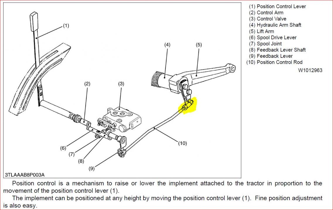

The feedback rod may help if the lift arms are limited in the height they can attain. Adjusting it can allow for a higher angle.
But if the lift arm goes higher with the disc off than on, then it is more likely a different issue.
It appears that there may be an adjustment rod on the spool (in the center of the cross shaft). You may be able to adjust that little rod to get more hydraulic pressure to lift the disc.
