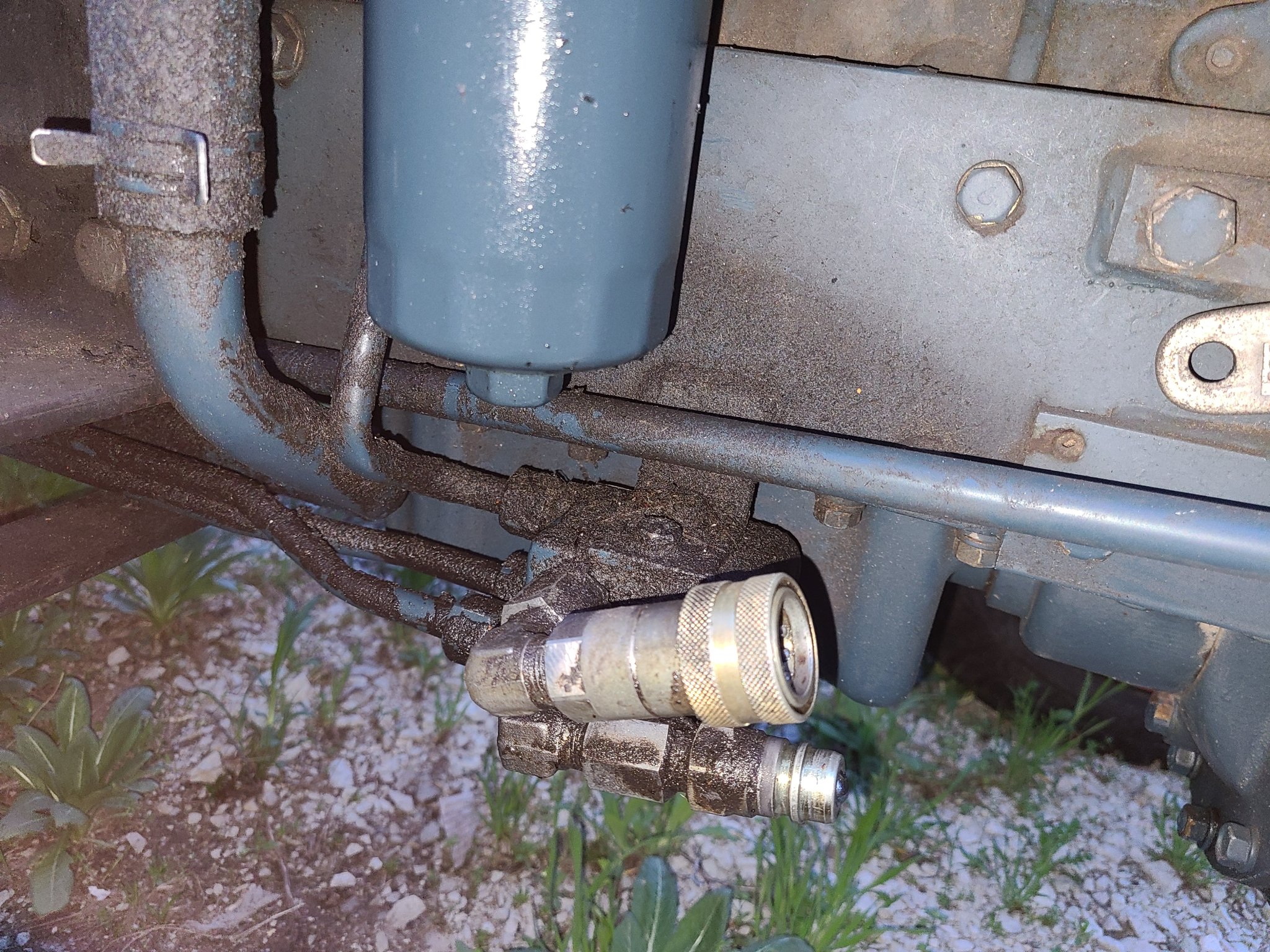

There is a selector valve (slotted head shaft) on the side of hydraulic block just under the fuel filter housing, any chance you could give us a picture of that?
It does have a loader but it currently off, and I will take a picture tomorrow.

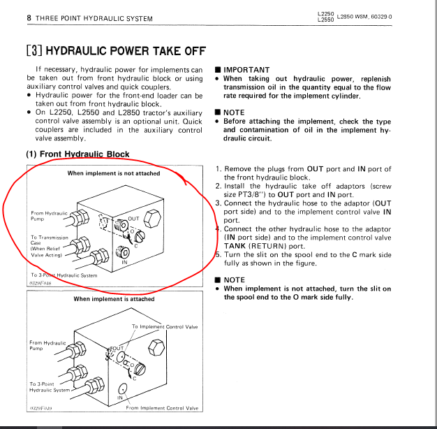

Sorry it took so long for this pictures
The last picture you put up, in the center of that block is the valve.
turn the selector to match the red circle.
I will give that a try tonight it would have been nice if the dealer told me about this by pass. Luckly this has been a year I didn't need her to plow the snow. But this Will be tried before the rebuilt bucket is going back on. Thanks!!!
