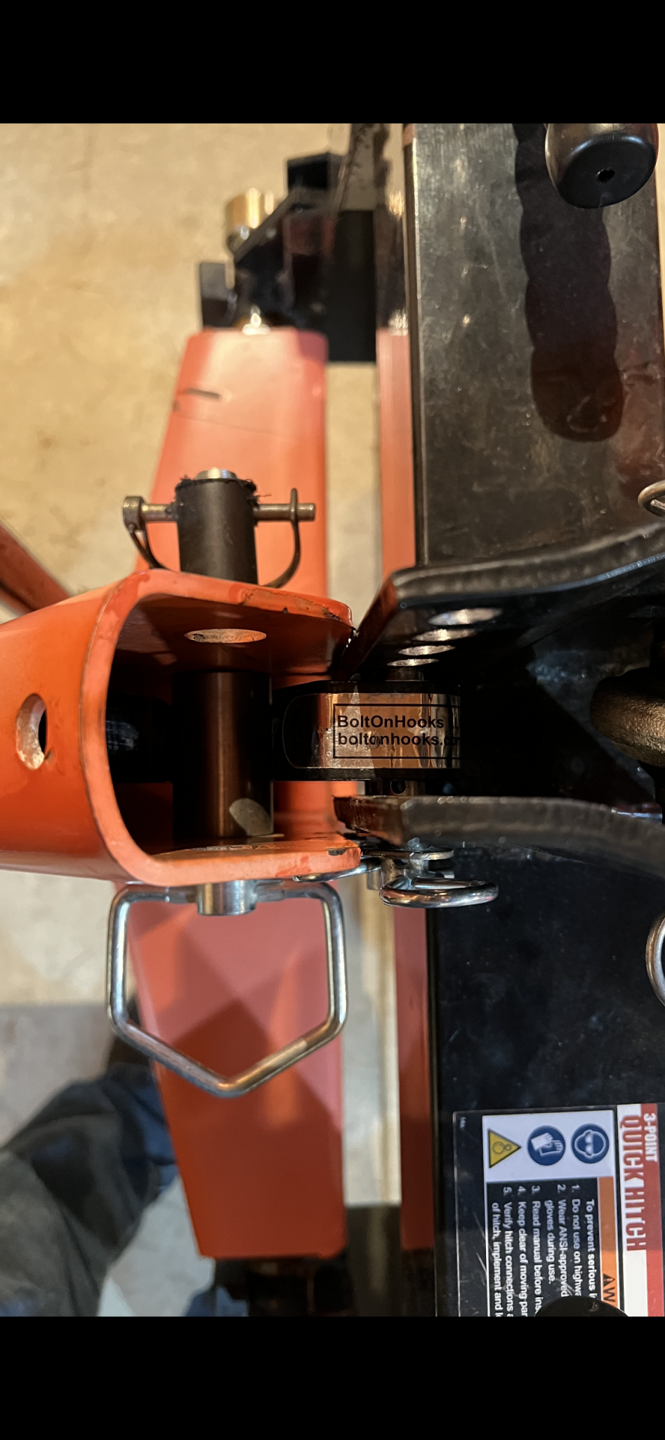

O have HF QH for my 3301 I just ordered the replacement upper hook on Amazon https://www.amazon.com/osemar-Harbor-Freight-Quick-Hitch/dp/B08W4X6TJT
I have the lower pin issue resolved . I have LP Box scraper & a LP rear blade . Will I need one of these adapters for use with m Rear Blade https://www.amazon.com/dp/B0899K8VMH/ref=emc_b_5_t
thanks
animals45
Do you have the second set of holes on the LP blade? If so drop your hook and drop the pin into the bottom hole. You should be ok with some adjusting. Looks like either way you'll have to manually move or unhook something when changing implements. Its still a heck of a lot better than not having the QH. I have to move my hook between my rear blade and my box blade. I have the HF QH and the extended top hook. OR you can purchase that part but you may have to take the hook off anyways.. might be in the way.

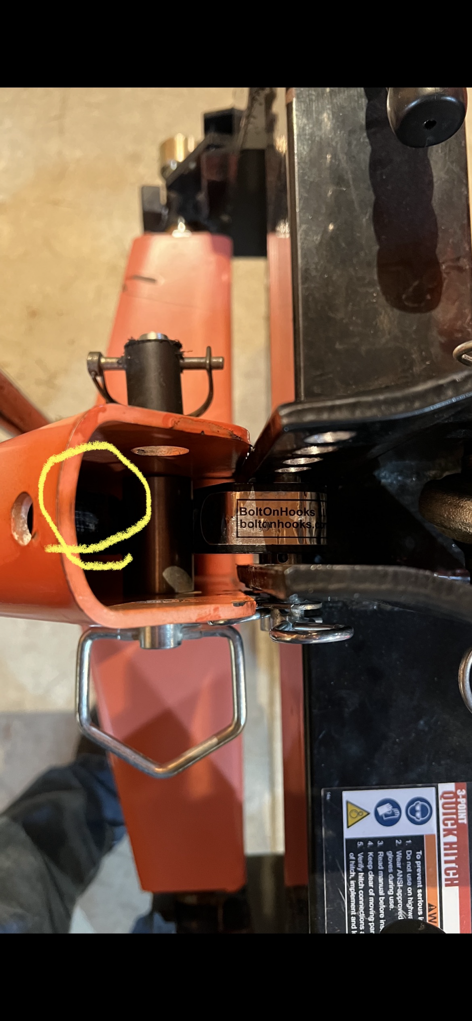

Also forgot to mention that someone else on here cut the metal out of the LP top of rear blade implement where he could use the upper holes. This area \/
Once you get the hook you can get it figured out.. one way or another hopefully without having to change anything.
