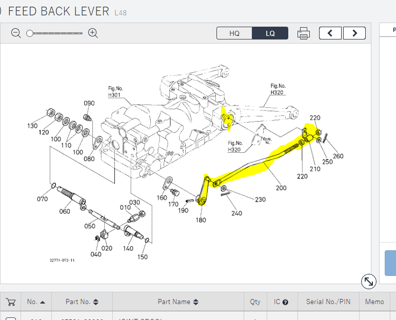

Have you checked the feed back linkage?
that ot being on or mal adjusted will stop the three point operation in it's tracks.
