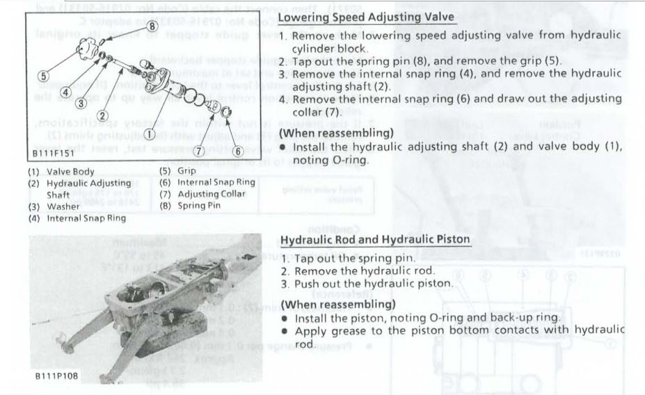

Okay, it seems that the 3 point lift cylinder is leaking and that is causing the bounce issue. It is getting worse. In fact, I even closed the drop spped valve and the mower still hit the ground in less than 30 second after the tractor was shut off, from the full up position.
Wolfman, what all needs to come apart to have this cylinder repacked? Do I need to pull the 3 Point lift arms off the back, ir is everything under the seat and under the top cover?
I either need to fix this quickly or nurse it for another few weeks.
I assume that once the cylinder is out it is just a matter of having it repacked at any hydraulics shop, correct? Or do I need to go to Kubota for specific piston seals?
Being a 2-3 job in difficulty, about what is the labor time. I am mechanically inclined, but I know that it usually takes a little longer if you have not seen inside at the inner workings before.

I rebuilding the lift cylinder really this simple???
I just thought that the mechanics of a tractor hydraulic system was more complicated than this. What is the manual not telling you?
Should I just get new piston seals form the Kubota dealer, or take the piston to a local hydraulic shop for repacking?
Also, what else should I do while I am in there? Rebuild position control valve?? Or is there really nothing else in there at all or that rarely needs attention?
Thanks.
33,391
8,705
Sorry for the late response, computer (satellite) went down in a small but sticky wet snow storm last night.
Yes it is that simple.
I would get the seals from Kubota.
You could put new seals in the control valve while you're in there, I would also see about new seals/ O-rings in the speed control too.

I pulled the top cover of the rear end to take a look at the hydraulic piston. I discovered that the main o-ring was in tact but well worn. The backup ring (The stiff plastic one that wraps around the piston twice) was missing quite a bit of material in that it only went about 2/3 the way around the piston. Now that it has been resealed, I have not had an implement at the house to attach to it, but the arms are no longer falling overnight as they were before. I will know soon if this fixed it for sure or not.
Wolfe and others, thanks for the help.
