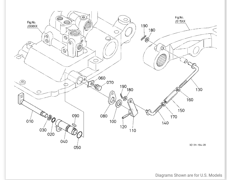

So is that part # 140 in the diagram? Adjust it how?
The WSM desctibes the adjustment but I dont think thats the problem. The jerk upward is feedback diung its job as designed. Its raising the 3pt to compensate for leakdown in the lift circuit.
As suggested the leakdown is commonly caused by a leaky piston seal. Unless you are having operational problems simply ignore it.
Sorry that was so small and wrong. Yes, loosen 160,170 and adjust 150 until the twitch stops. I am unsure which way to adjust.
Also, check 190 clips are there.
Dan may be correct also.
