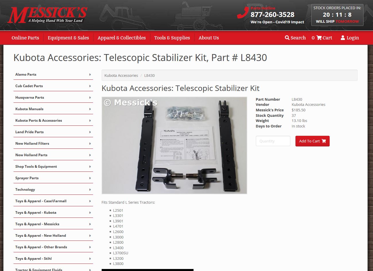

I solved all my rear stabilizer issues by fitting these telescoping easy adjusting rear bars. These fit your Tractor. They make life much easier for attachment mounting and operation.

Your local dealer can get them too and probably save the shipping.

Will these fit the L4060? I bent my turnbuckles in less than one week of ownership (to be fair, I had to break something). Now that it's christened, I want something better. Messicks model list doesn't seem to include the grand L.
