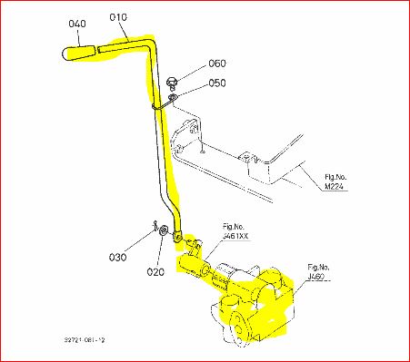

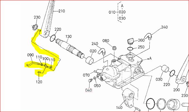

If your sure that the selector valve (back hoe to three point) is moving properly and in the proper position then I would check the feed back rod, it attaches to the right side three point arm.

The feed back rod is moving with the operation on the three point arm, but I do not have power to lift the arm with a load. Lifts fine without a load.

What about the hydraulic change lever?
Move it back and forth several times to make sure it's in the 3 point position fully.

The hydraulic change lever moves up and down freely and appears to be in the full 3 point position. If I place the change lever in the down/back hoe position the arms do not rise.
The feedback rod connected to the right arm has an adjust that can be made by loosening two nuts. Is it possible that the feedback rod adjustment should be shortened or lengthened?

Sadly more and more it's sounding like either one of 3 things, Pressure relief valve is stuck open, The three point valve is got a problem and sailing, or and most likely it has blow a seal on the piston.
Get the three point arms up (with no load), and put some weight on them
like stack a board and some bricks on the board, if it drops when you put weight on it running or not then it's most likely a seal on the piston.
I say most likely as trash in the valve could be causing the issues too it's just not as likely to have the same symptoms.

When I had the arms up by operating the position control lever and applied downward pressure, the arms dropped while the pressure was on and back up when the downward pressure was released.
