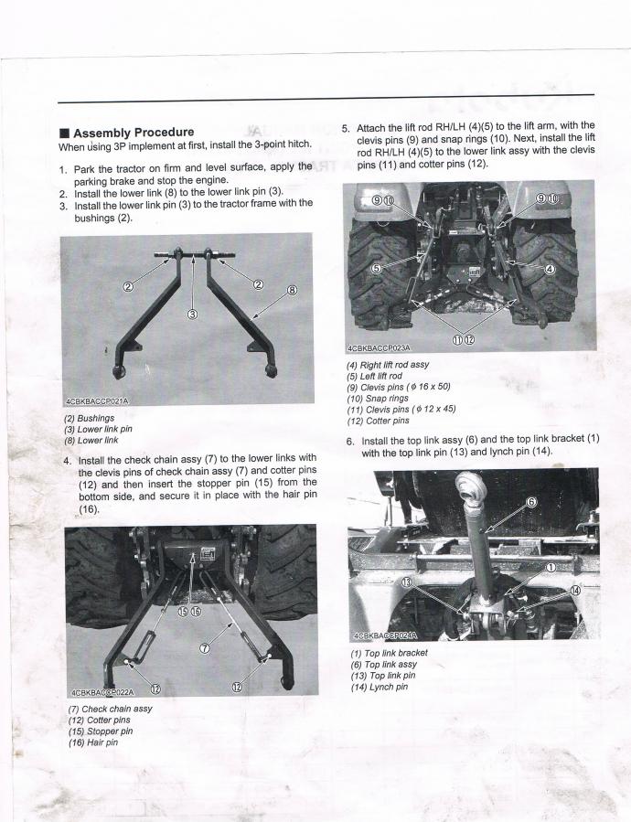

On the question of whether the turnbuckles should be on the inside or out, I just installed the three point hitch on my new BX 25 (by the way, is it wrong for a grown man to be in love with a machine??).. Anyway, on my unit it's an inside job. I've attached a scan of the assembly instructions.
Bob
