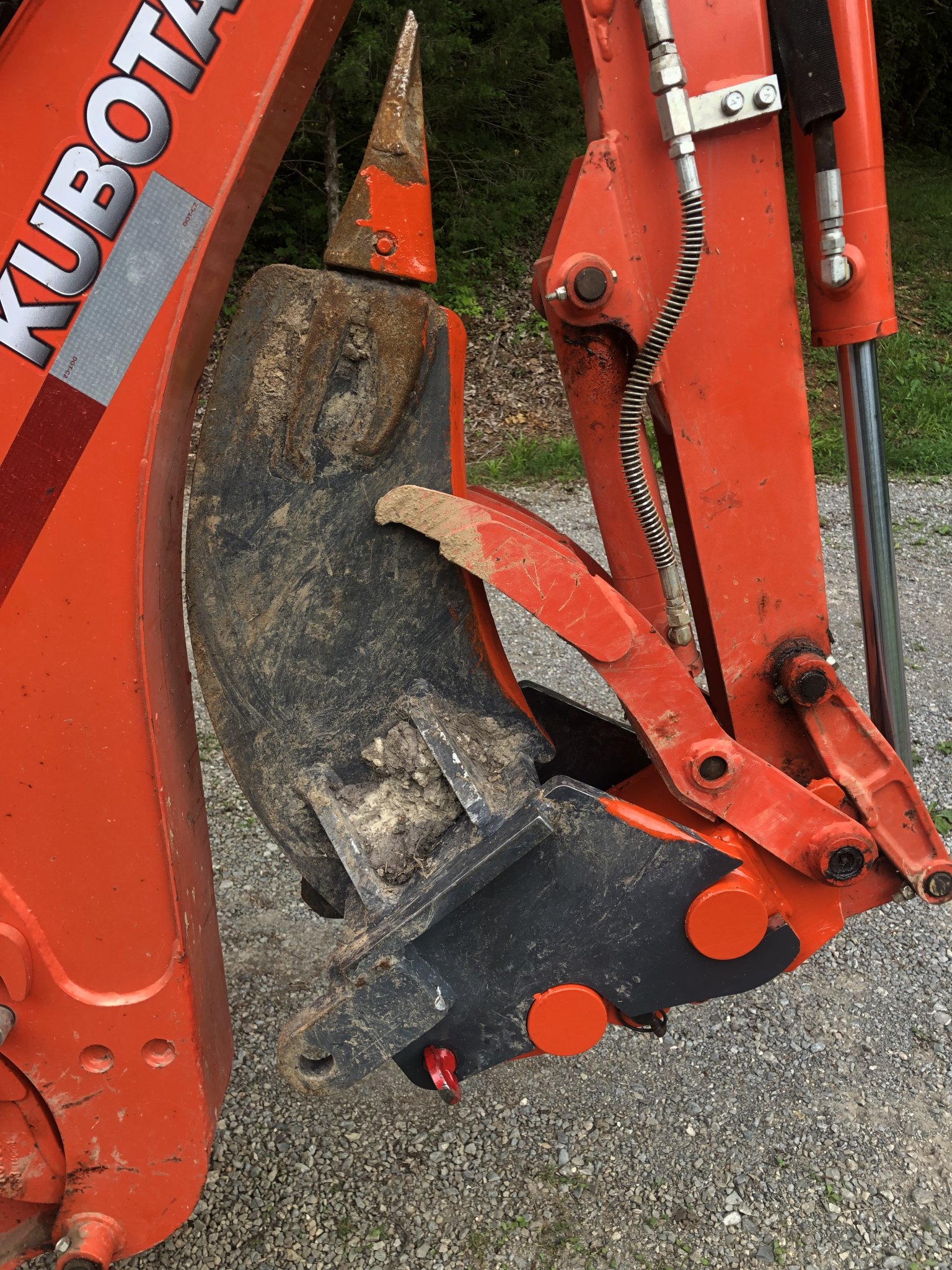

Have yet to find a ripper to fit B26 QA. Some manufacturers will sell you the ripper made to add your own ears.

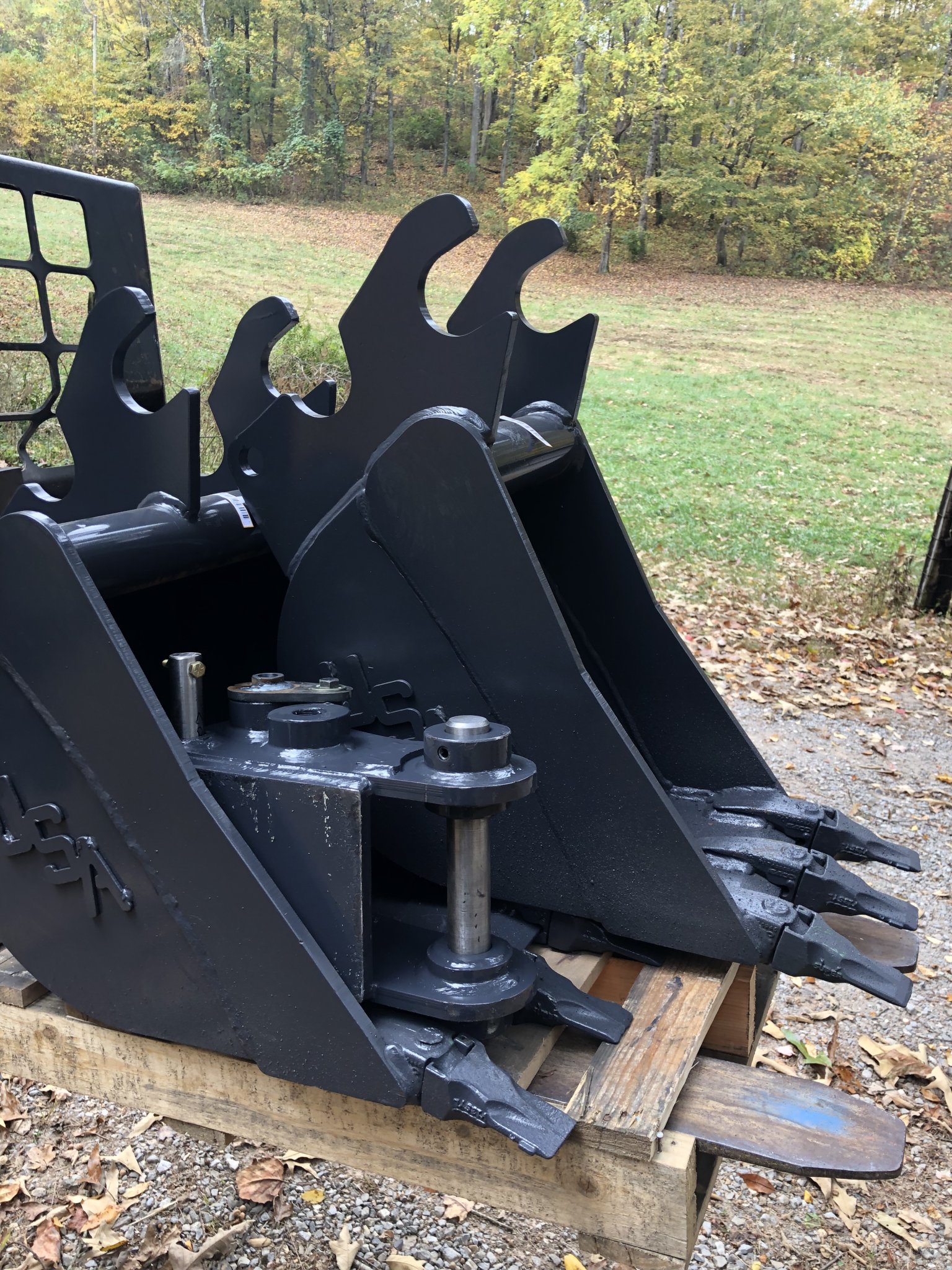

Just ordered a ripper to fit the M59, KK-mini-excavator QA mount from USA attachments. Bought buckets and QA from them before. Studying to maybe use the B26 ears to make an adapter to use the Kubota miniX buckets and ripper on the B26? Kubota miniX buckets are much more available. The B26 QA nests inside the KK QA. Only obstacle is checking for clearance of the thumb linkage while keeping the geometry close. Need to pursue the idea a little more. Ripper is not that heavy, 150#, 22” by 1” thick shank.

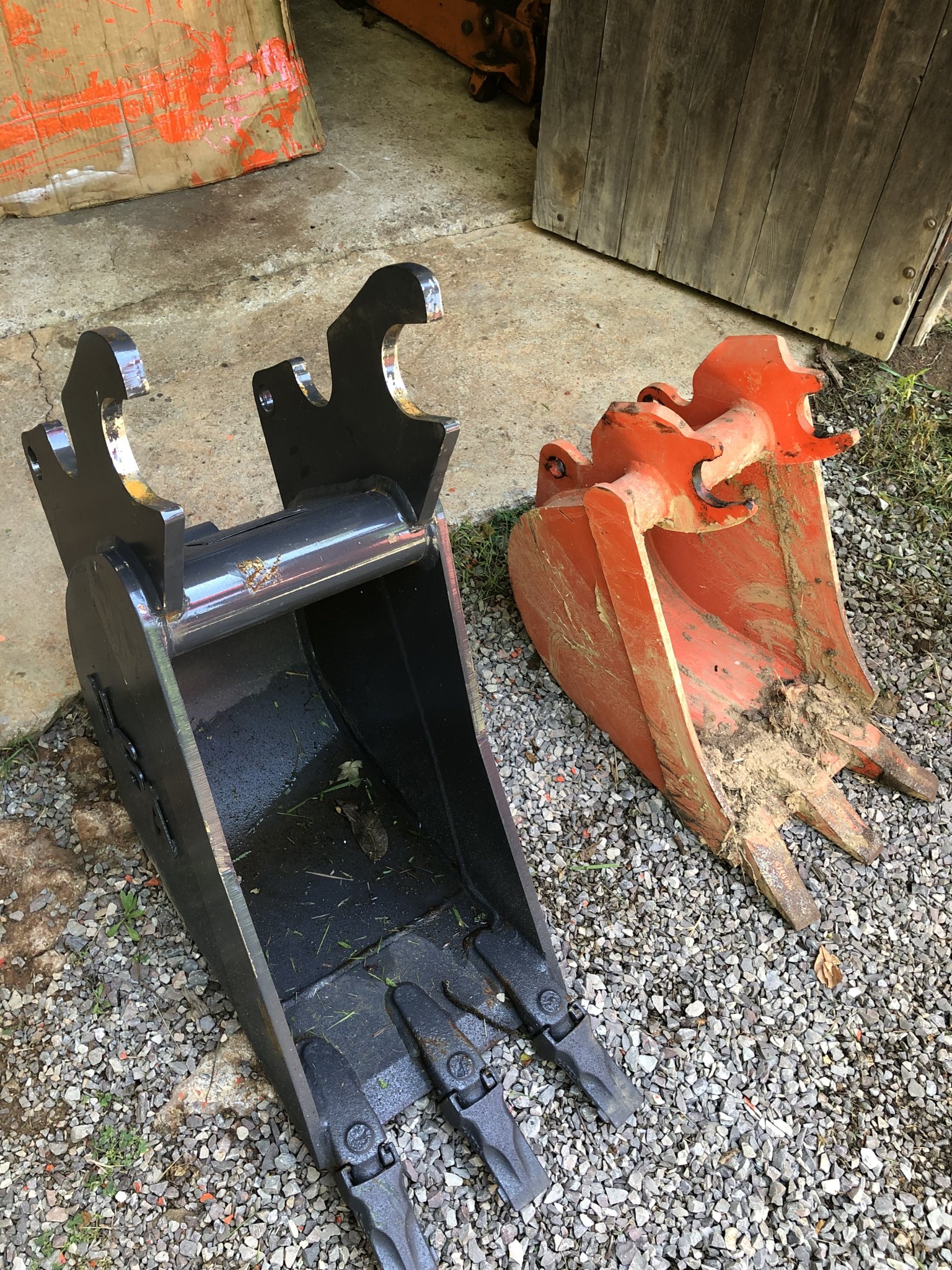

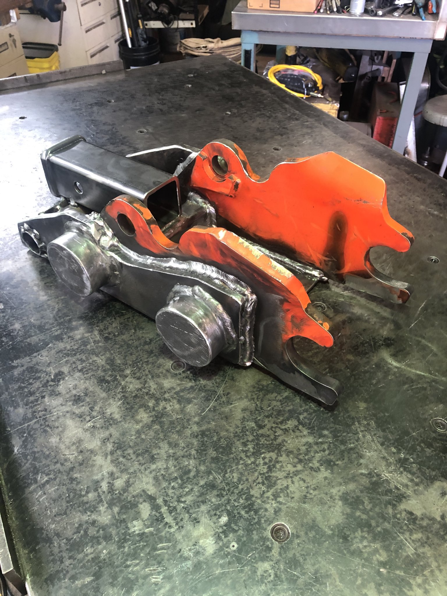

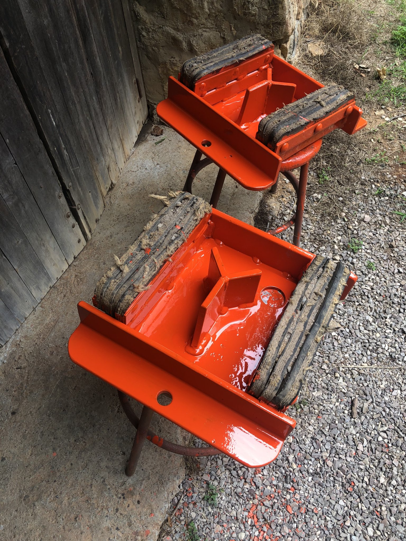

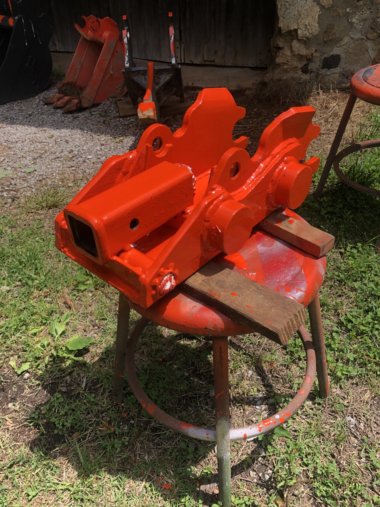

Did make an adapter to use KX 40 quick attach attachment on the B26.
Compare 12” KX and B26 buckets

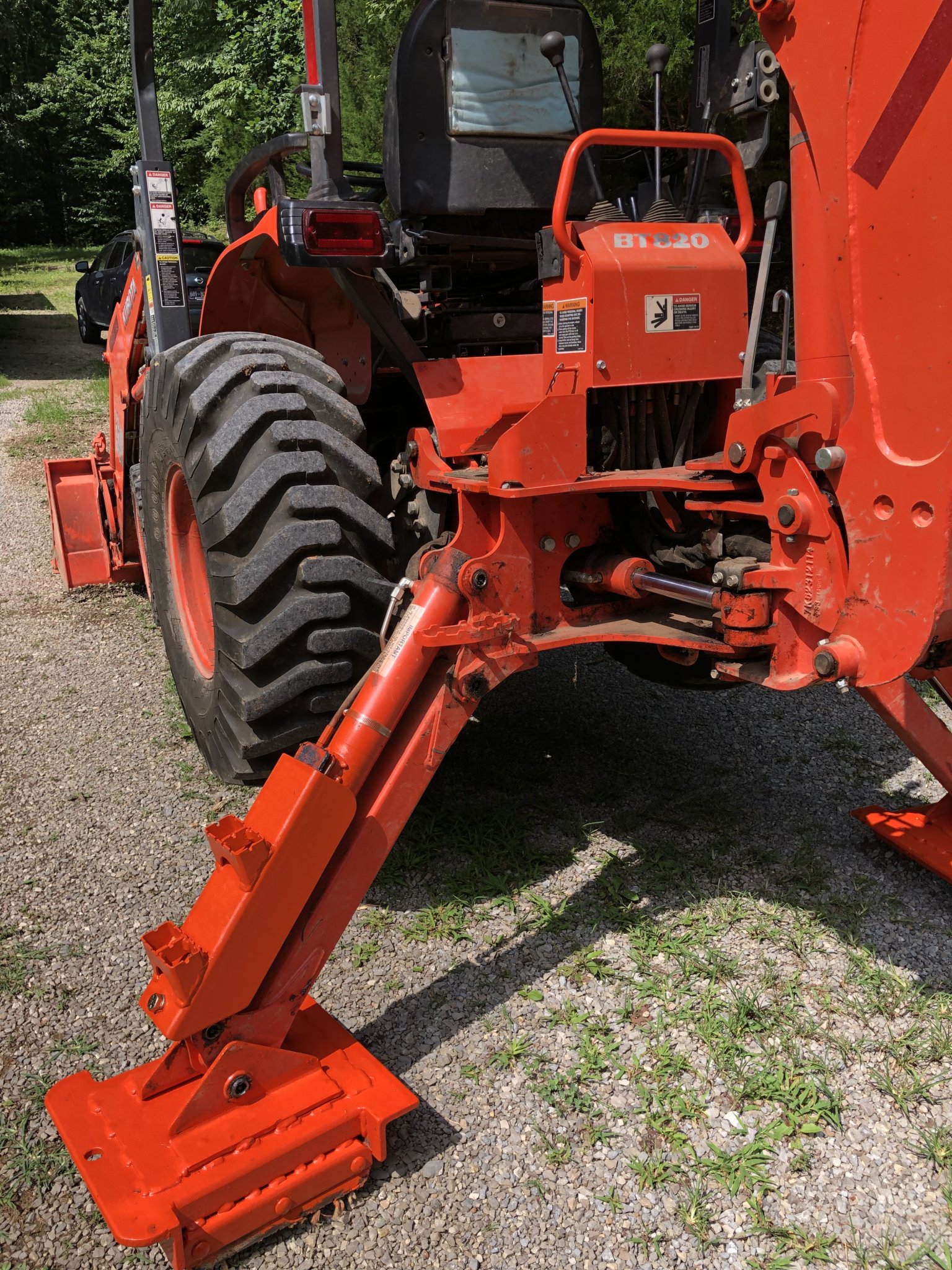

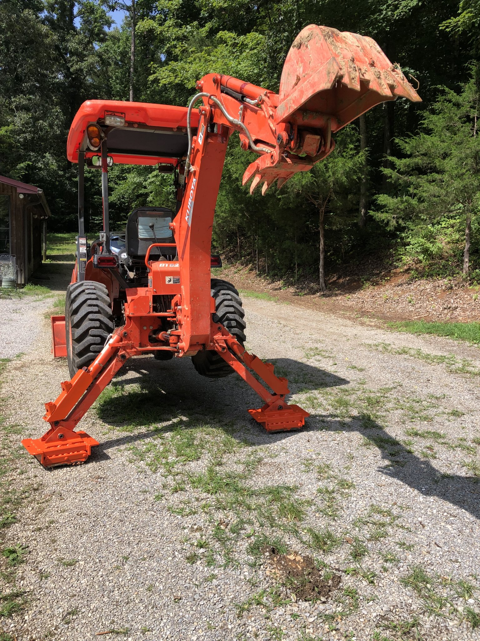

Made bigger, taller outrigger pads and cylinder guards with steps.
Out hillside farm benefits by having more range to plumb the backhoe. The optional OEM rubber pads grip amazingly well.

View attachment 138101 View attachment 138102 View attachment 138103 View attachment 138104
Made bigger, taller outrigger pads and cylinder guards with steps. View attachment 138107 View attachment 138108 View attachment 138109
Smokeydog, the pictures and info are greatly appreciated. Thanks for your help!

Reference previous photo. Not a huge difference between KX 040 12” bucket and B26 12” bucket. KX bucket about $300 cheaper. So maybe the smart money for an entrepreneur fabricator would be to offer single adapter that allows either pin-on or QA B26 backhoe use KX mini attachments. Sell the old bucket(s) to cover most of the cost. Used B26 buckets are hard to find. . Sold my M59 pin-on bucket for nearly the cost of a new better made KX bucket in two days. Guy that bought it been looking for over a year.
Like our L48 and M59 KX QA opens a much larger inventory and lower cost optional attachments.
