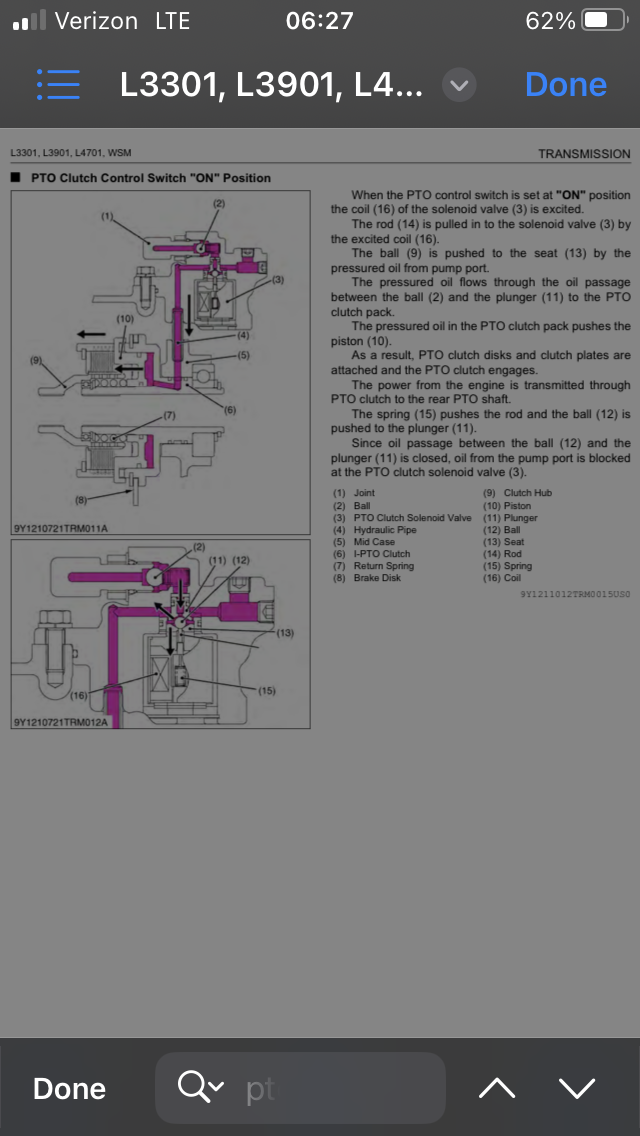

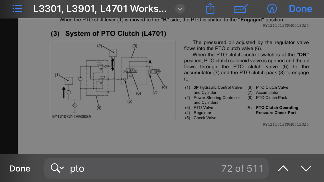

1) If you don’t have a WSM, get one: https://kubotabooks.com/AutoIndex/index.php?dir=Tractor Owners Manuals/&file=L3301, L3901, L4701 Workshop manual..pdf
2) A brief review led me to page 3-M12 through 3-M14 for an explanation how it works. If it isn’t clicking it sounds like the solenoid isn’t kicking in, so I’d start on the electrical side of it but with a meter rather just replacing parts. Past a link to the WSM and the below excerpt from it, I’m of little use. Never been into that part of mine (and I’m good with that).
View attachment 108947 View attachment 108948 View attachment 108949
Excellent post by NCL4701. This level of detail can't but help.
