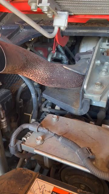

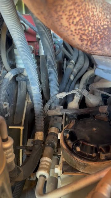

Here are two videos, one at min throttle and the other at max throttle. Both close in on the area that the hissing is most prevalent and where it appears to originate.
Links updated:
I can operate the unit, tracks and loader, but it is clearly under powered , and has trouble climbing even a slight incline.
