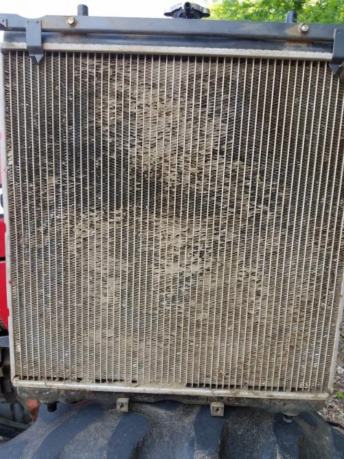

Picture is a good example of mowing debris.
What won't blow through or wash through and is stuck in the fins. One suggestion is to soak the radiator in a flat tub filled with water and Dawn. Use a hose to periodically wash out the loosened debris. It takes a while. Really stubborn stuff use a flat brazing rod which fits between the fins without destroying them.

Take a pressure washer and clean the radiator (after removing the screens).

That radiator was amazingly clogged. You are lucky it didn't fail. I new one is around 500 bucks.
Bet she works good now. You need to stay after the radiator. I clean mine daily when running hay, especially when bailing. I tend to blow it out with compressed air and use my pressure washer with a wide fan tip weekly.

The radiator is soaking in a tub, with occasional rinses. Will probably put it back together tomorrow if it doesnt rain.

A handful of 10mm bolts, slid the fan shroud back, and took it out the left side. Wasn't hard at all. I wanted to flush the block, but we have no water or power where we park everything, makes it a PITA.
