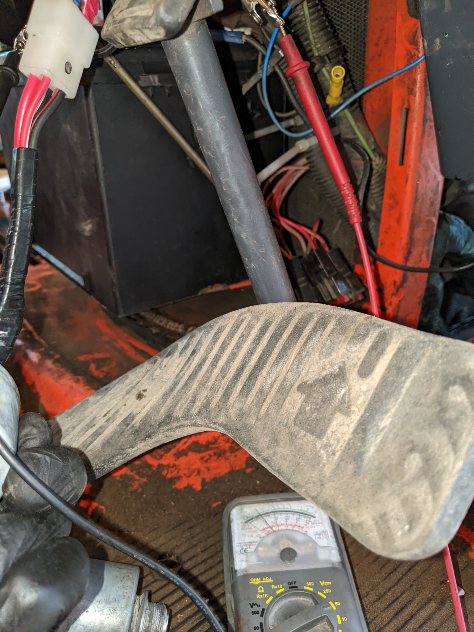

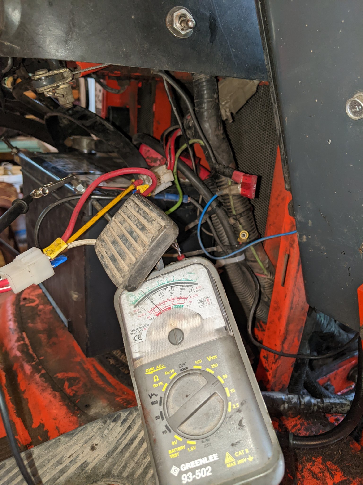

I will clean up the wires do the little job then pull the wheels and test continuity to both switches. I still wonder about the connection at the key to that green wire. Will check that further too as it was suspect as soon as I noticed it came out so easily. Not sure how to address that issue aside from changing the entire connector... pita that.

Thx. Did what I could. Doing the job the later, the wheels come off and I'll hopefully find the issue. How do the wires go ba

That looks good. Did your battery charge up enough to start it today?

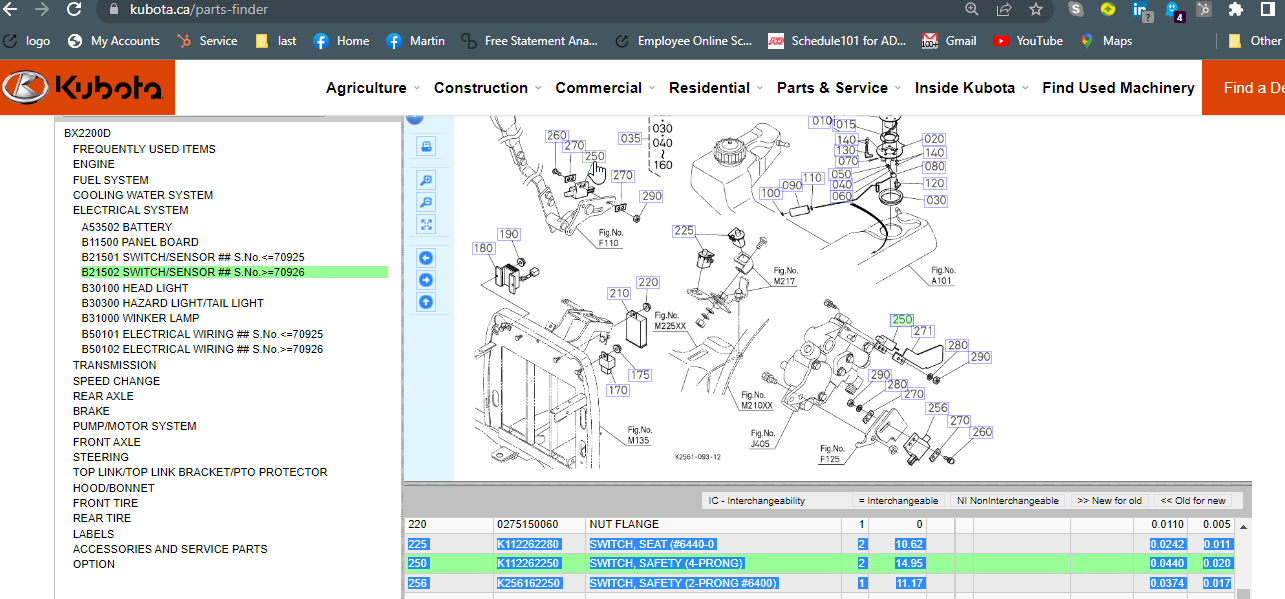

I just finished all the work and put it away. Need to eat then will have a look or will check early in the morning but have to leave by 9:30 a.m. Gone after that until Friday and will either check then or during the weekend. I was thinking of picking up the switches as I can pass by the dealer and they have them in stock. If I don't open / need them, I can return them. Don't know about that black wire yet. I had the starter out there is only what we see the white one from the back and the connector next to the battery. Maybe I'm not following you. thx!

thanks; so I checked with the meter, spare switches, even a new key assembly (for testing purposes) last night and this morning and there is power on that green wire at the ignition and getting to the safety switches when I turn the key. I took off that cover as requested and there's nothing there. I also connected the switch with 4 jumpers to be sure the contacts were connecting to the keyed switch. Since I'm doing this alone, I wanted to take a moment to thank the guy who invented the alligator clip... sorry for the lousy pics but I just wanted the reader to get the idea.

Maybe I am dense, but do you know what terminal/connecting points on the relay/socket are connected to the contacts, and which are connected to the operating coil?
I have the impression you are just shooting in the dark, rather than doing logical troubleshooting.
You should be able to activate the relay manually, and see if the starter turns. You even should be able to activate the starter solenoid manually directly, and see if the starter works.
Not rocket science...but my head is spinning trying to follow the logic of what you are trying to do.
A weakness on my part I guess...
