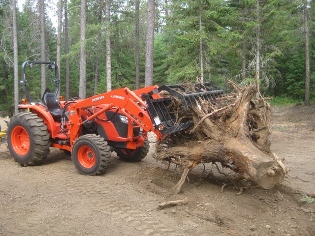

I have almost 11 acres which were all heavily wooded with pine trees (lodgepole, Douglas fir, ponderosa, grand fir). I thinned out about 3 acres around the house.
I started with an L3901 but ended up getting a MX5800. I wanted HST and no cab and needed the PTO power to really run the wood chipper and a FEL that can pick up heavier things like some of the large rocks we have up here in North ID. The MX can fit pretty much go where the L3901 went in-between the trees. I think it's better to just get the biggest tractor that will fit the area you're working in and be done with it.
I don't think the L3901 could lift this half of a double stump that I dug up with my mini ex:
