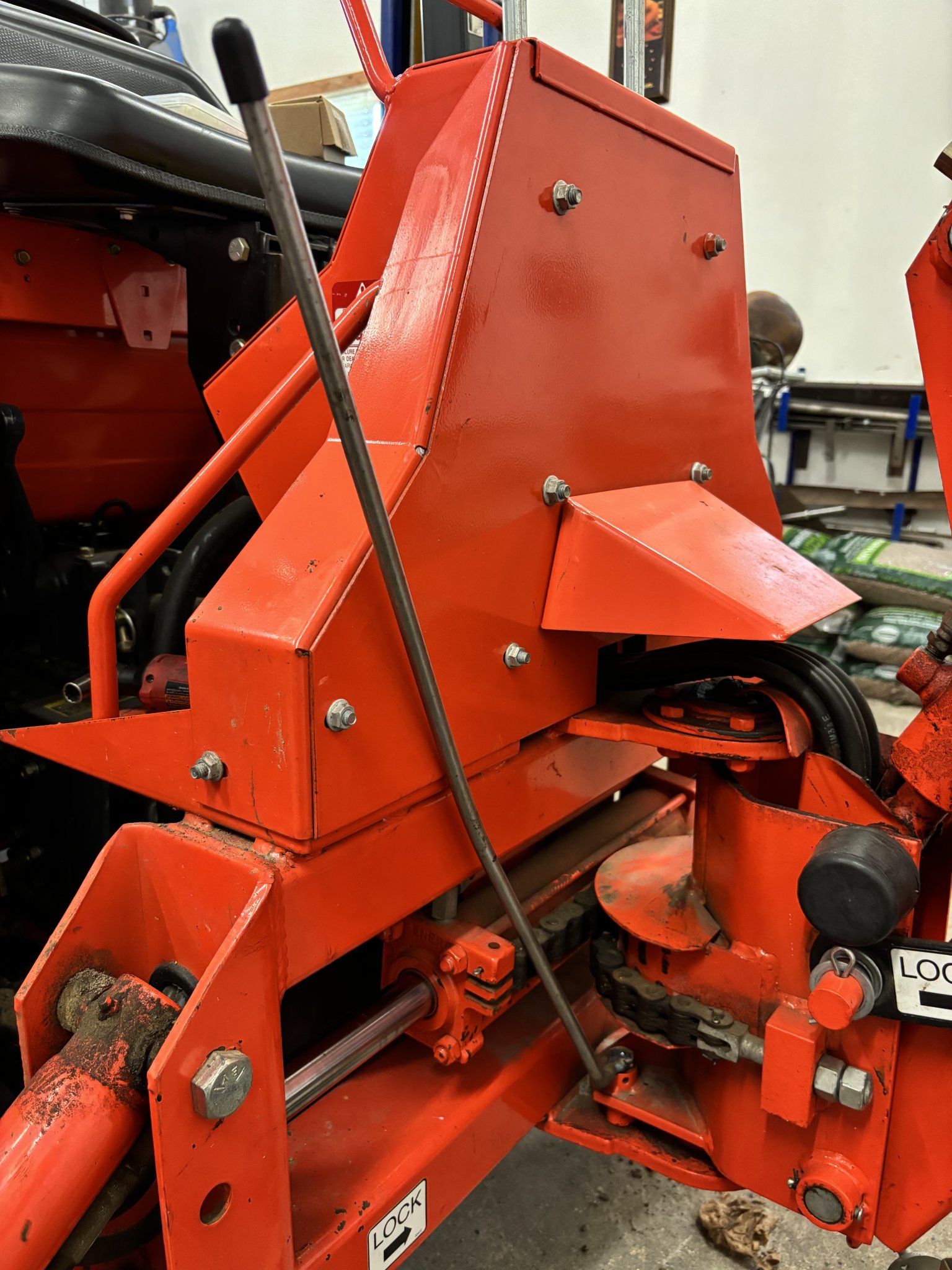

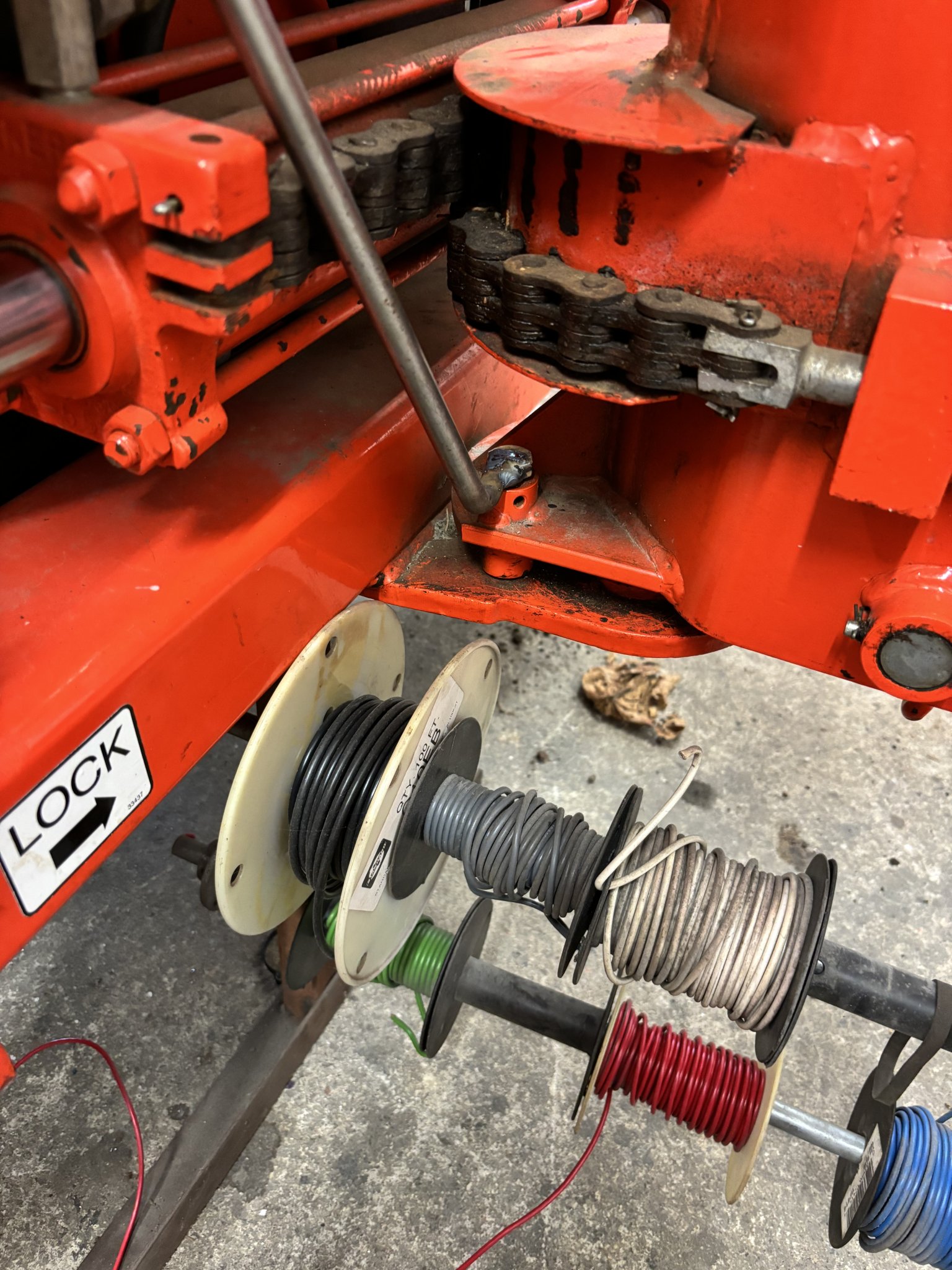

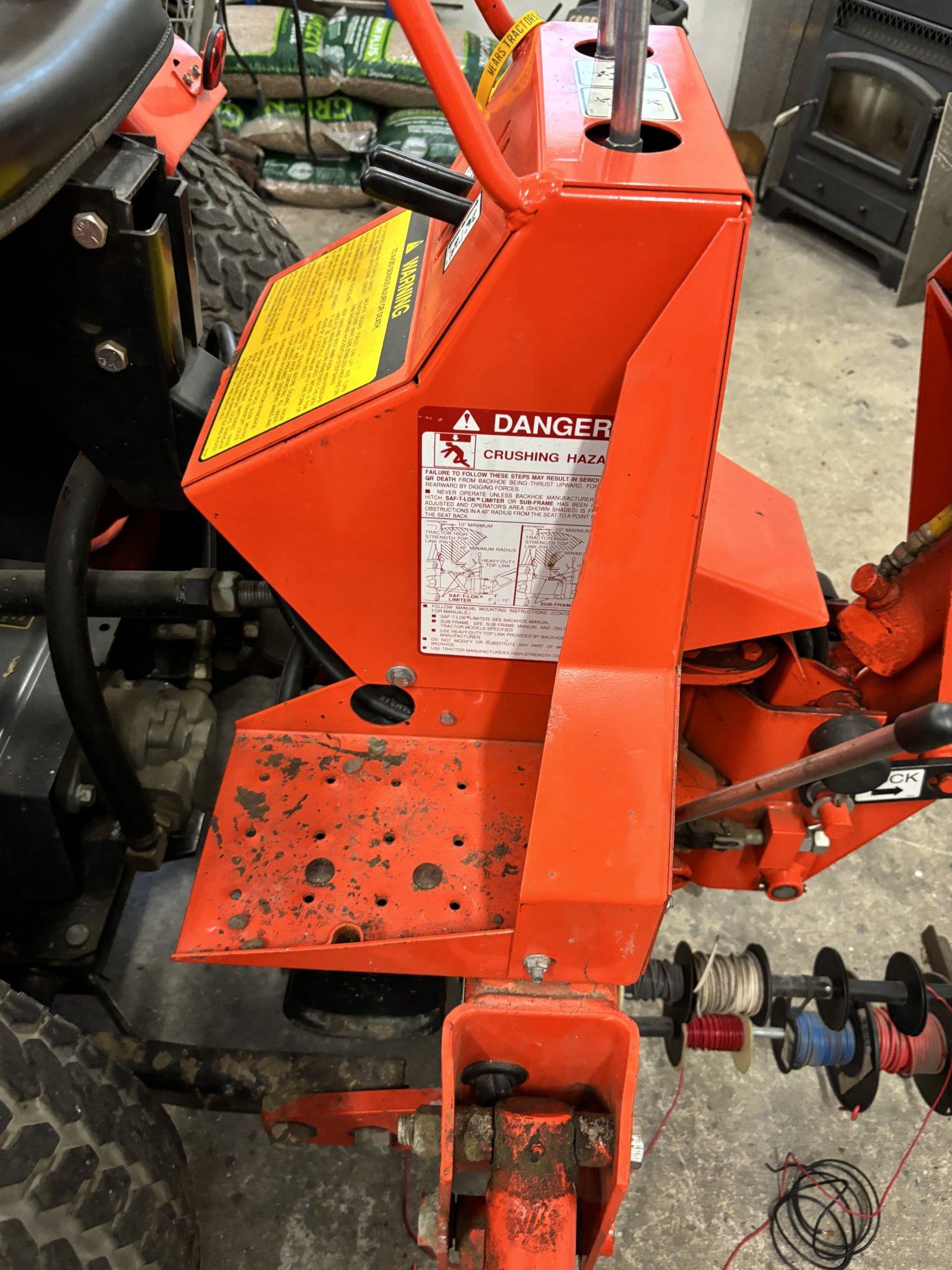

2 small fab jobs to make things a little better for my woods 750 hoe. Big feet so cut off guards that no other hoes have. They were definitely ankle breakers. Now need a small weld on step. Painted were i cut.
Than welded up a pin and bent a handle that i can remove from seat to lock hoe from swing. Now to find a place to weld a bracket on to hold pin when using hoe.
Than welded up a pin and bent a handle that i can remove from seat to lock hoe from swing. Now to find a place to weld a bracket on to hold pin when using hoe. View attachment 134728 View attachment 134730 View attachment 134731 View attachment 134732
When do you find a need to "lock hoe from swinging"?
When I trailer, I set hoe on deck, and chain down.
When driving the tractor, my hoe does not swing, by itself.
It can swing when plowing. It can swing when running down the road. On the trailer by law it has to have securement so i do the same … put bucket on the deck and chain it.
I wouldn’t trust any hoe without both locks engaged in my shop next to my classic cars.or going down the road in traffic. Have seen them swing or drop and hit a vehicle or garage door.
Your choice. It has locks for a reason i didn’t invent them just made a new pin. All the newer machines i have operated have them and i use them at work.
Like emergency brakes. I dont use them but should 🤣. Besides i was bored 🍺👍👍👍
Should mention…… this tractor is 34 years .
They put one on yours so i guess some use it.

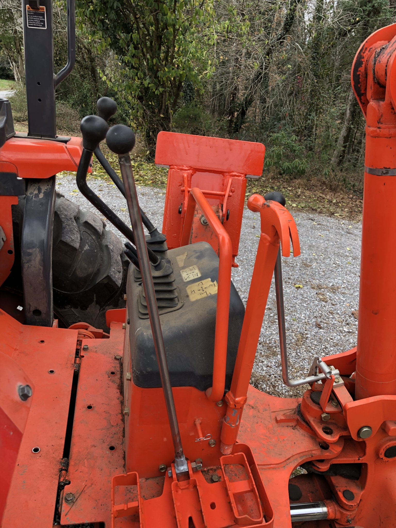

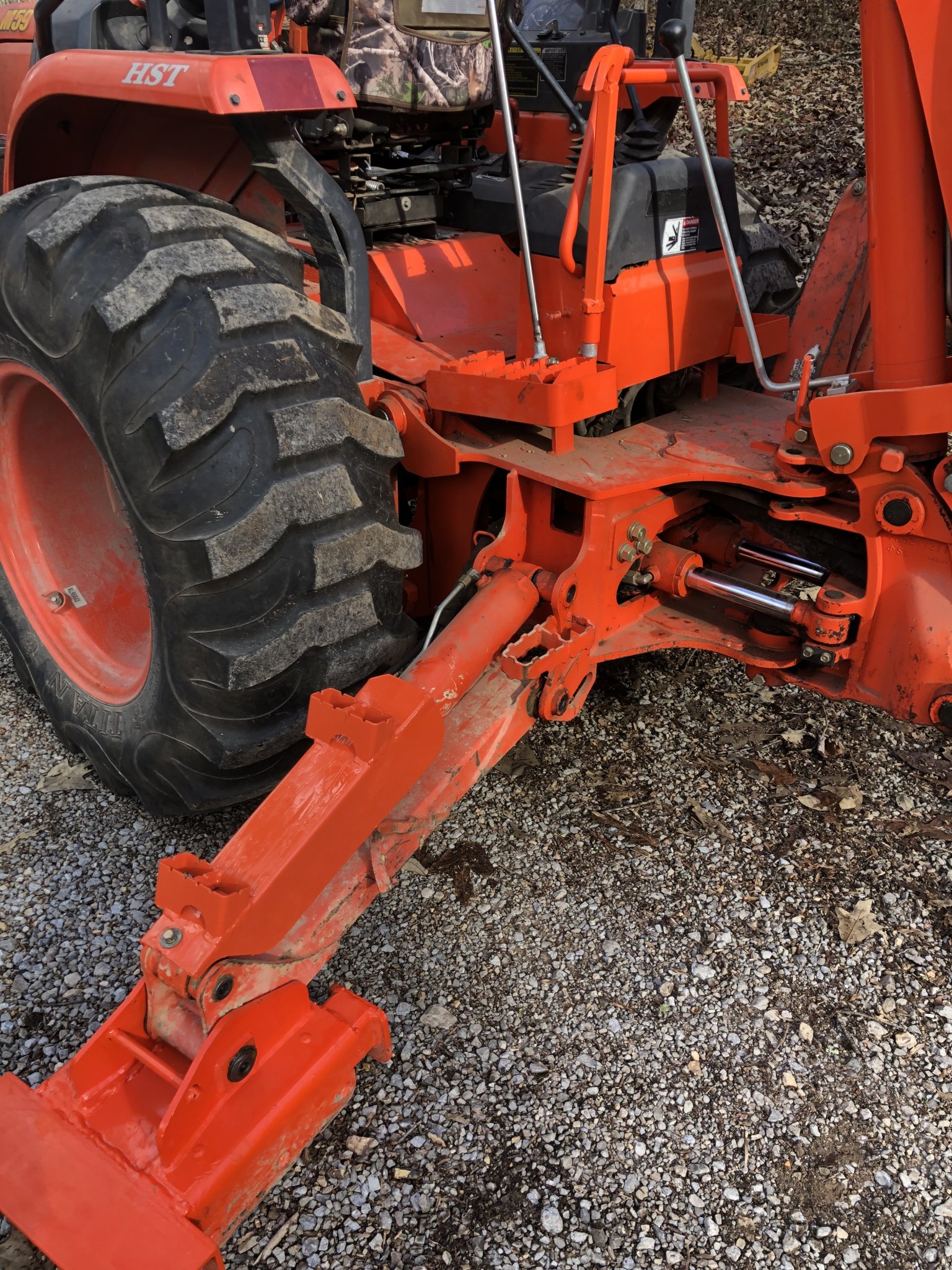

Good job! My Dad had a little Rhino backhoe attachment that the outriggers were fast and made to be feet mashers if not careful. Small backhoes are far more dangerous than the bigger ones.
Often use boom lock and necessary when parked in tractor shed. Side to side only transport. On a hillside farm always having to swing the hoe uphill for balance.

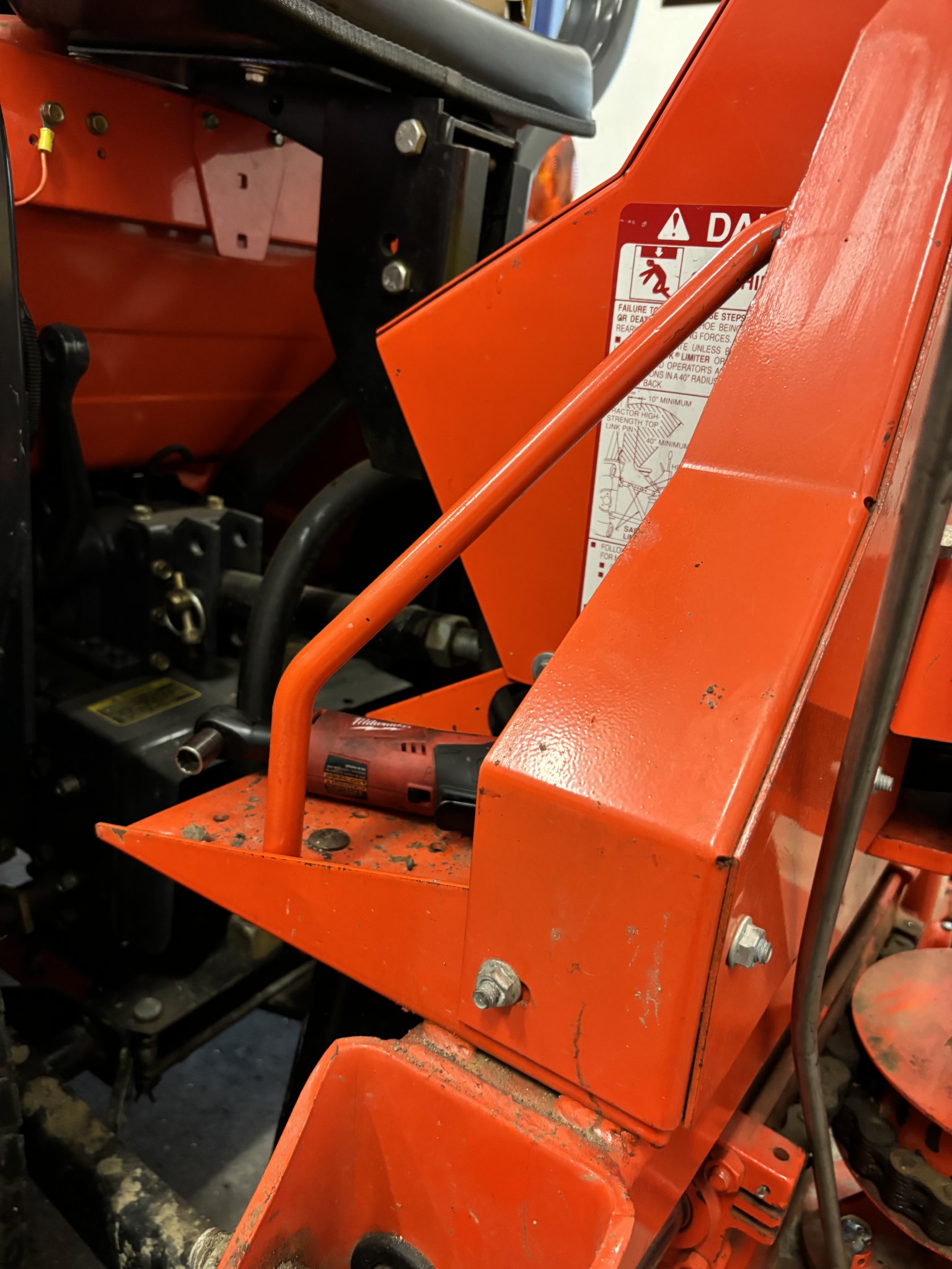

I need old man climbing steps and hand holds.
I’ve made similar. Hammer handled swing pin in storage spot. High traction or toothed steps for muddy shoes.

I do like those steps… nice work.👍👍🍺
