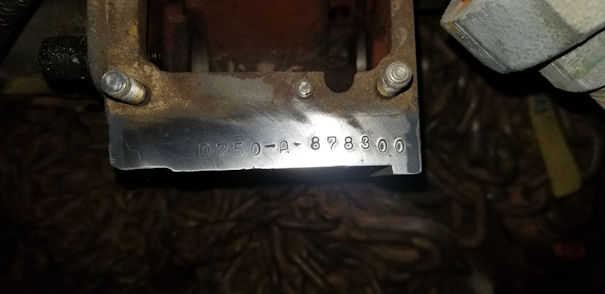

I would really like to know the model and serial number that is stamped into the flat right outside the injection pump facing up.

I'll try and get a picture of the number you showed but won't be until the weekend now as it's dark when I leave for work and dark when I get back.
