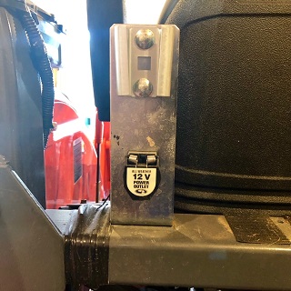

edritchey
2021 Ferris IS800Z - 2025 New Holland WM75
Jul 19, 2014
1,136
851
Wellsville, PA
I just ran it to the bracket for the SMV it was Convenient and An out of the way spot.
