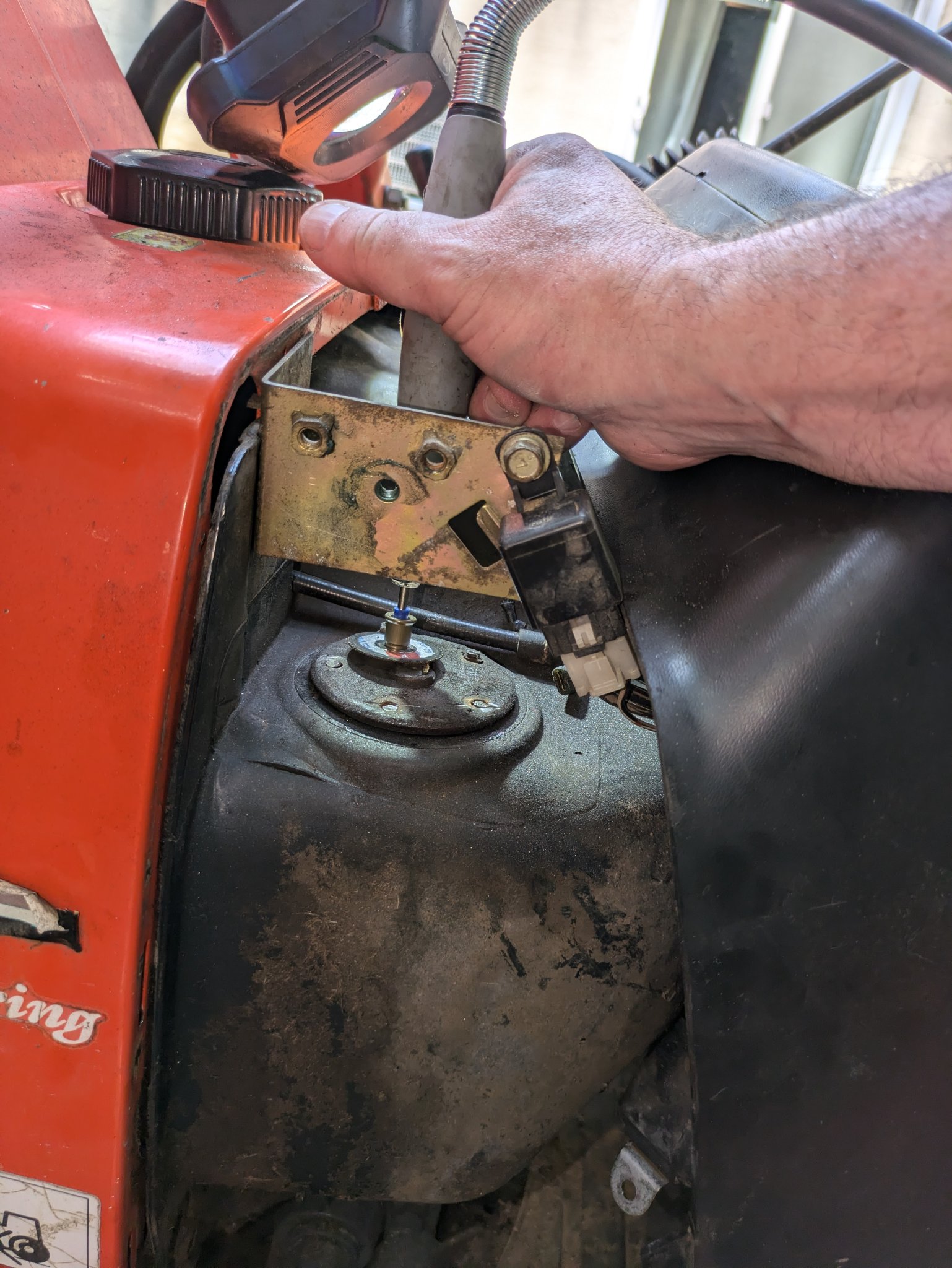

Hello. Fuel gauge stopped working on my tractor a year or so ago and finally decided to replace the sender since it probably rusted off.
Got the dash open enough to see it and started loosening the nuts but the whole bolt is turning. I really did not apply much torque. I was using a quarter inch drive by hand. There was a mouse house on top of it which added some corrosion to the nuts and stuck them on.
Regardless, every single nut was that way. Which seems a little strange.
So, are the heads on the end of the bolts that stick out of the fuel tank captive in plastic in the tank? That is what I am assuming is the case and they are stripped. Does not seem like a great design.

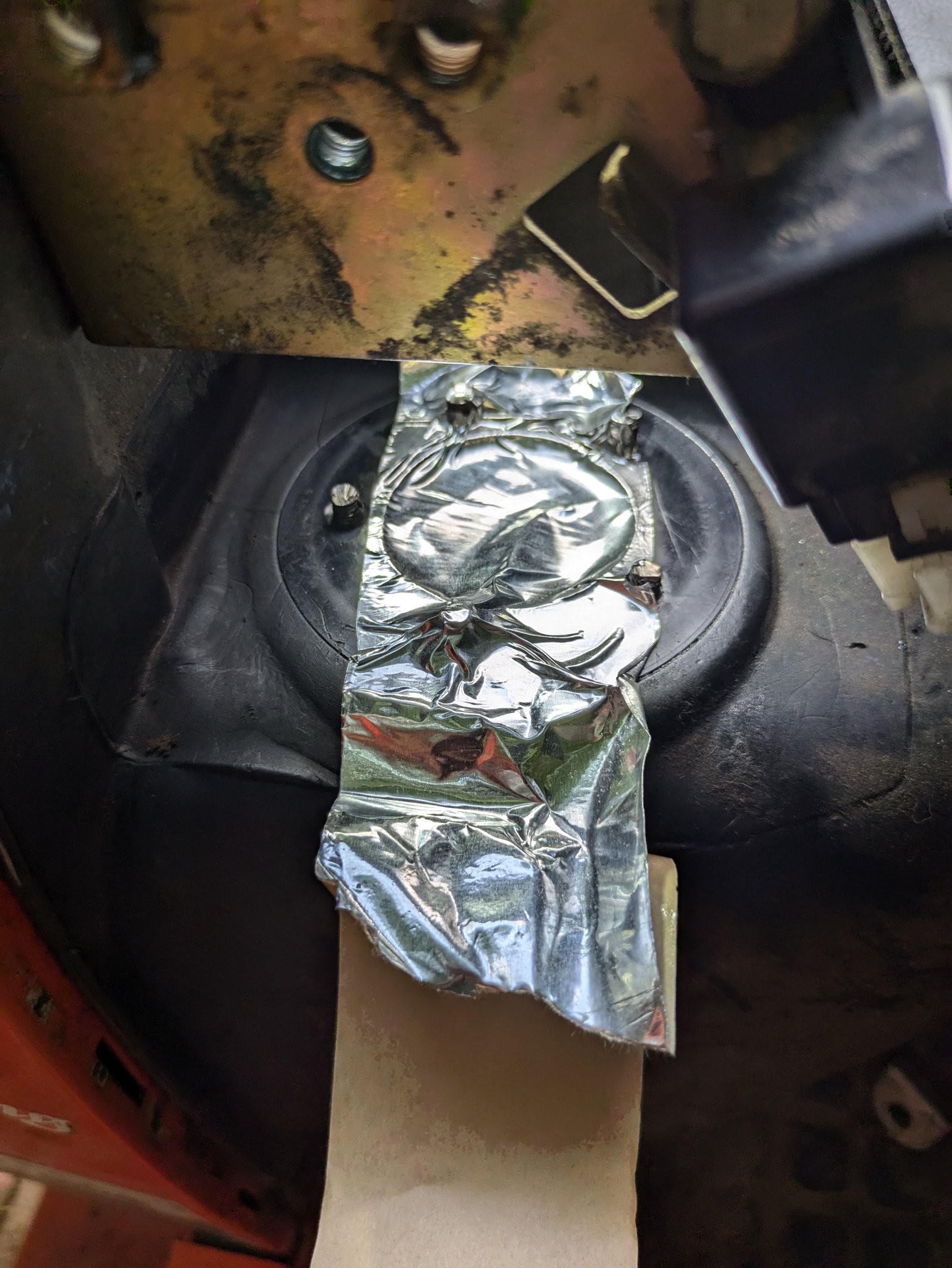

I am pretty sure thats why they invented abrasive cutoff wheels.
Unfortunately a cutoff wheel wouldn't fit. I used the extension on my dremel to cut off the nuts & bolts. Added some permatex, rotated the new sender a bit to clear the old bolts, drilled pilot holes and put in new screws. I think it will do the job. I added some pics in case it ever helps someone else.
