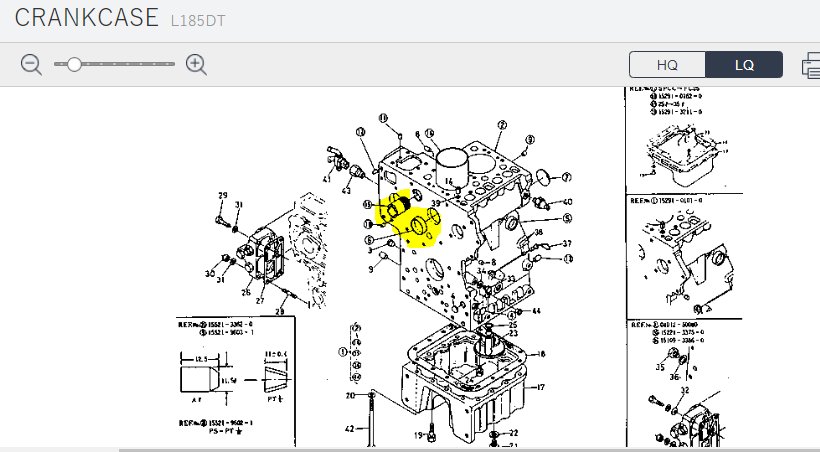

Not sure if this applies…..

Don’t think so. That appears it would leak coolant externally. Having said that, it does not appear to be seated properly.
From Rocky’s thread it appears there might be a similar freeze plug beneath the front engine cover (???)
28,860
5,215
Front of engine under gear case.

Update
Came away very easily to reveal the problem.
Just one bit of advice, take the governor off first as there are 2 small springs in there that need to be unhooked before removing the front.
