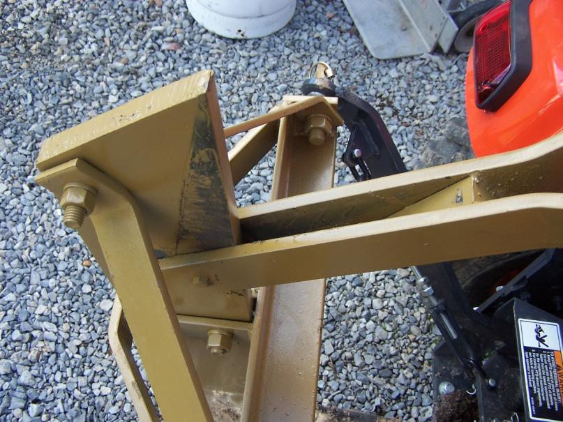

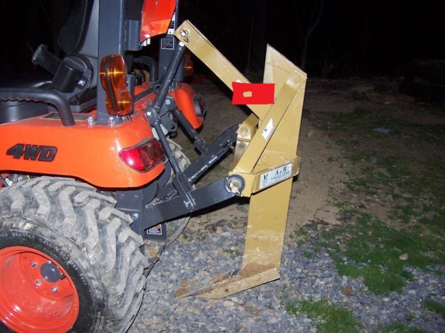

I had ordered a sub soiler in with the deal when buying the BX2370 and it came in today. Holy moly! I think it's for a much larger tractor, but I had to try it. my first try it went down about 10" and pulled out roots like a hot knife through butter! But it doesn't go deeper due to the wrong angles. I'm not sure if I drill a different hole in the center part that goes up and left in the picture, so it pivots down lower, and/or drill the top of the same part to lower the center 3 point hitch thing (you can tell me the right name of that), so that part goes lower. Or, that center point of the hitch, can I get a much shorter one of them?
This thing is heavy! The center main part of it I believe is 1" thick steel! Although it's too big (I think), I'd like to make it work. Even if I have to install a more narrow cutting blade in order to pull it when it's deeper, I'd do that. I'm just really impressed with how it tore through roots, it's almost doing what I got it for.

I would probably fabricate a shorter top link arms for the subsoiler or cut the ones on it down. That way you can have some room to adjust the top link on the tractor.

Good idea, probably easier to make a new link than modify the original. Can you tell by the picture, is it indeed way too big for this tractor? Two guys got it into my girlfriends trunk and it wasn't easy getting it out by myself without hurting the car. I had no idea how big and heavy it was or I wouldn't have asked her to pick it up on her way home. (it's about a 110 mile round trip for me and she works close by)

Does yours have a shear bolt in the top link bracket? From the picture you linked it looks like maybe there's supposed to be something that holds that bracket more vertical. The way it's setup is definitely not right. I would modify the top link bracket to look something like this:

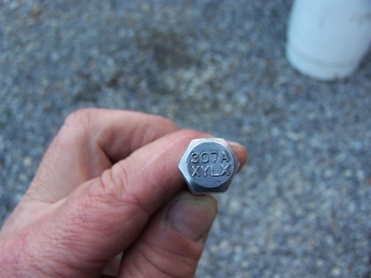

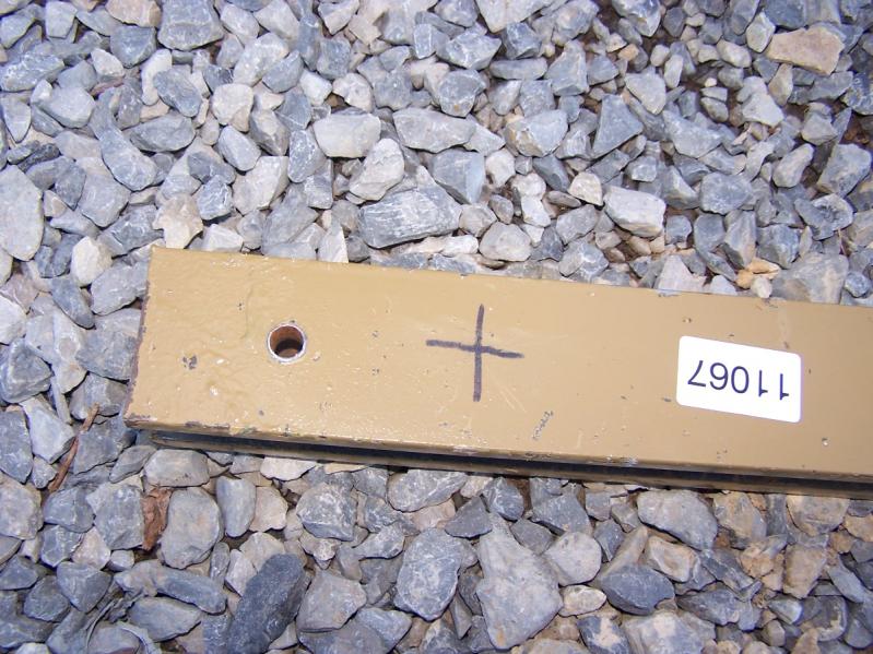

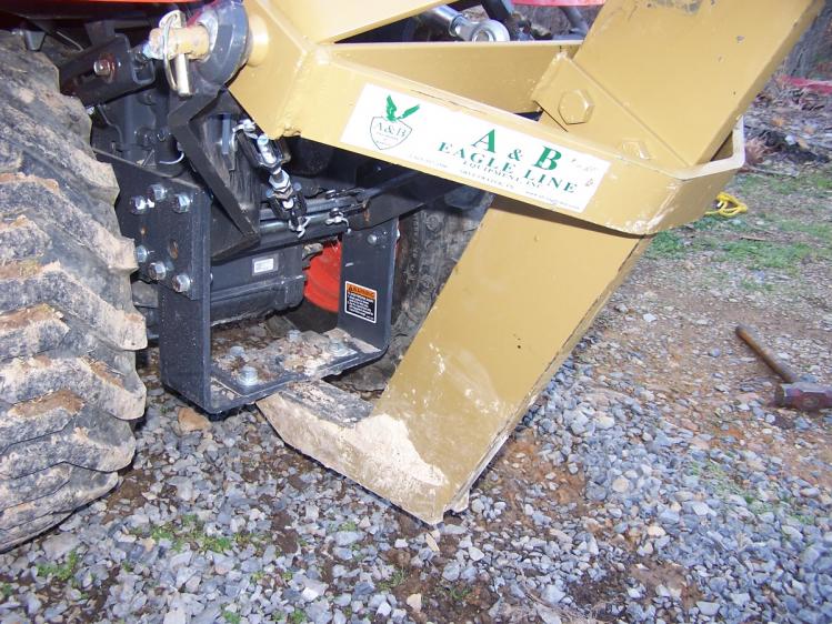

Yes it has a shear bolt you can see in this first picture, it also pivots on that bolt. I moved things around and plan to drill two new holes for the shear bolt approximately as on the pic. Question, note the picture with it swung back AND up all the way how it is hitting the ground. Also how it sits if I get it swung forward. Does that look like any problems? If so I think I will try to trade this for a smaller one and some cash, because raising it upward will take a few large holes through the 1" thick shank. I don't want to ruin it, so I'll try just those holes as marked (1 3/8" hole in each side of the 1/2" thick part in the picture.
The picture of the bolt head is the shear pin, do those numbers tell you anything? Like a certain grade of bolt?
The brand again is A&B Eagle, in a previous post is a link to this sub soiler.

I moved the bar that connects to the center link downward about 2 3/4" and my estimate is that it went 16" down. Would one made for a subcompact go that deep? It didn't seem to strain the tractor much at all. If it doesn't rain I may try it tomorrow and measure.
The only thing that is difficult with it is getting it from under the tractor to a position that it will catch and grab, and even that wasn't too bad this try.
I got it for two things. One, to pull out SMALL tree stumps and cut roots, and two, to loosen the soil if I need to dig with the bucket since I don't have a backhoe. I'm not sure if I'll do any more tweaking or not. I may possibly add a handle to allow me to swing it out from under the tractor to where the tip grabs, while I'm up on the tractor.

I've called all around and can't find anything made for my tractor size. About the only option is something from Tractor Supply but from what I've read they use to have a good one but it's now lighter duty and they bend too easy. I think my best option is to make this one work. If I really want to get into it, I can move the main shank up a few inches, but that requires drilling some large holes through the 1" thick shank. I still have a corded drill around here somewhere.

Seems like there should be the pivot bolt and an additional shear bolt to hold that top bracket in place. Overall just seems like an unnecessarily complicated design. The subsoilers I've seen just have a standard 3 pt implement frame.
I wonder if that top bracket is supposed to replace the tractor's top link. That wouldn't seem right since different tractors required different lengths and there's no adjustment, but hooking two pivoting links together like that just doesn't seem like it would work.

I called the manufacture asking about the center link and he said you still use your center link. Then he said it's too big for a sub compact. I told him that I got it to work but not quite right and he was very interested. Told him that I thought of re drilling the holes and moving the main shank up and he said that will work well. Or he said to cut off the bottom and the shank and re weld it on a little higher. In fact he was such a nice guy, he said they could do it there while I waited! Sounds interesting but it's a couple hour ride and in the at least 4 hours driving there and back, plus waiting, I can do it myself and save some time and a lot of gas. Not sure how many drill bits I'll go through?! :D
It's not like I can return it, I've used it and drilled part of it already.
So I'd really appreciate if a few of you with smaller ones (that doesn't sound right does it?) could give me the measurement of the length of the shank below the two lower hitch pins. From the center between the two pins down to the bottom tip. I'm thinking if I shorten it about 4" it will be perfect, but eagerly await your measurements.
