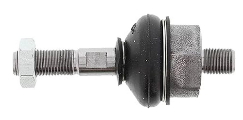

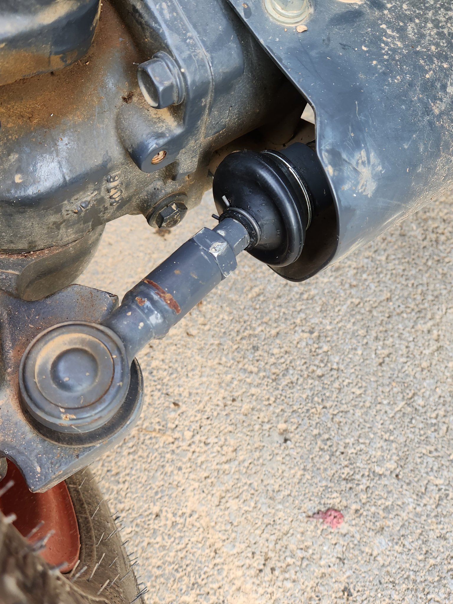

Anyone replace just the boots on the tie rods? They look like generic boots, I'm just unsure of the size and haven't had a chance to measure mine yet. The joints on mine are perfectly fine and still tight, the boots are just ripped. Example picture of what I have on my BX2200.

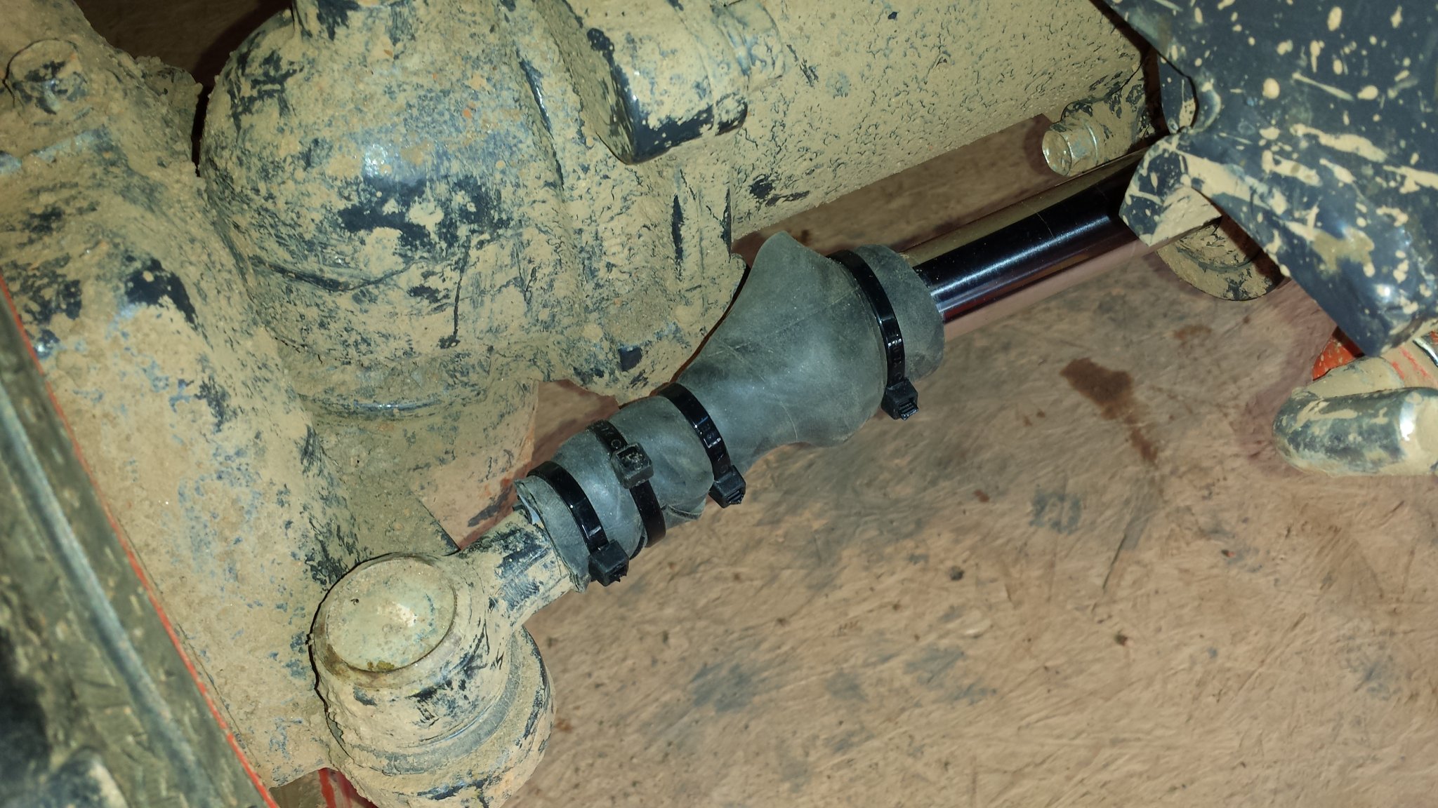

I wrapped mine with old inner-tube and secured it with safety-wire wrapped around the ends holding it closed, leaving the exit of the rubber-wrap facing down so as to not catch junk and water. Been great for 5 years now. Cost: Zip ( old inner tube, remember?)

You mean something like this? :LOL:
This looks mo' better!!!
5,946
3,198
Whatever does the job best for the money. The inner tube protects more and lasts longer, IMO, but if you‘ve got $15 for a little piece of rubber that will get torn off again soon…
(and, oh yeah…. One Size inner tube fits All) :ROFLMAO:
